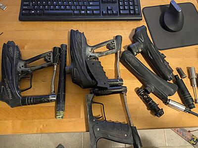

    After extensive cleaning and cherry-picking the best parts, I have at least one decent shooter. I have enough parts for potentially one other gun and another body assembly I might try to attach to a wooden rifle stock I have lying around.

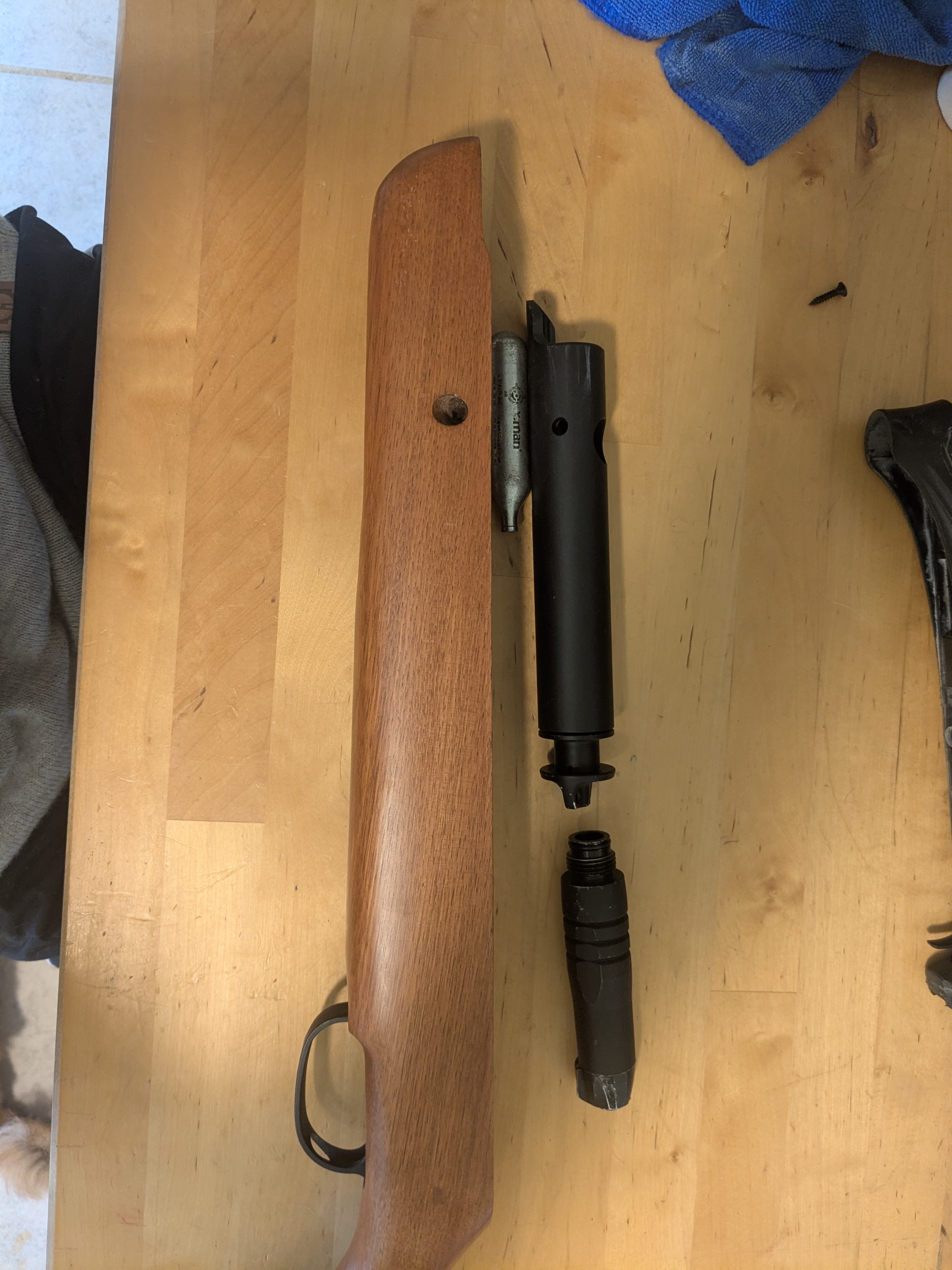

          The second enmey is together and functioning (sans feedback) and now I want to put the leftover parts to try to make this rifle work.

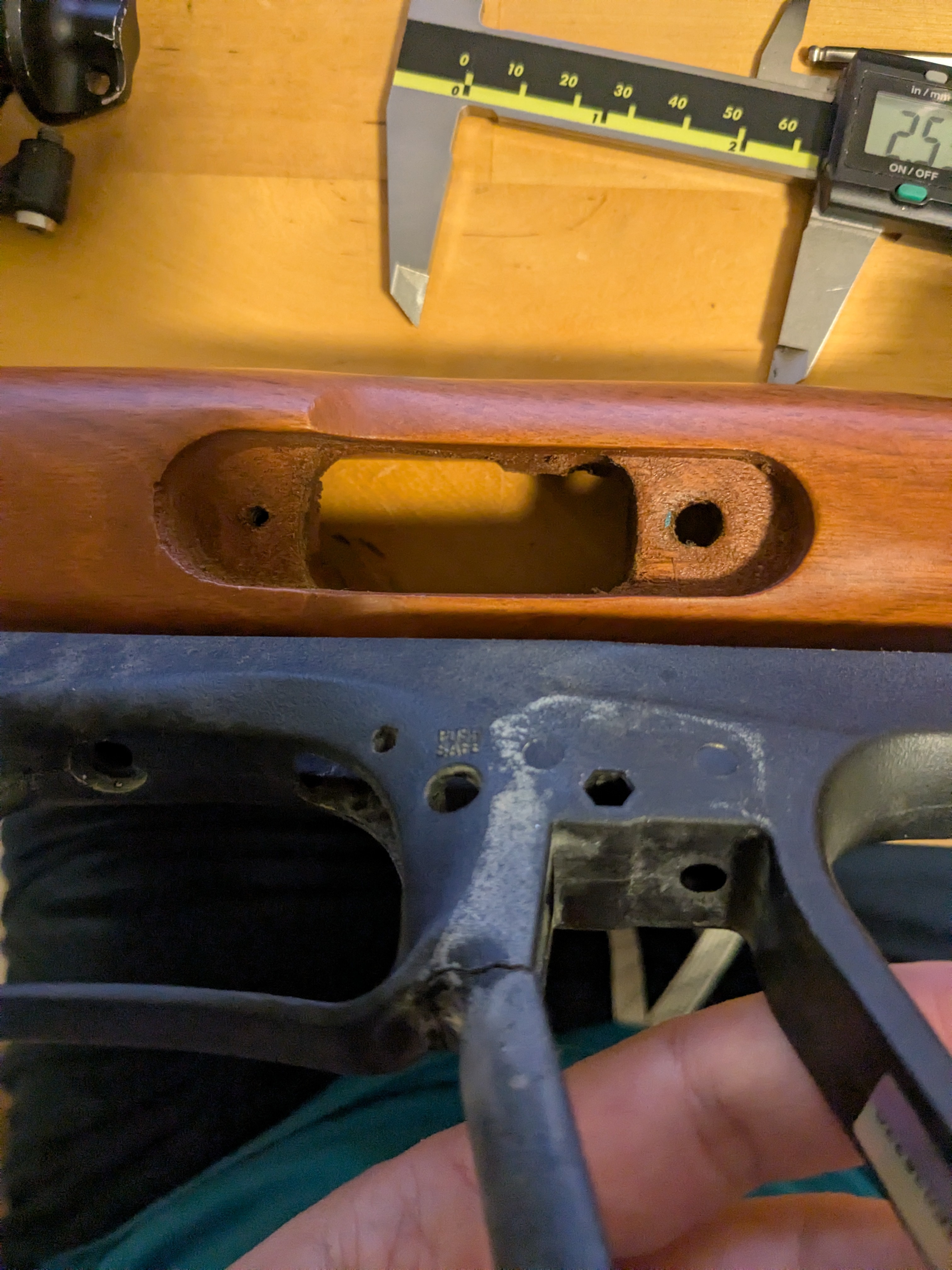

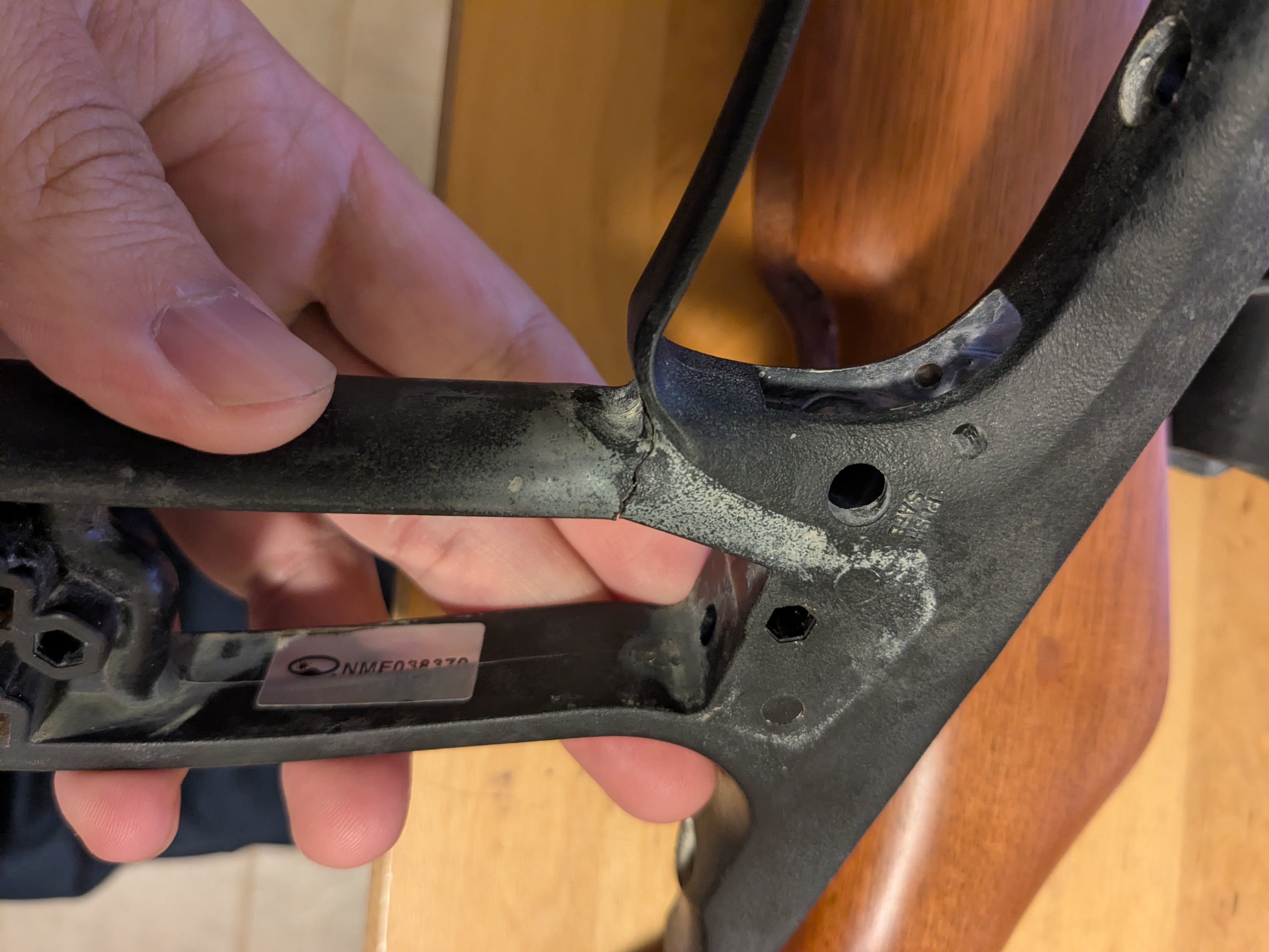

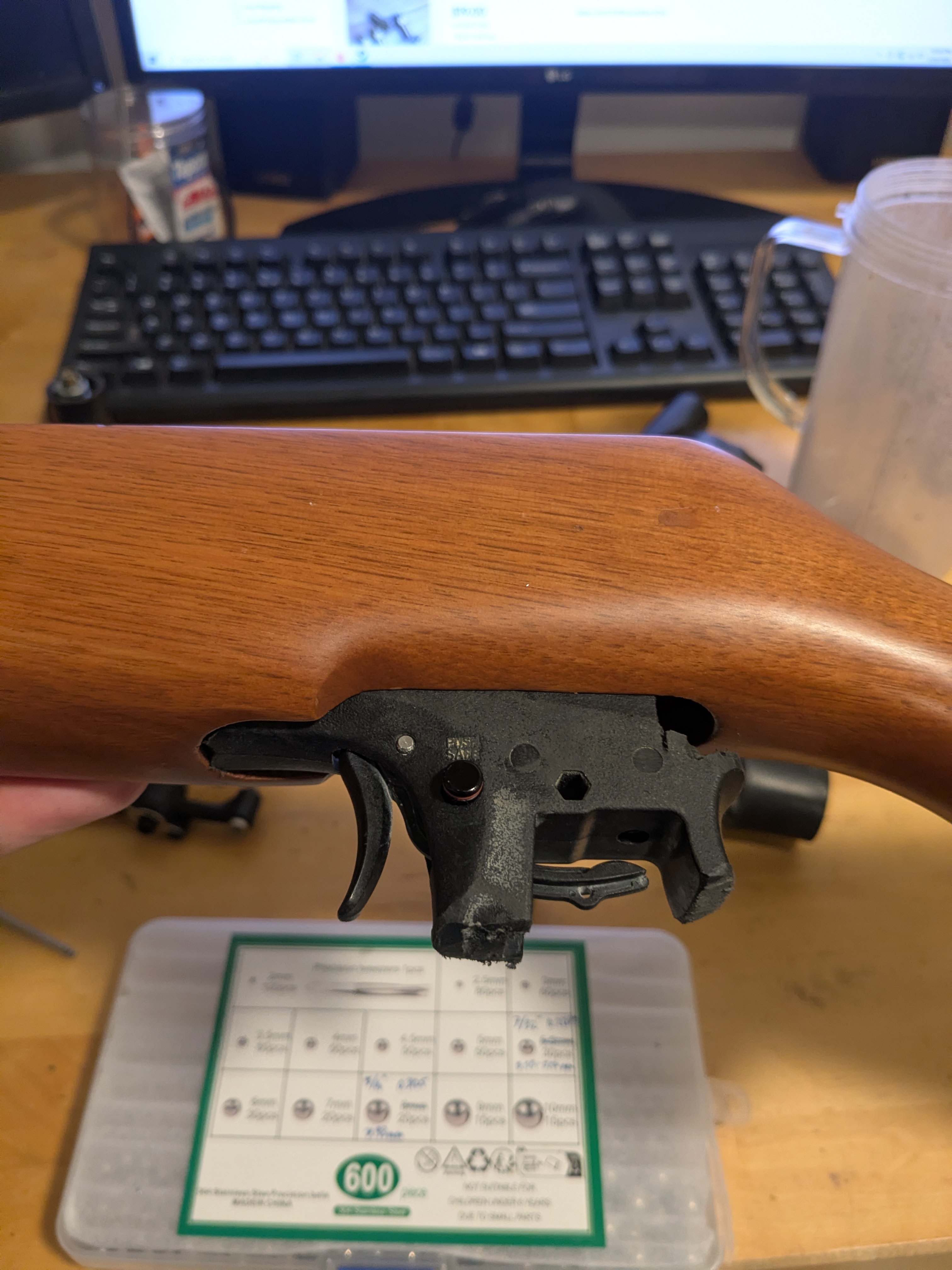

          Step one was hacking apart this frame get the trigger assembly to fit in the rifle stock's original mount.
          Which does technically fit but places the trigger too far forward to use comfortably. I wanted to line up the original trigger rocket with an existing hole I'm the wooden stock to make it simpler to retrofit a valve, but I'm not happy with the ergos.

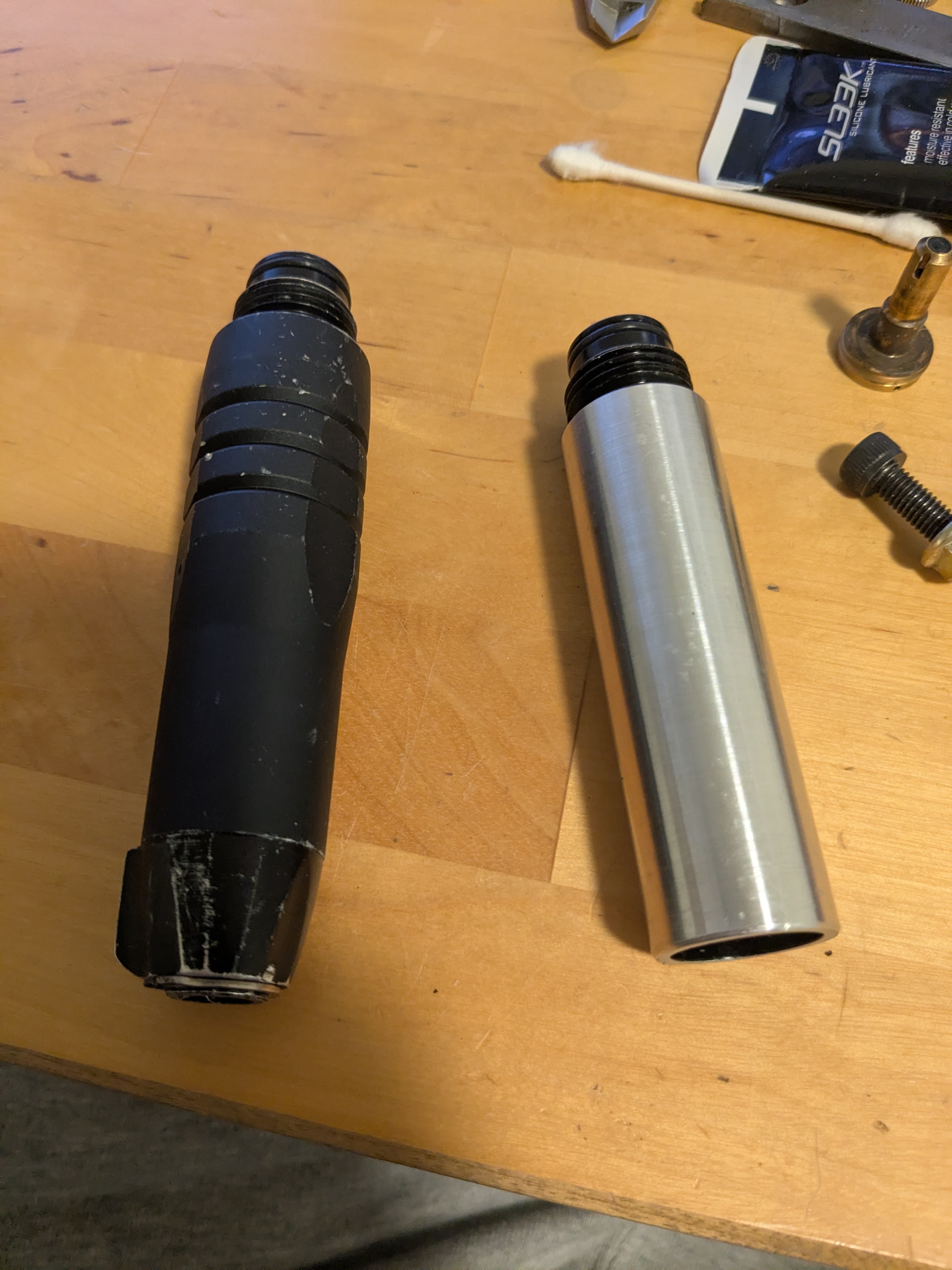

            Minor work today: turning down the OD of a reg for weight but mostly making it easier to fit in small spaces. Having a straight, uniform diameter is also helpful.

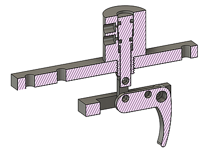

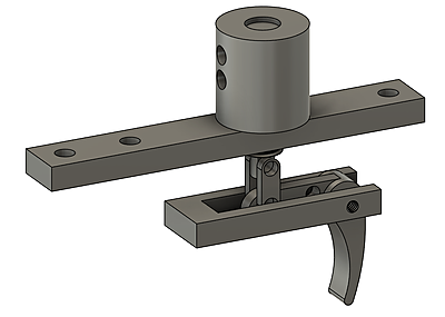

              Today's update: I got around to CAD-ing up the valve and trigger. I'm just realizing I forgot it now, but those ports would be threaded 10-32 to accept hose barb fittings.

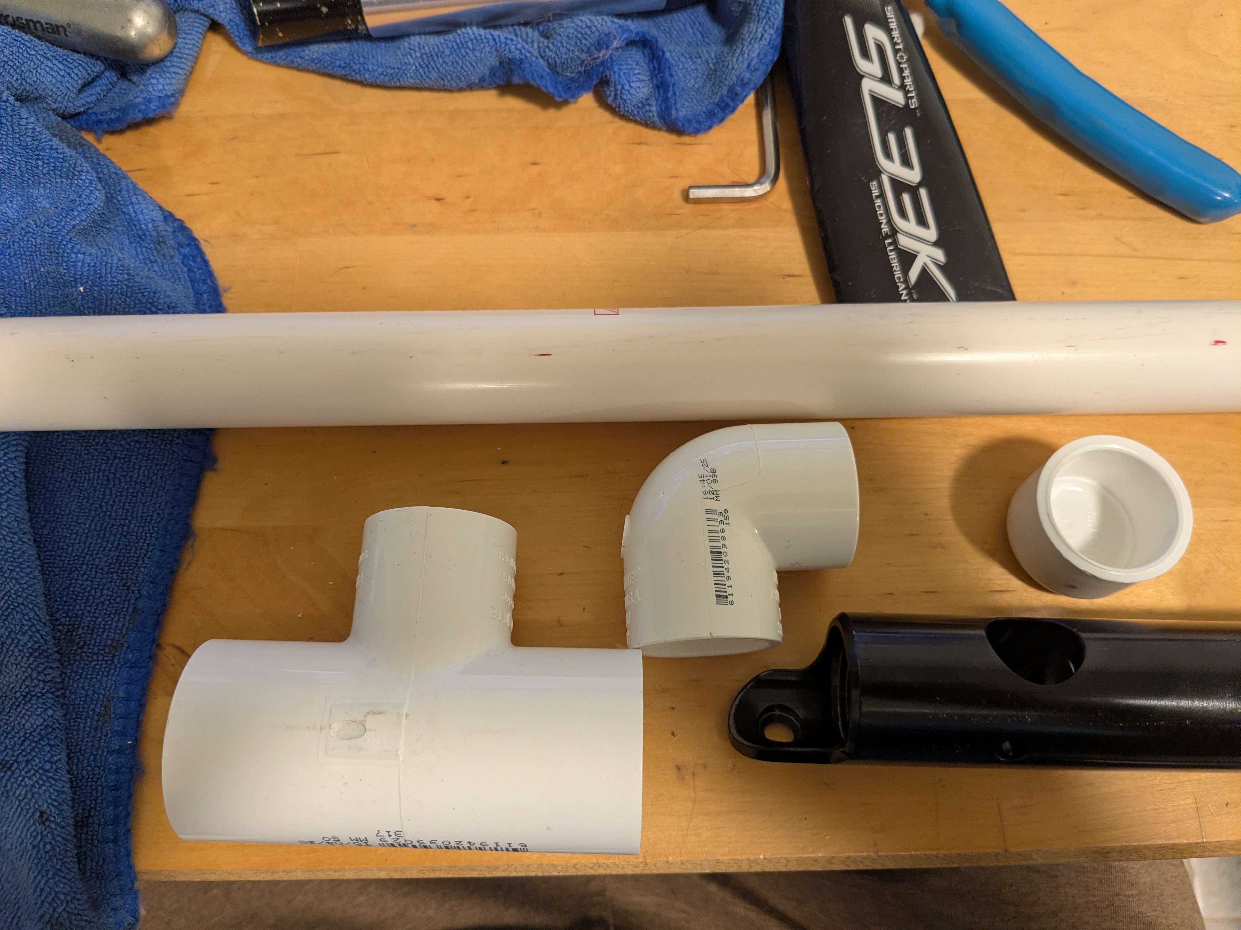

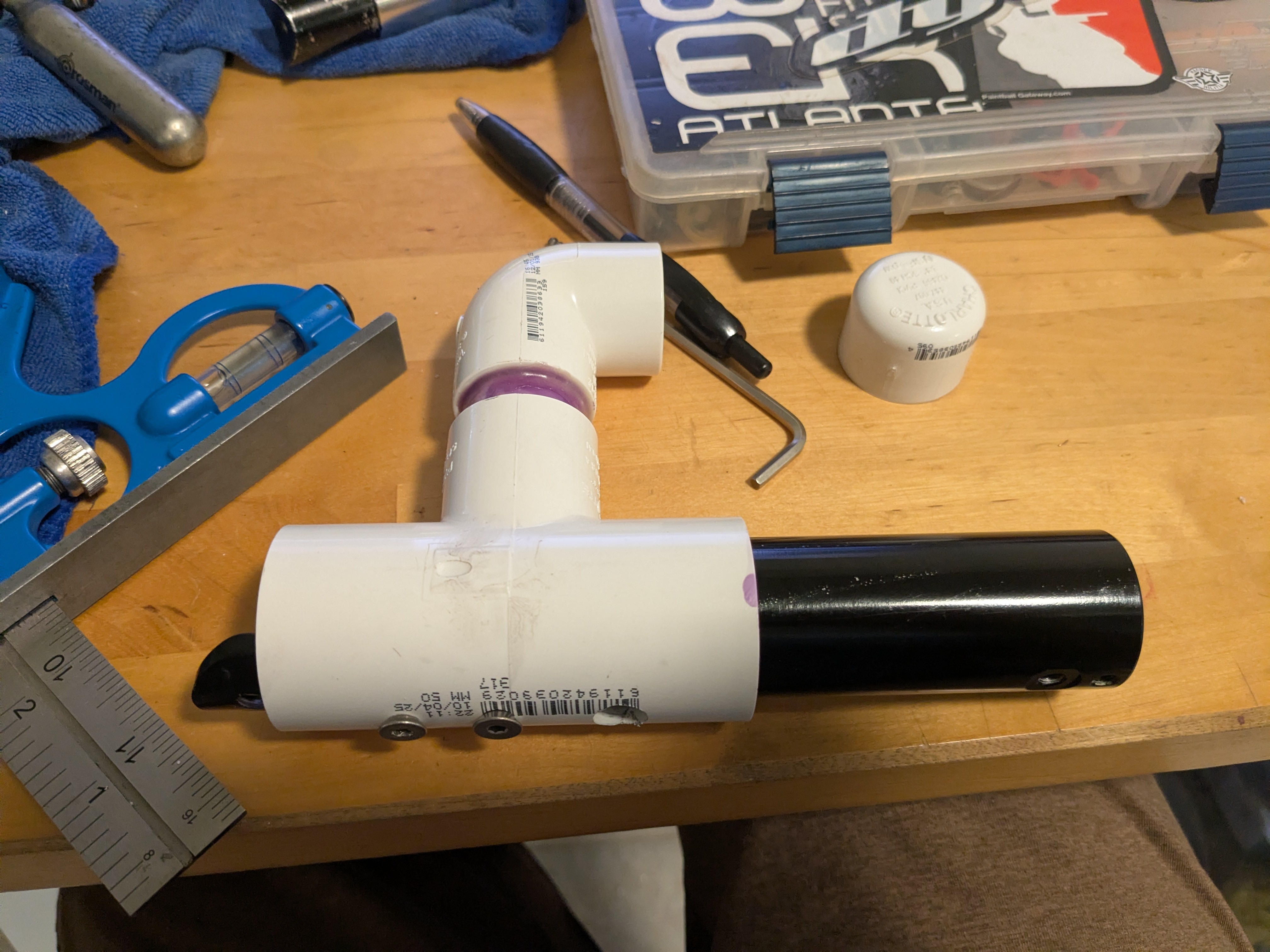

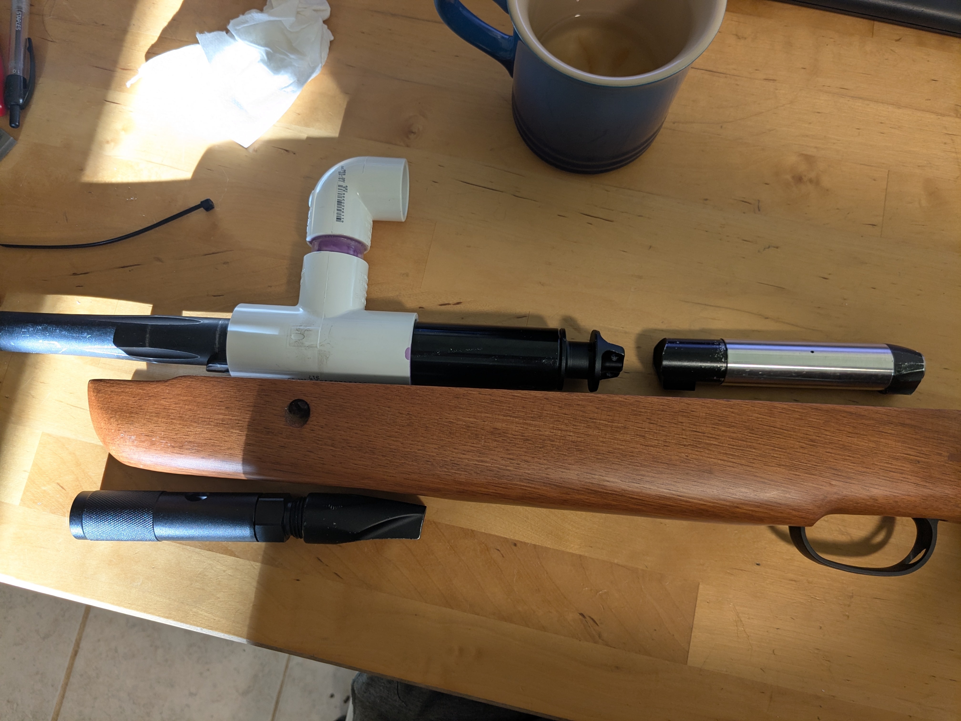

                Yesterday's update: adding a PVC body/stick feed. Cost $7.71 from Home Depot.

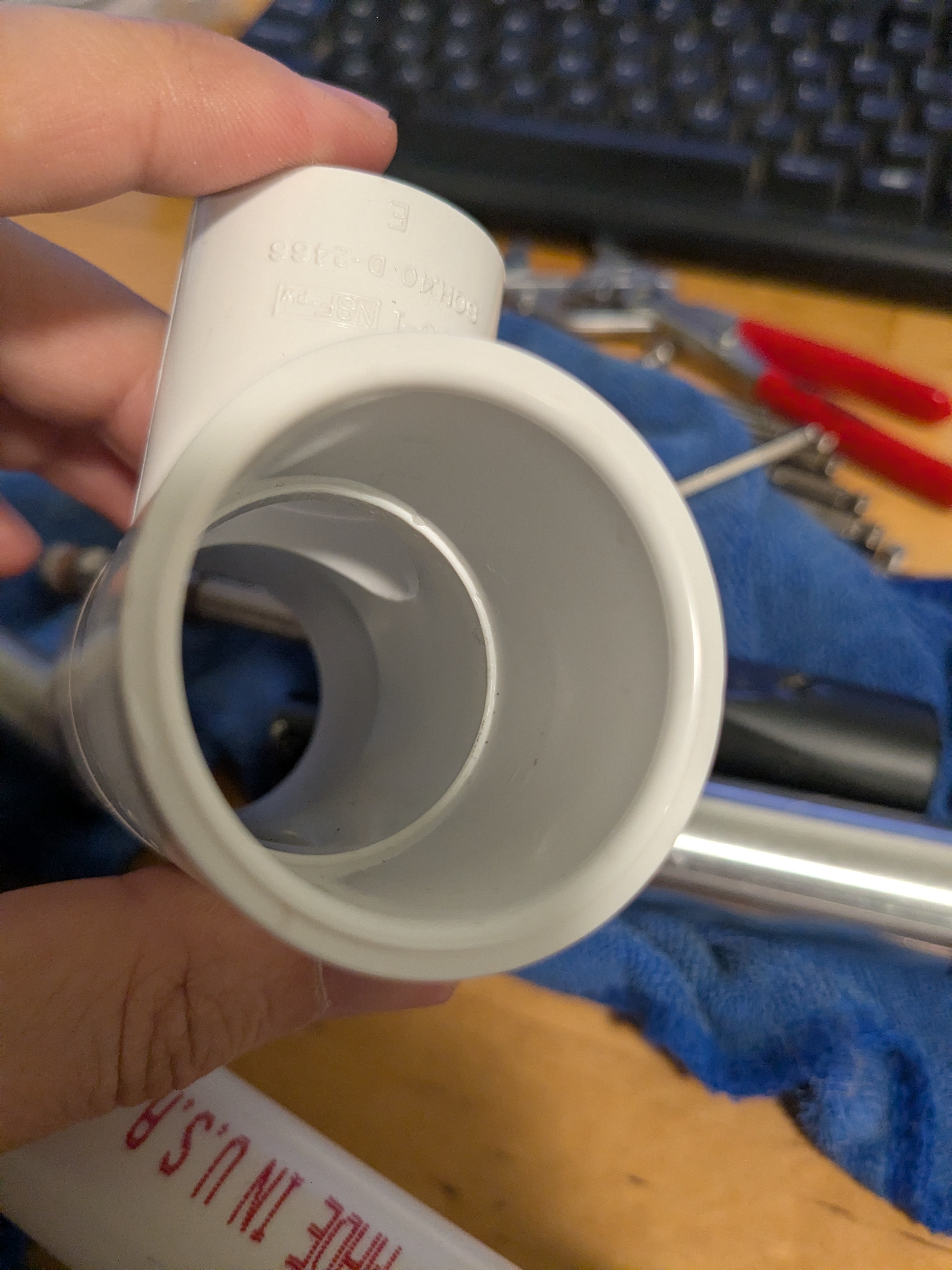

                The trick here is using a Schedule 40 1" x3/4" tee fitting. The ID of the 1" pipe is too large for the Enmey body but the tee fitting has a small step inside that can be bored out to a close fit over ther 1.25" body.
                Holes drilled to accept two mounting screws and clearance for a hose barb.

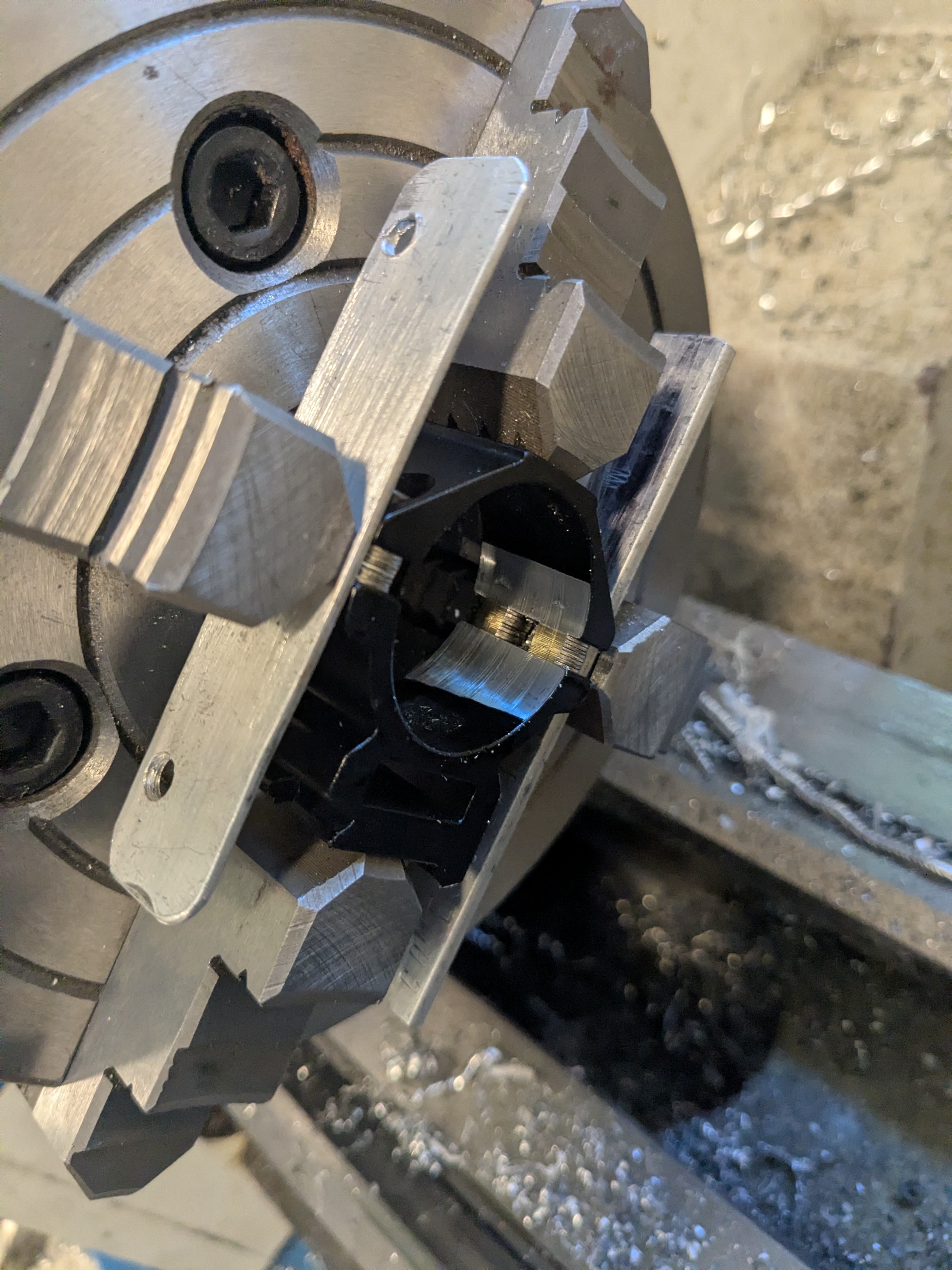

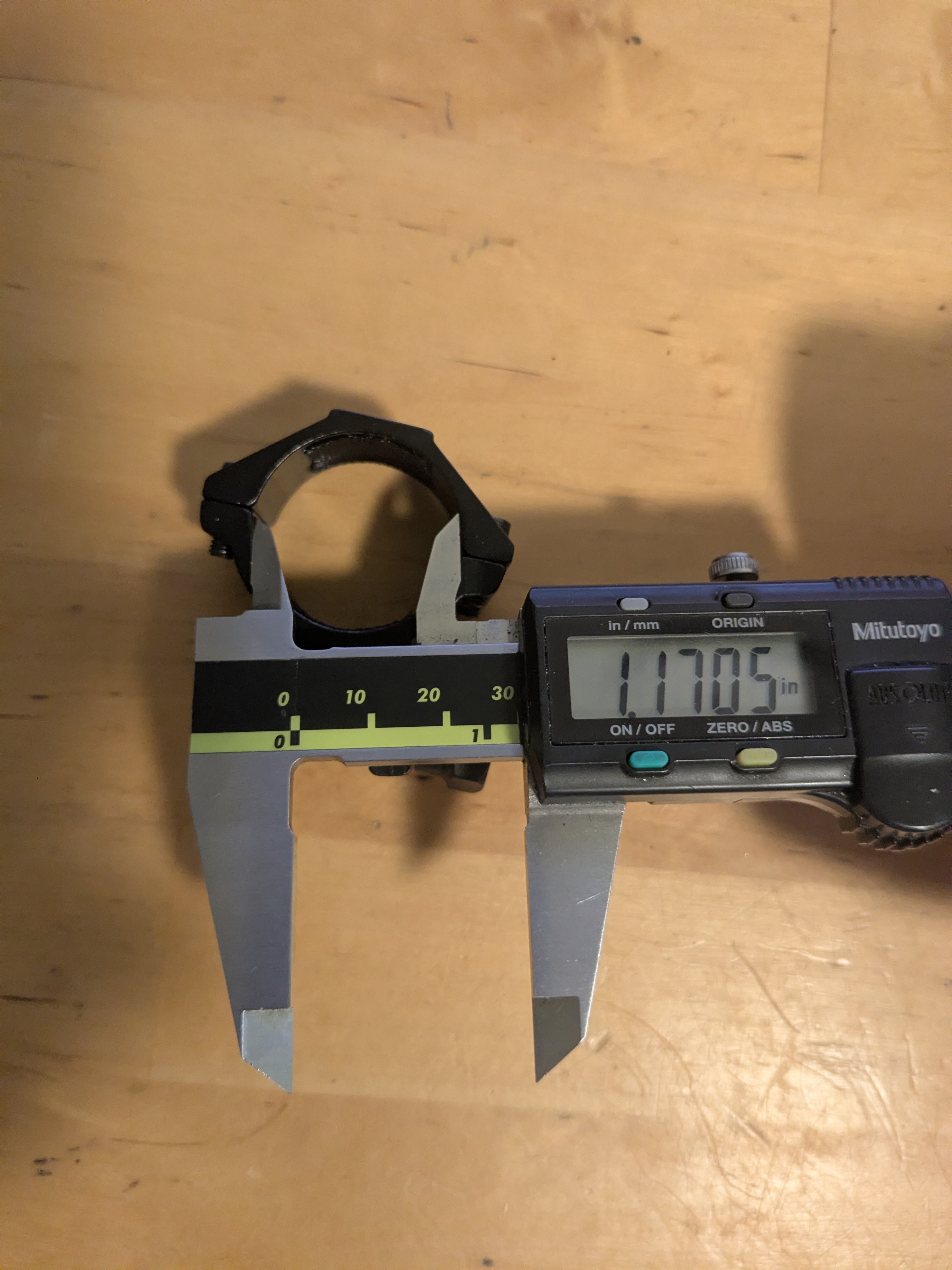

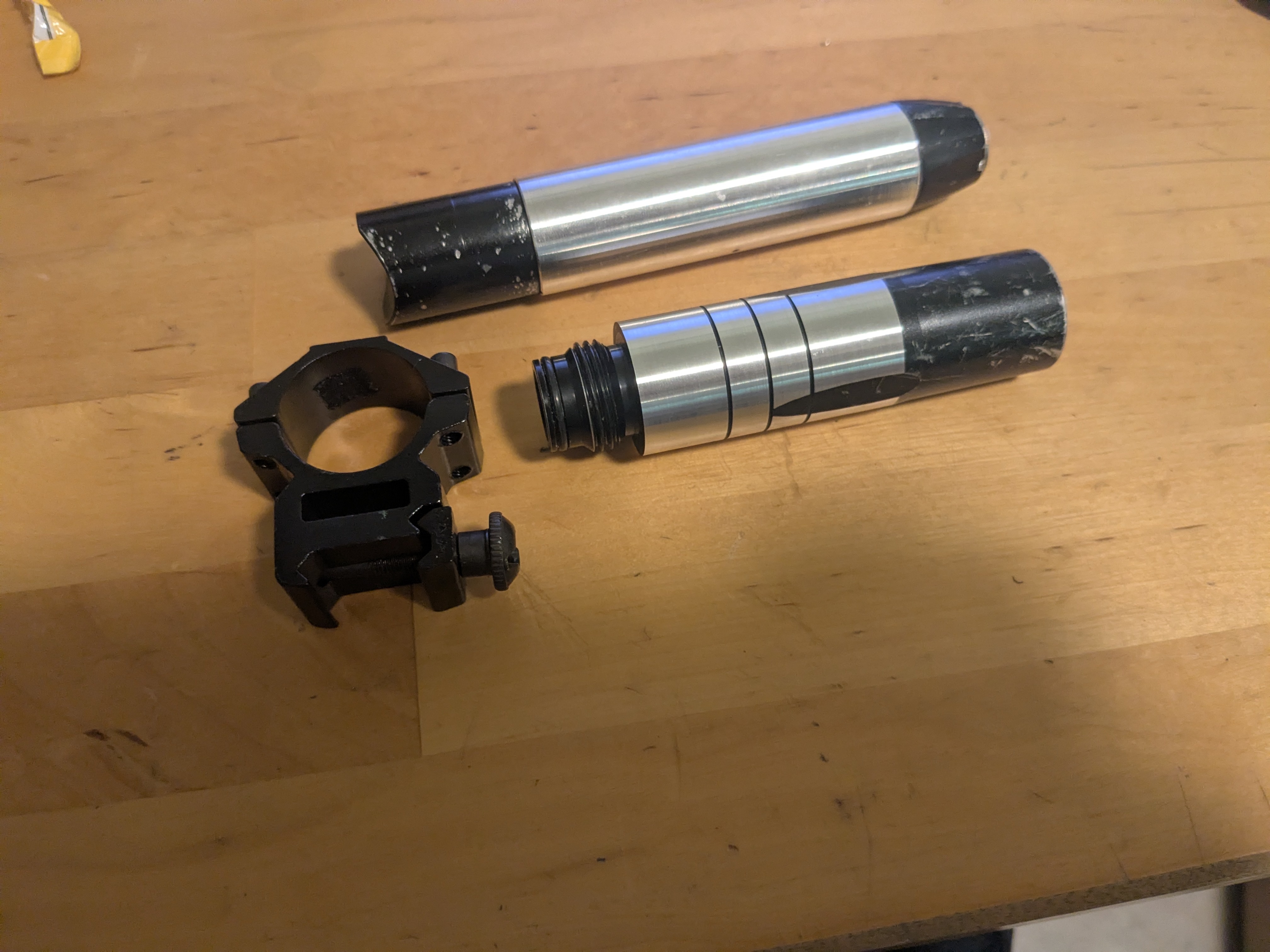

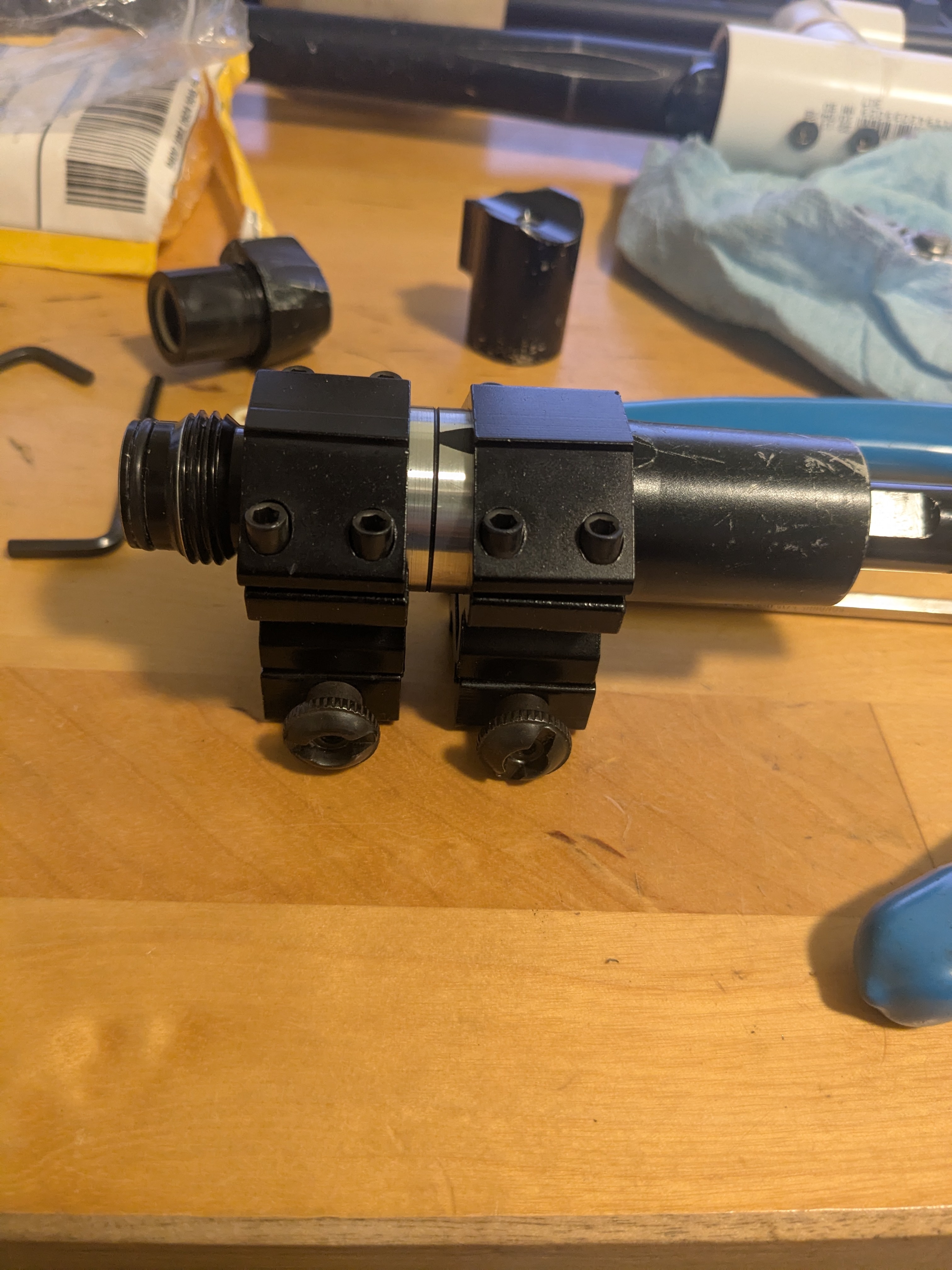

                      I made a little progress today. I got these scope mounts in the mail and while the 1" is to size, the 1.15" one is actually 30mm (1.17") and doesn't quite fit the body. So I bored that out.

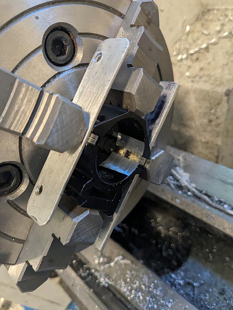

                      I also found out that the reg body I turned down ended up too small to clamp well in the 1" scope mount. Luckily, I still have one extra, so I turned that one down to a nominal 1" OD.
ID:	826426 Click image for larger version
                      Now that I have these parts in mounts, I'm second-guessing the final mounting solution. I originally intended to drill holes through the bottom halves of the mounts, screw them onto the wooden stock, then clamp the cylindrical parts into the mounts, but this leaves them sticking up quite high. TBD if I come up with any better ideas.
