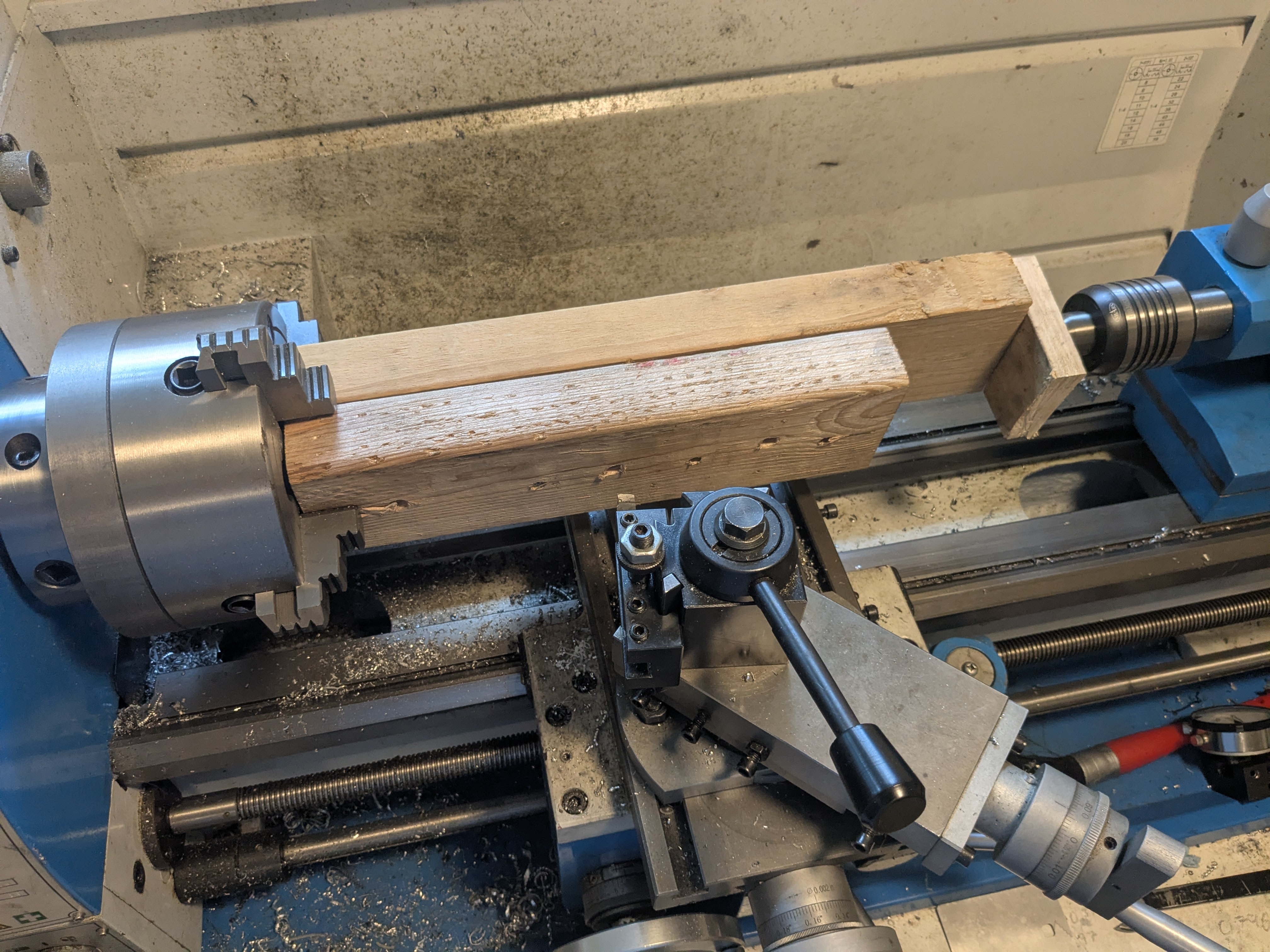

    Today's update:

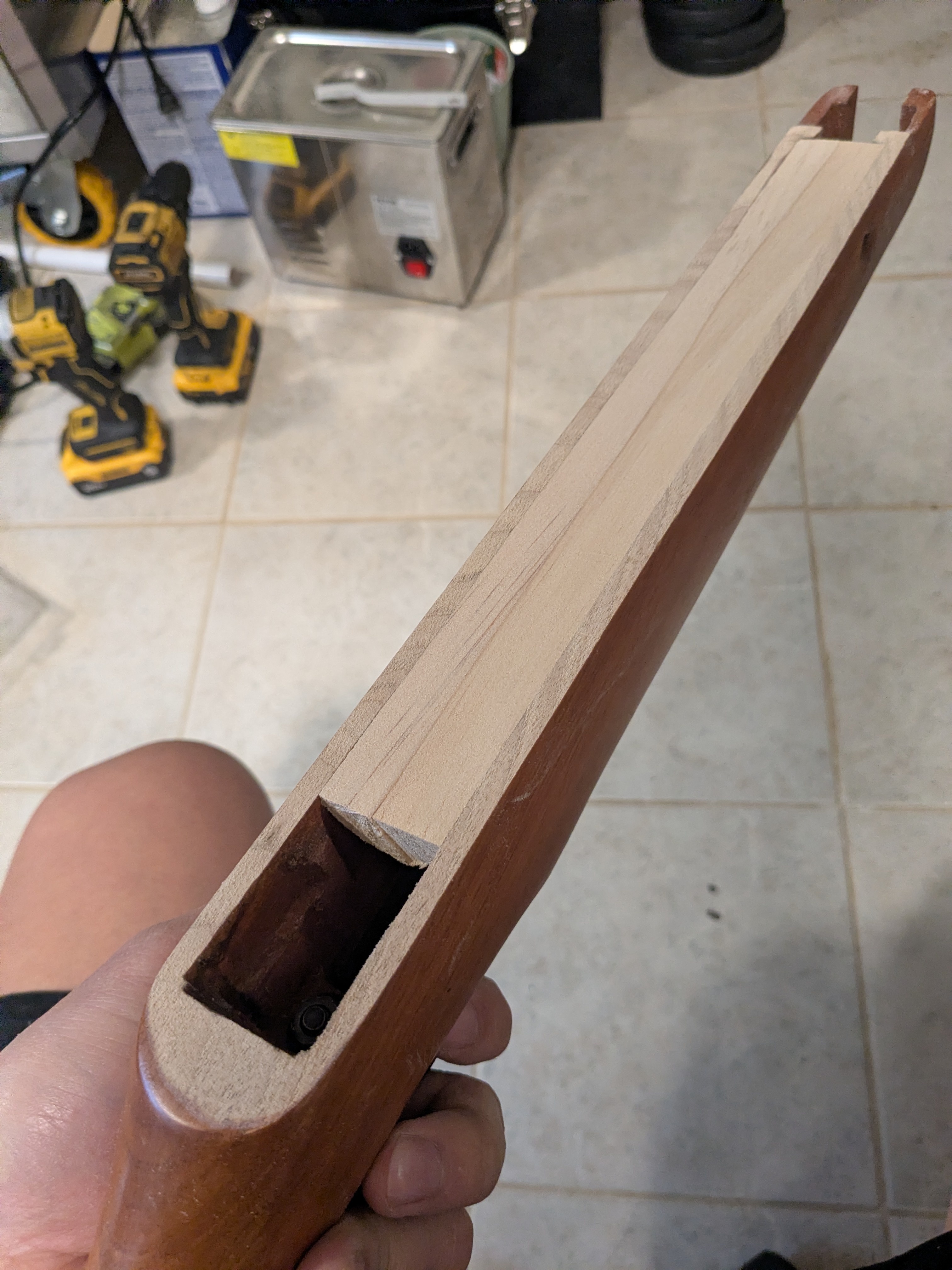

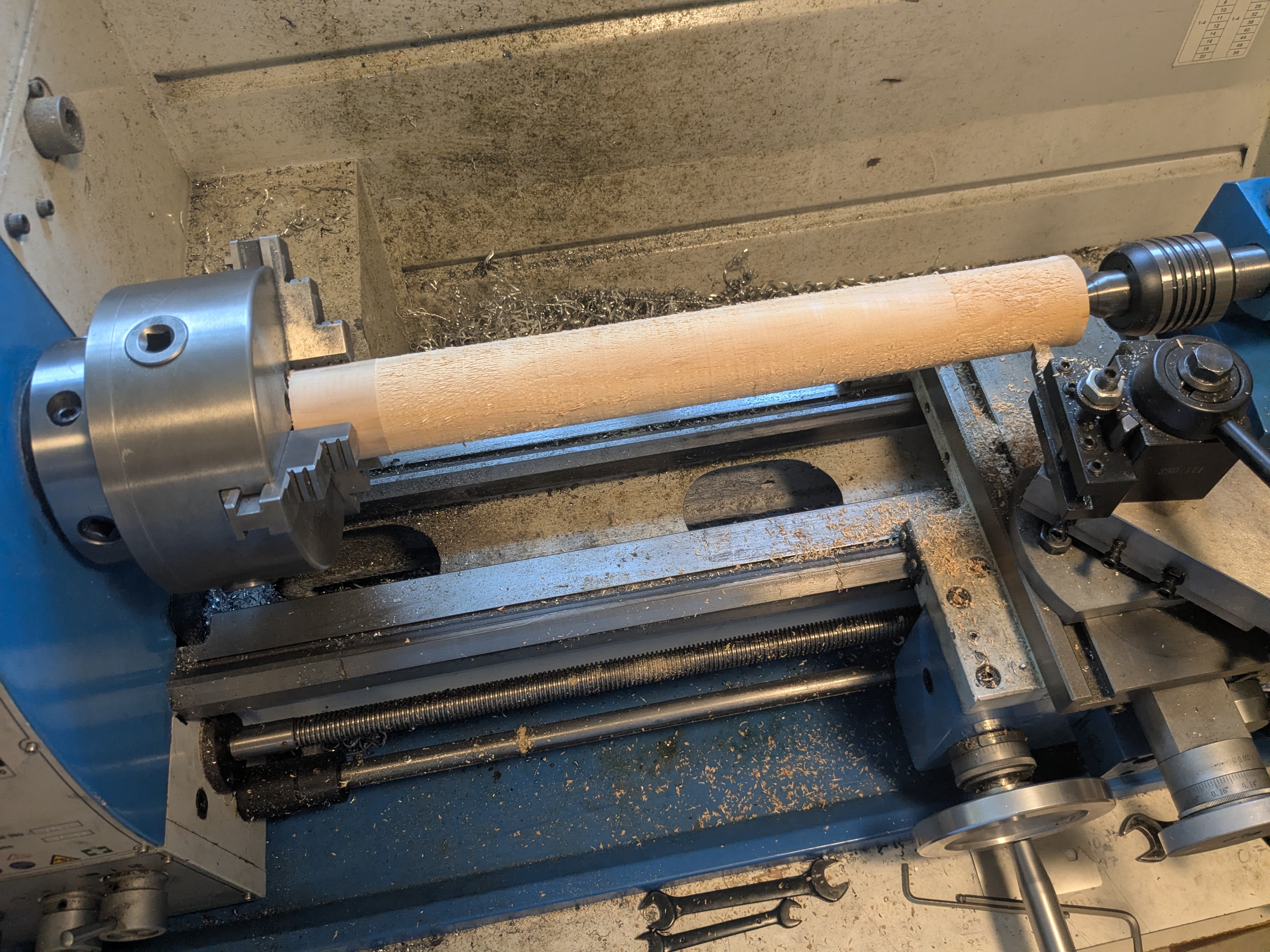

    My first attempt to make this wooden semi-circle started with a couple 2x4s screwed together and chucked in the lathe. This was both sketchy and looked like it was gonna take longer to cut than starting off with round stock.
    So I switched to round stock that was way oversize and cut it way down.
    And then cut to length and wood-glued it in place.
    Next step would be cutting the top flat to have a mounting surface for the scope mounts.

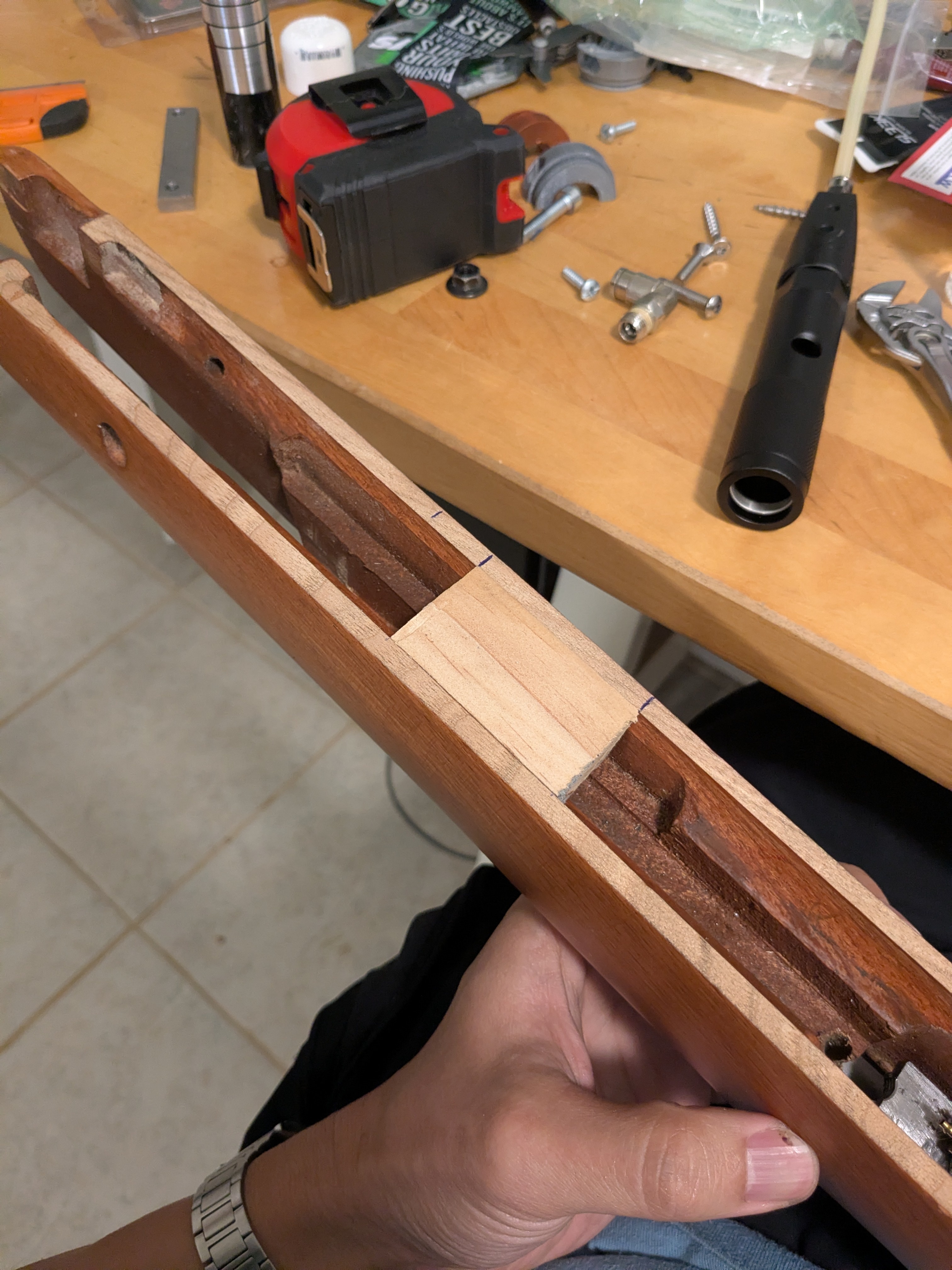

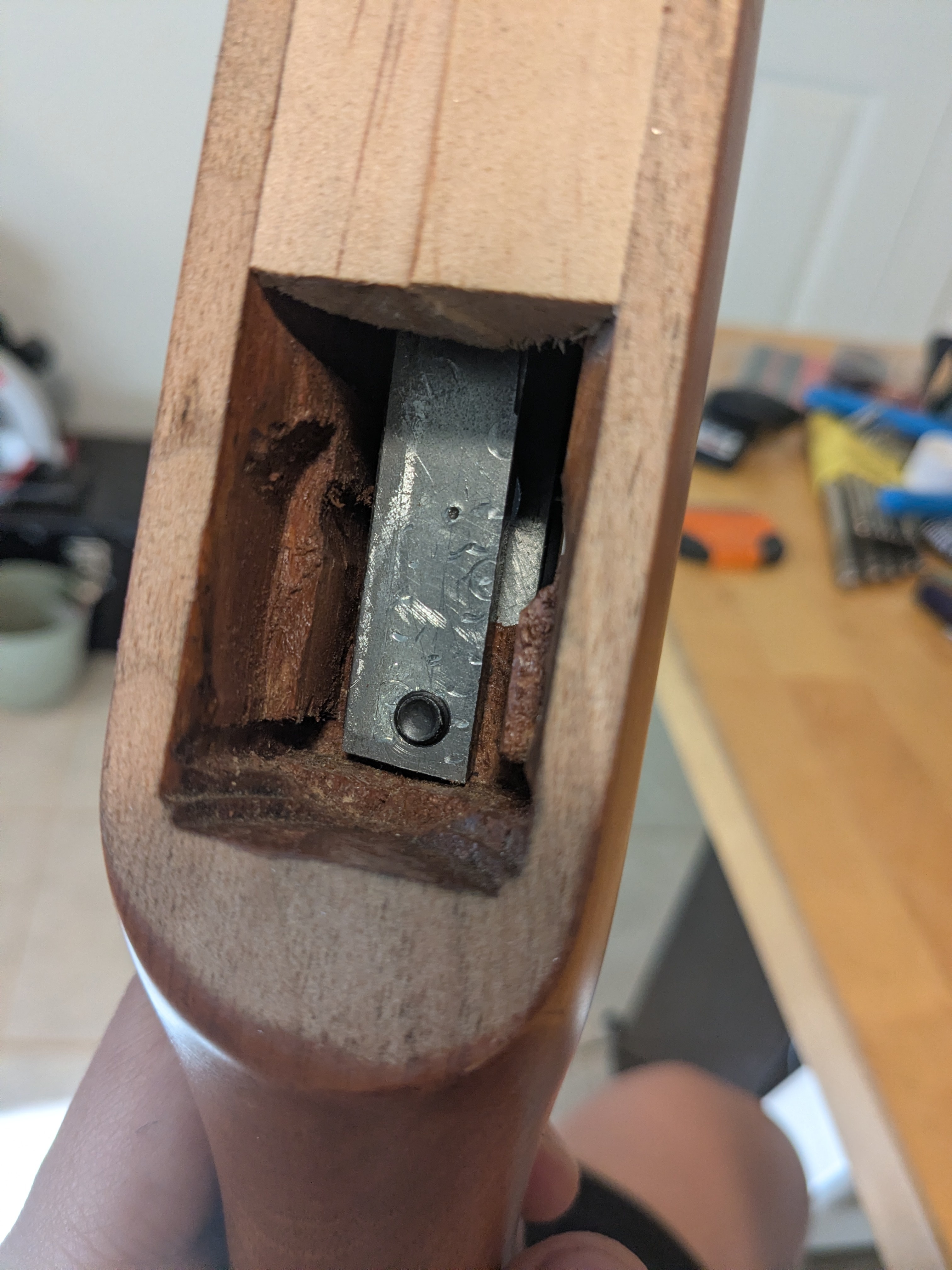

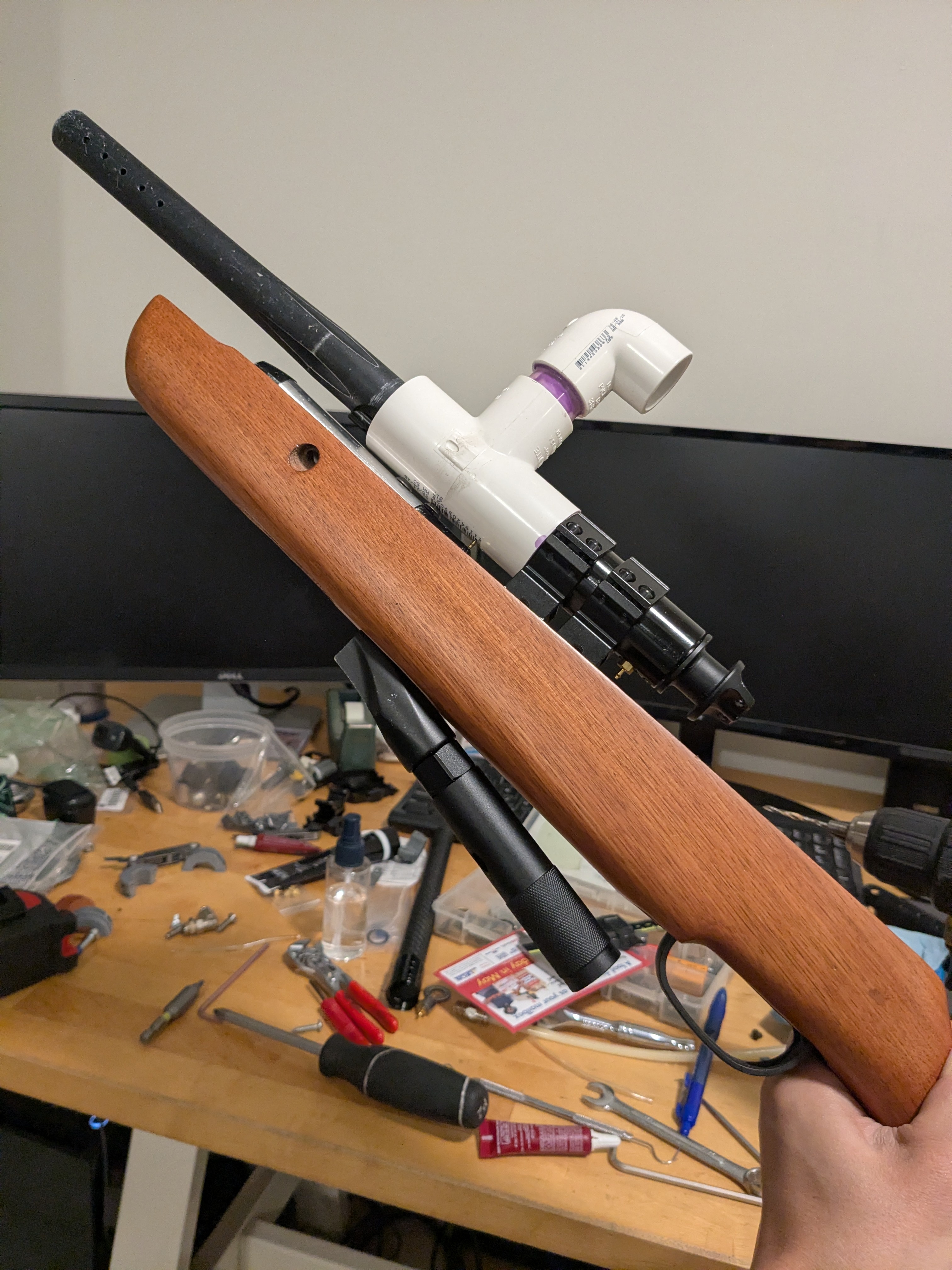

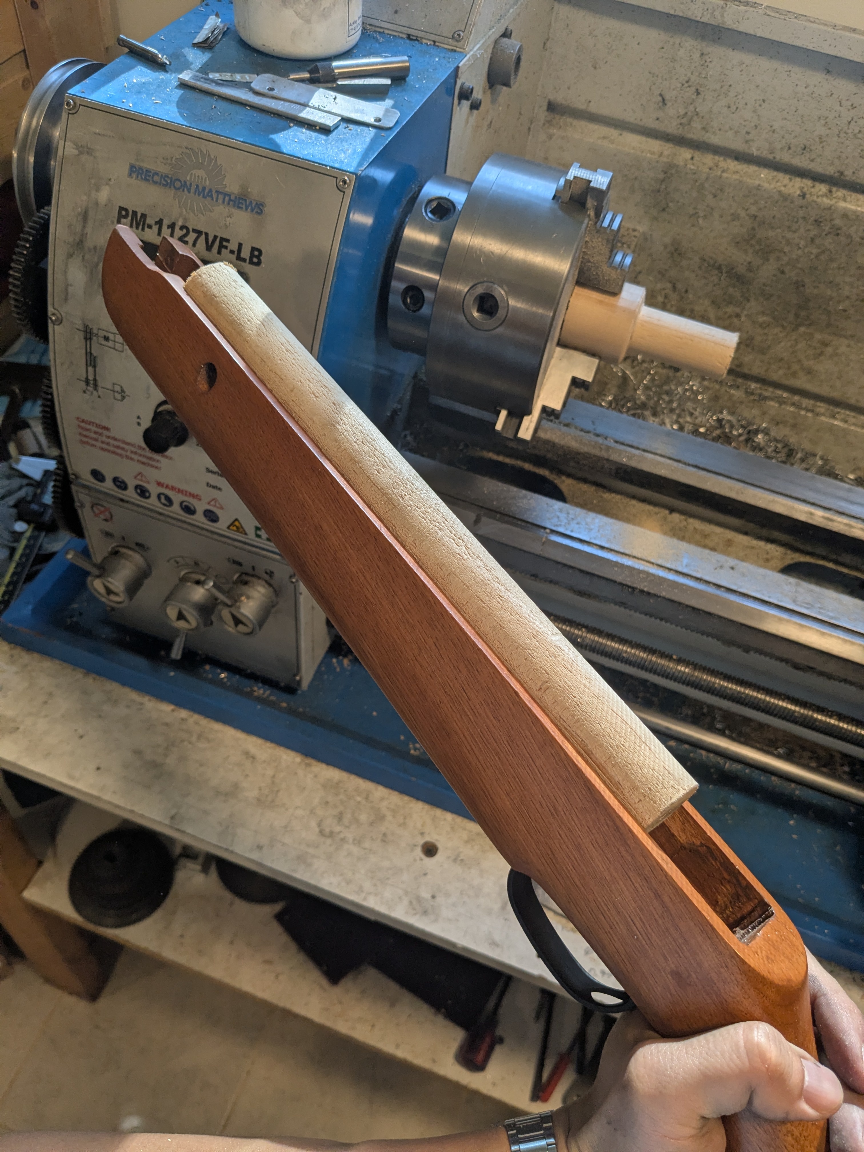

      I made some more progress this weekend. I cut and sanded this rod flat on top:

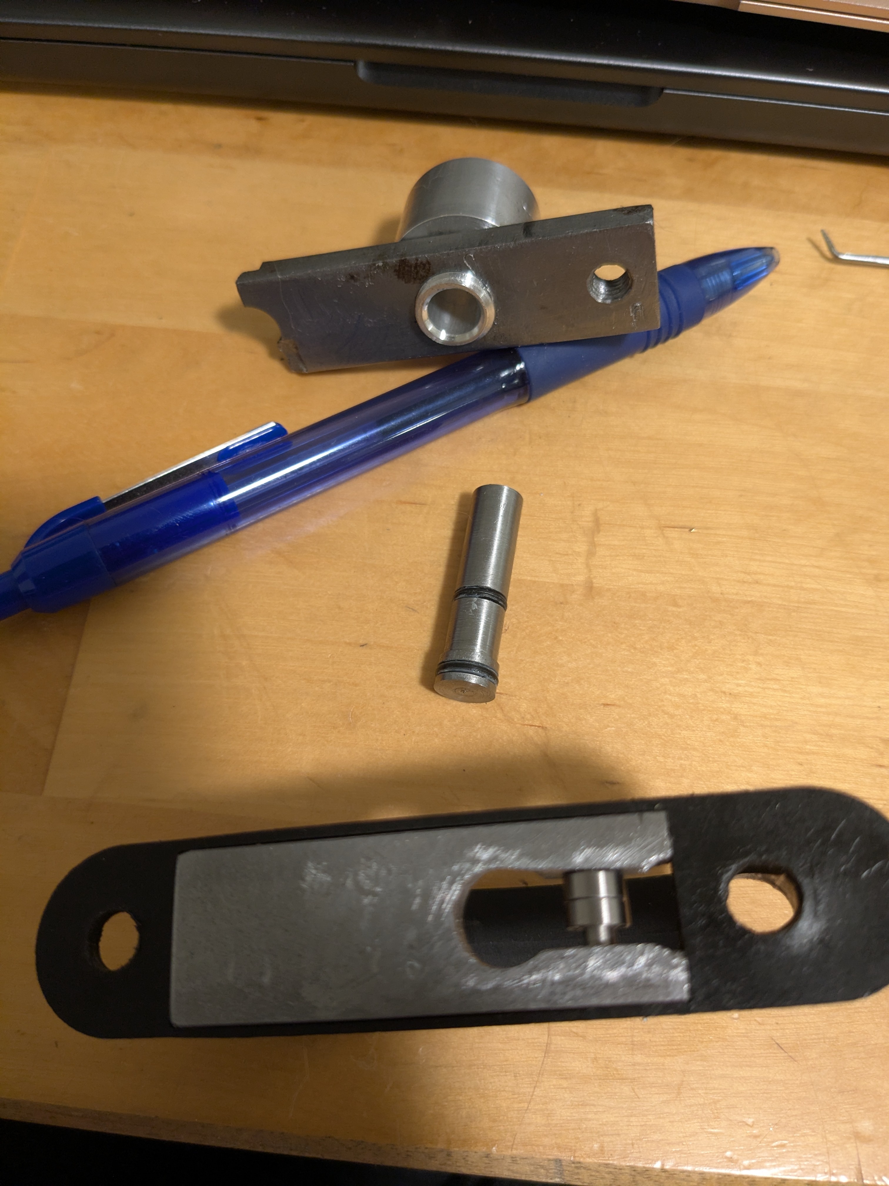

      And then machined a plate to hold the trigger pivot and another to hold the valve assembly:
      But now am finding out that space is becoming very limited. I may have to cut this wood back out and replace it with a thin aluminum plate to free up some interior volume to run hoses. As it sits, macroline can't squeeze through channel running fore-aft under this wood semi-circle.

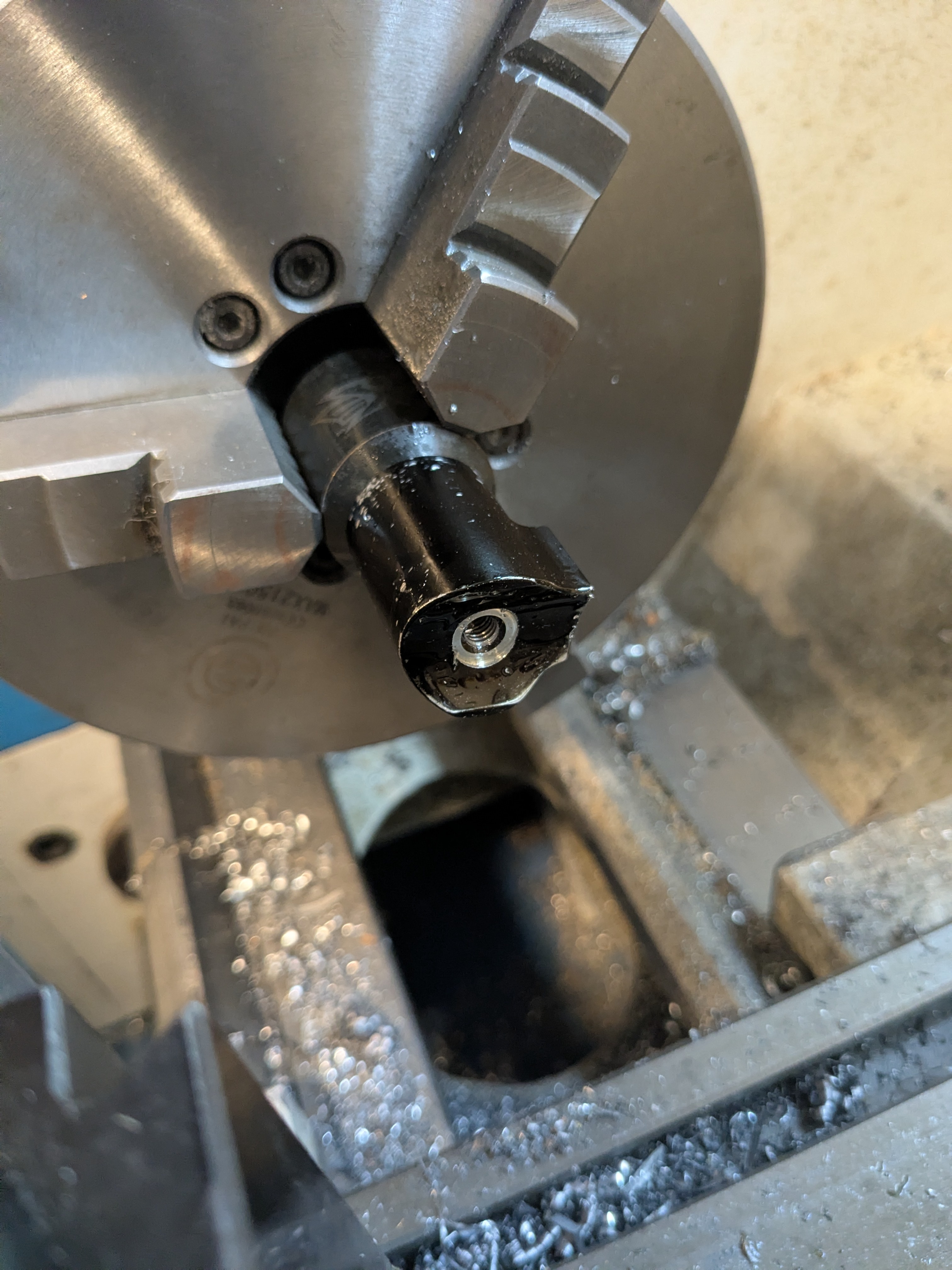

        Update: I got the main valve body and core machined today. I still need to drill threaded ports for hose barbs and cross drill a pin hole in the valve core to connect to the trigger mechanism.

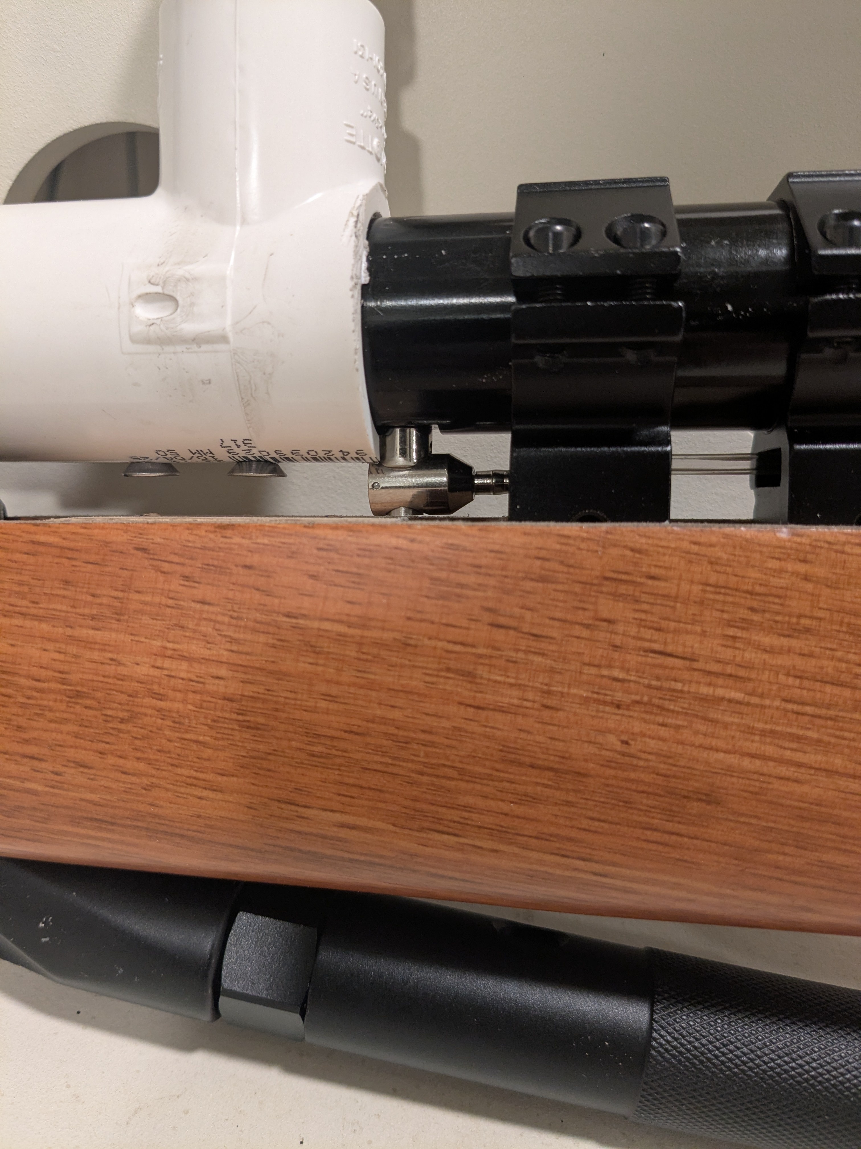

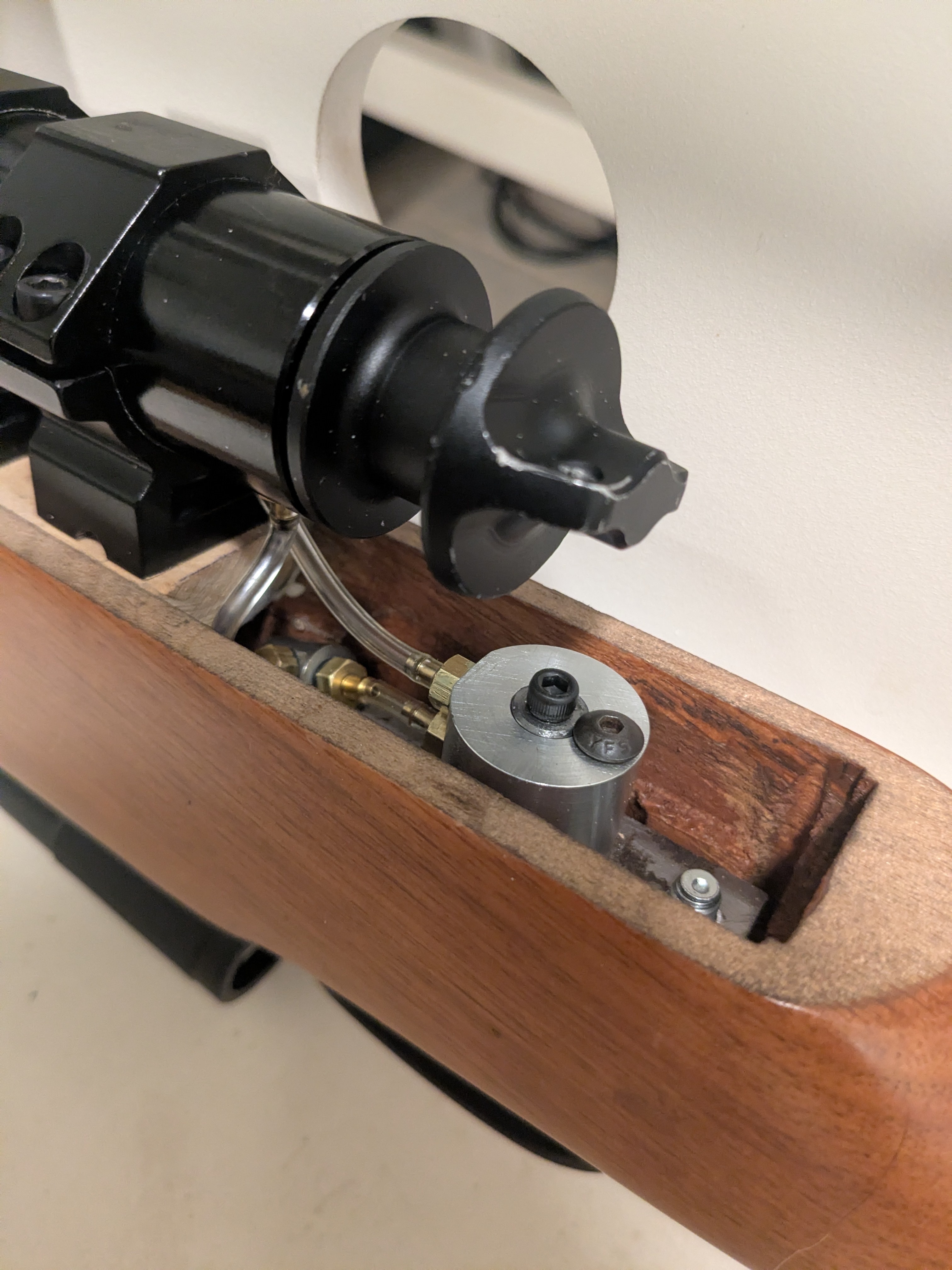

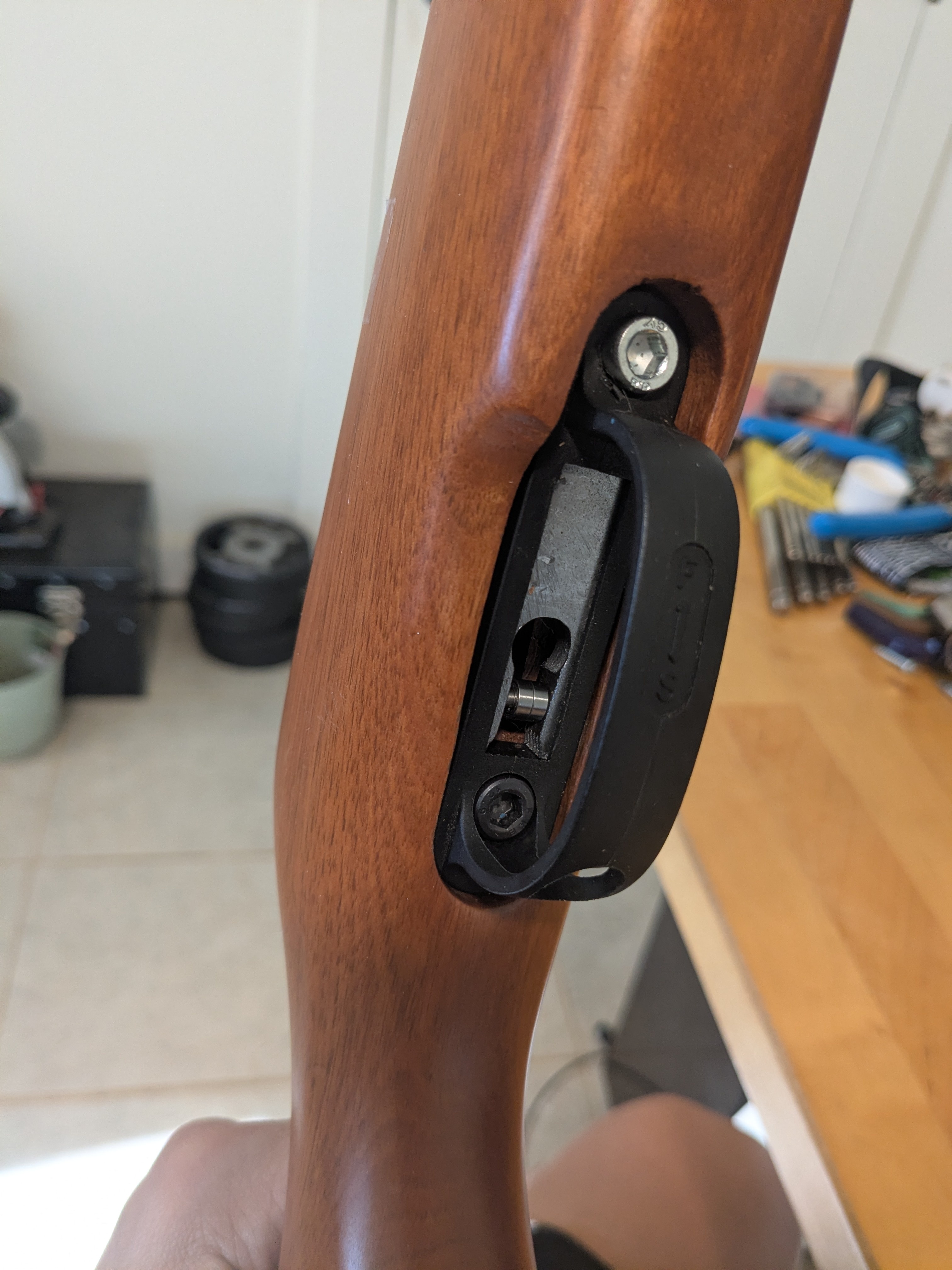

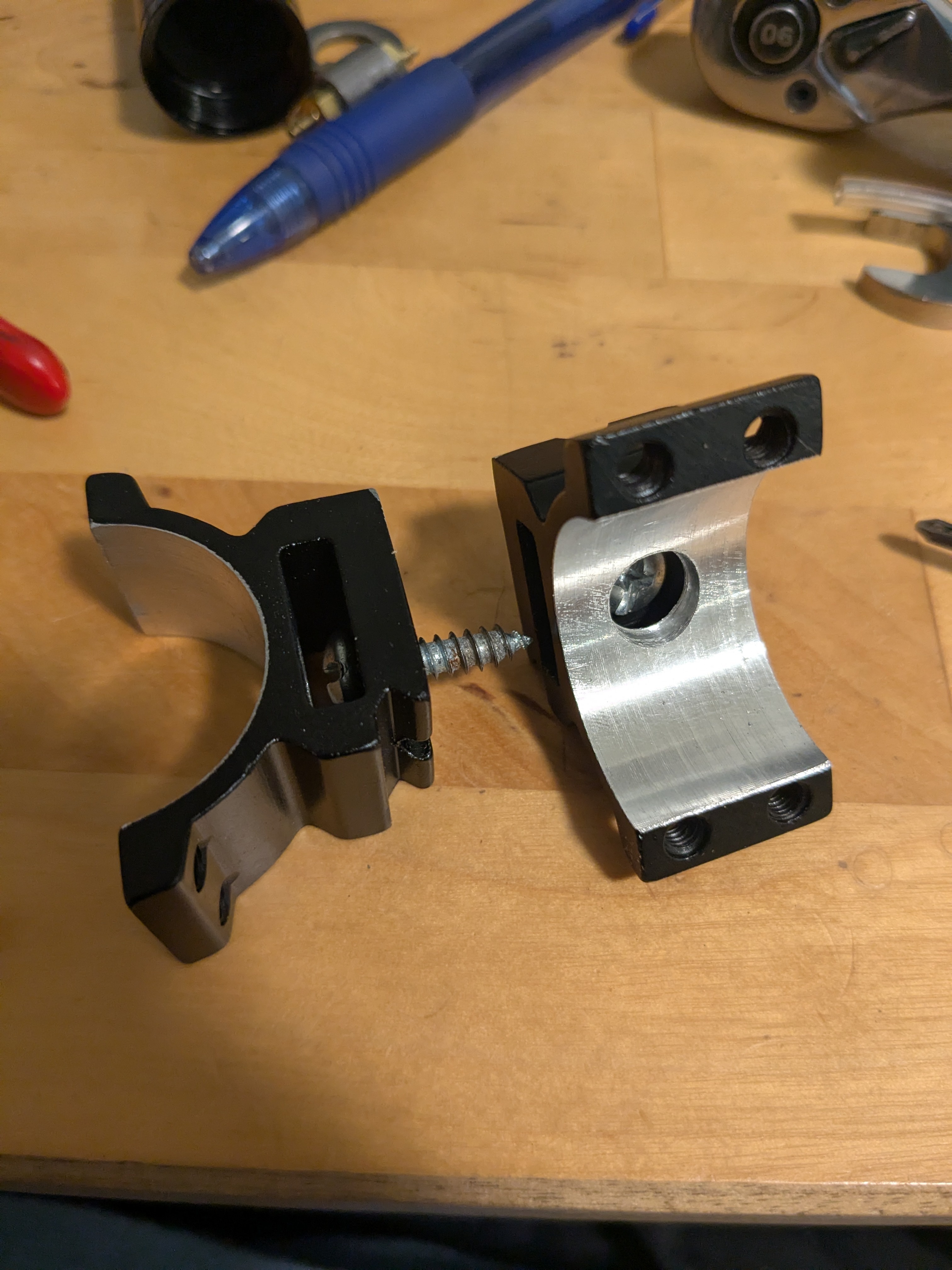

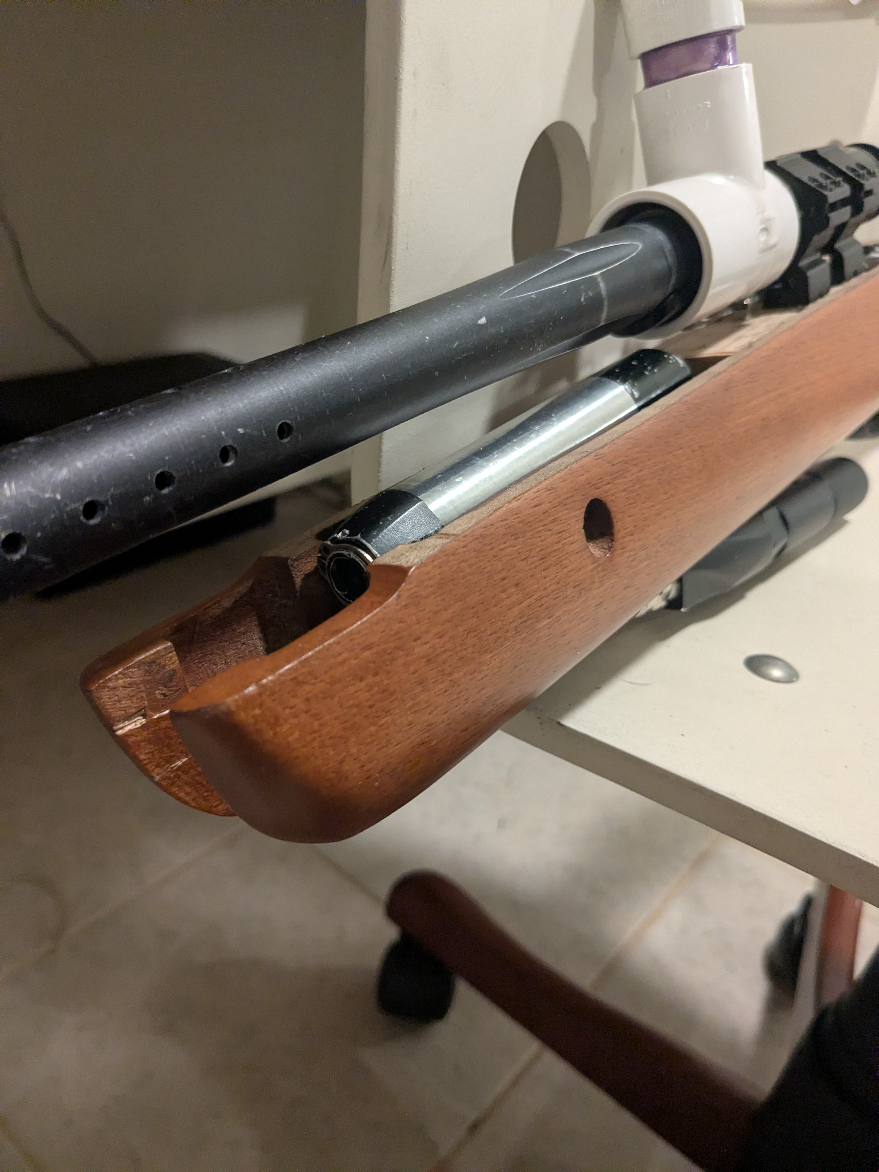

          I made a lot of progress today. First, relocating the hose barb on the VASA
          Then drilled mounting holes for the scope mount:
          And re-gluing this section of wood filler piece. The larger previous section popped out (who would've thought wood glue doesn't stick to polyurethane coating?) But this was fortunate since it gave me a chance to re-organize the hose routing.
          And finally got everything mounted up

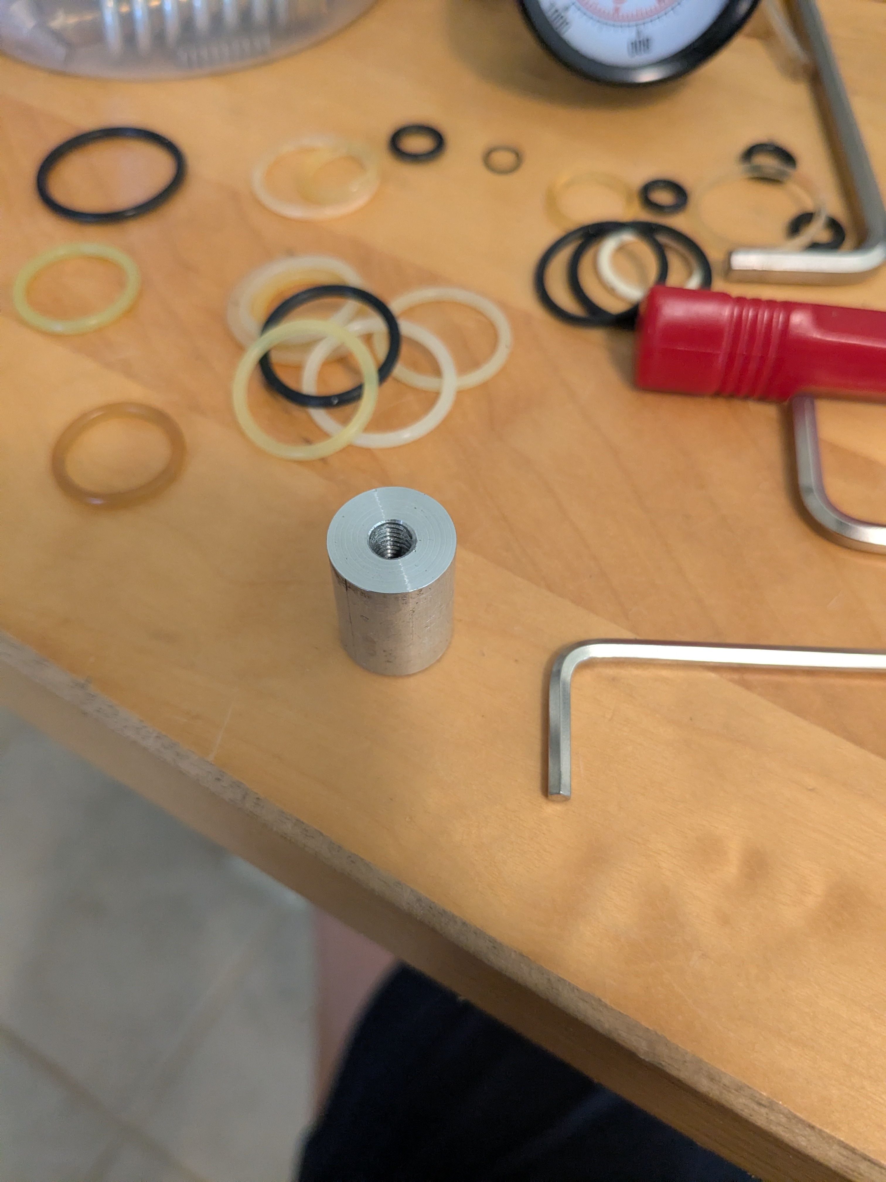

              The flow restriction worked semi-successfully. I made this tube to hold two barb fittings and some kind of restrictor in the middle.
              Initially testing with the largest ball bearing that would fit resulted in a comically slow bolt (but no stuttering)

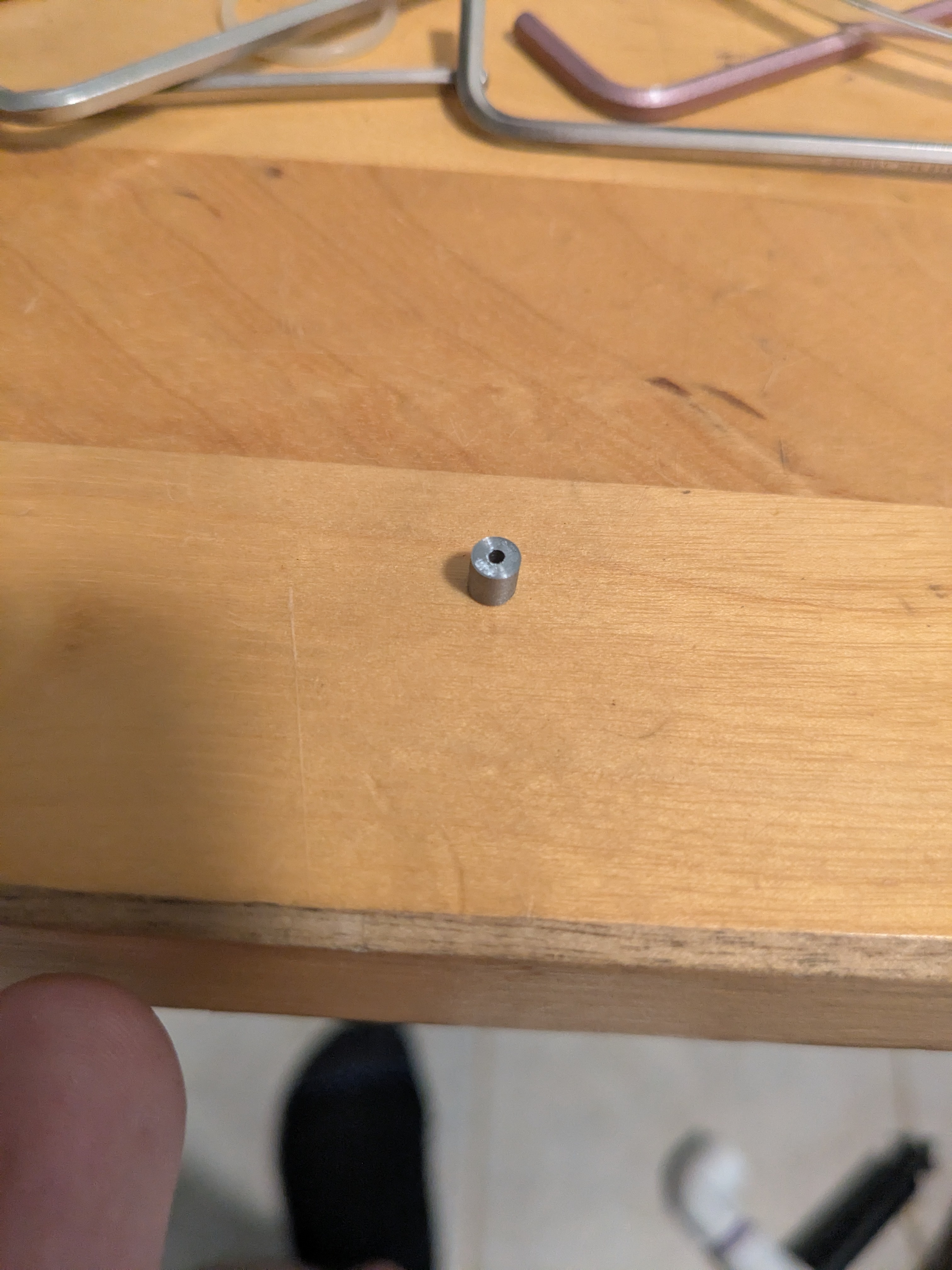

              Then I machined a more reasonable restrictor:
              Which was a little better but still too slow:
              https://youtube.com/shorts/s3ntNvCpe8U
