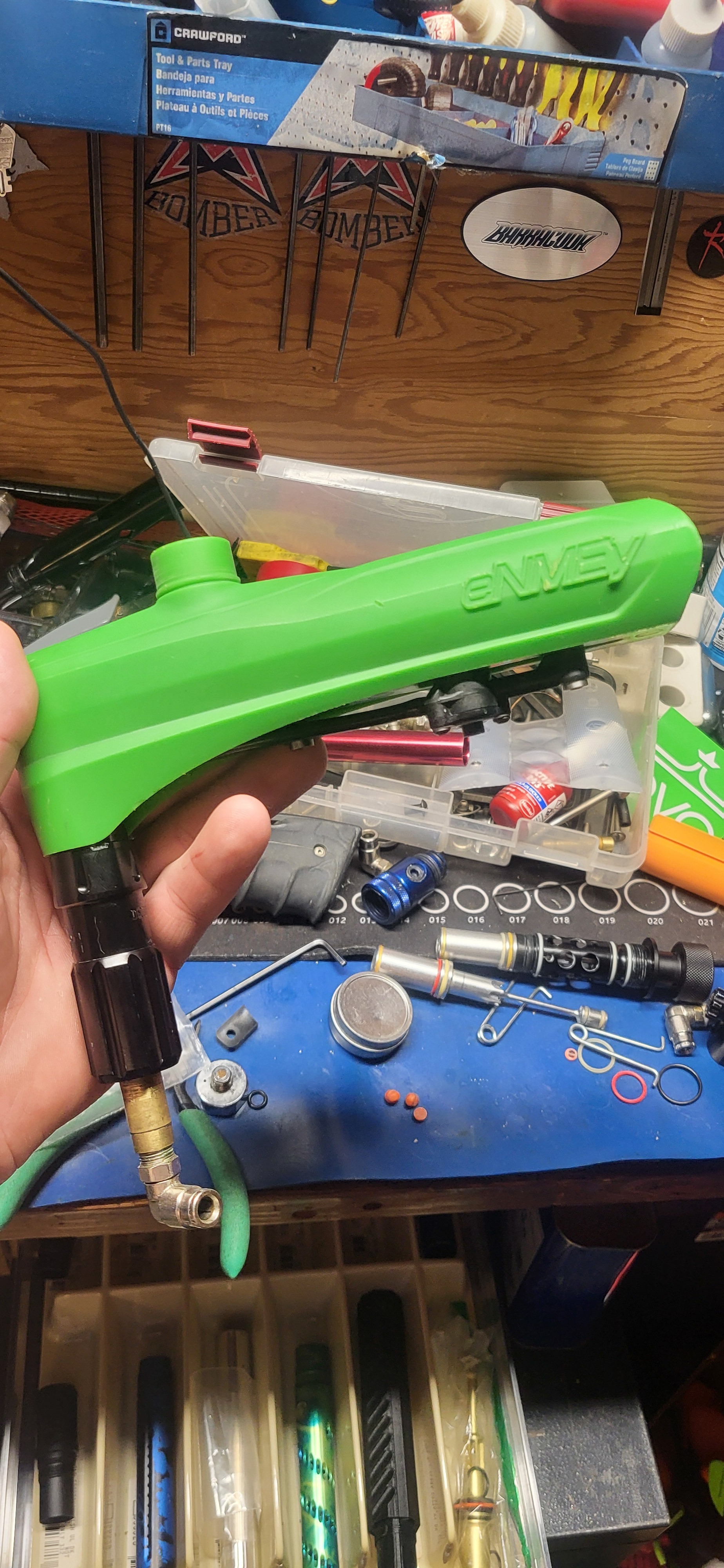

    Today I cleaned up the bits I think I want, and tried to just get it to hold air. No dice. im going to have to splurge on a full rebuild of the bolt assembly.

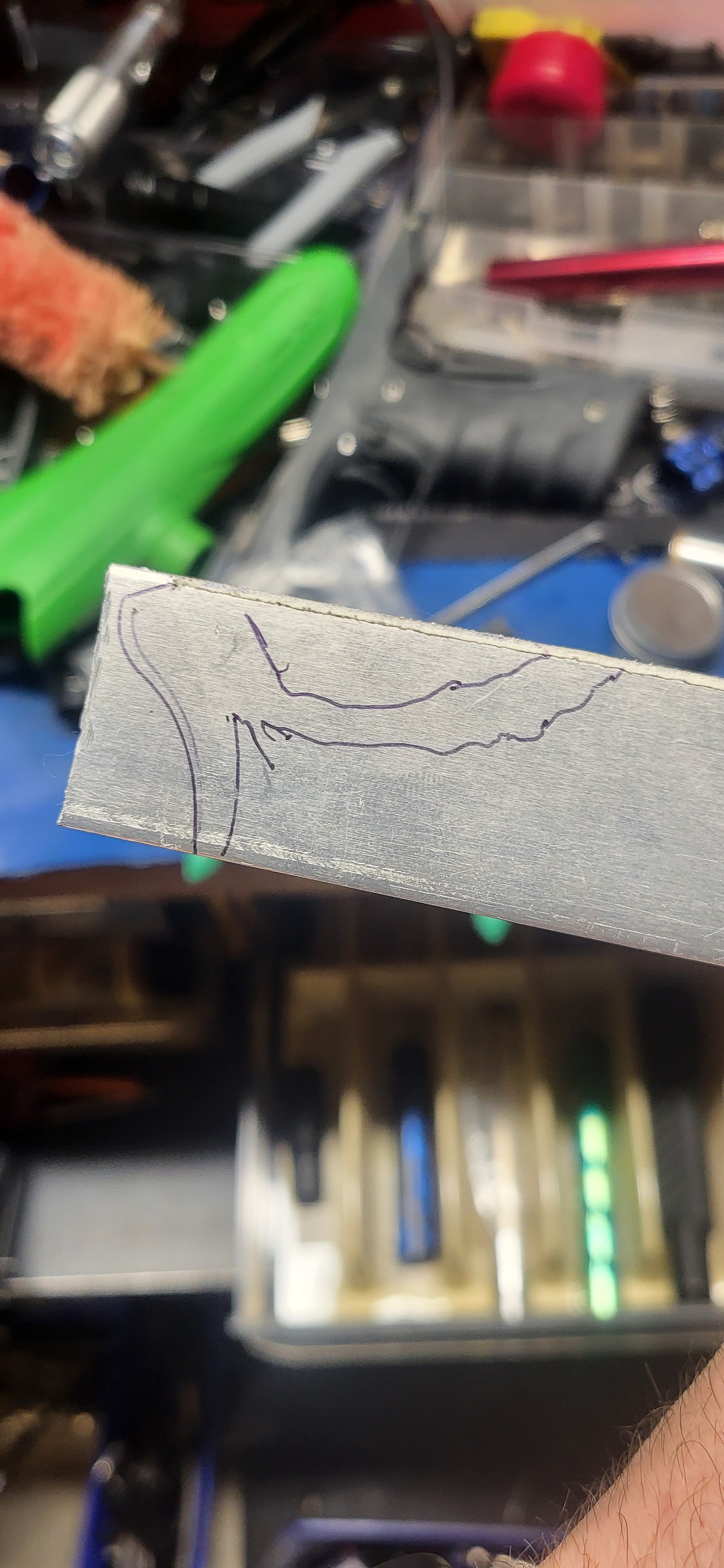

    I think Ill otherwise make a custom aluminum trigger out of some aluminum plate I have laying around. Add a brass trigger shoe, and KISS otherwise.

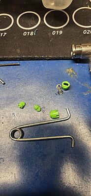

    when cleaning it up, i found this nasty burr in the breach.. i hand filed that out, and took the detents apart for a good clean.
    I then spent hours trying different bolt o rings out of an old captain o ring ion kit I have to no avail. It leaks out of the rear frame screw hole no matter what bolt, or o ringd I try.
    On the bright side it seems my rocket assembly works. So I'll order a rebuild kit and call it at that.

    Here is my poorly traced trigger plate and the body with the evil detonator I was trying to use. I know the reg works so it is a means to not spend time on the sp hprs.

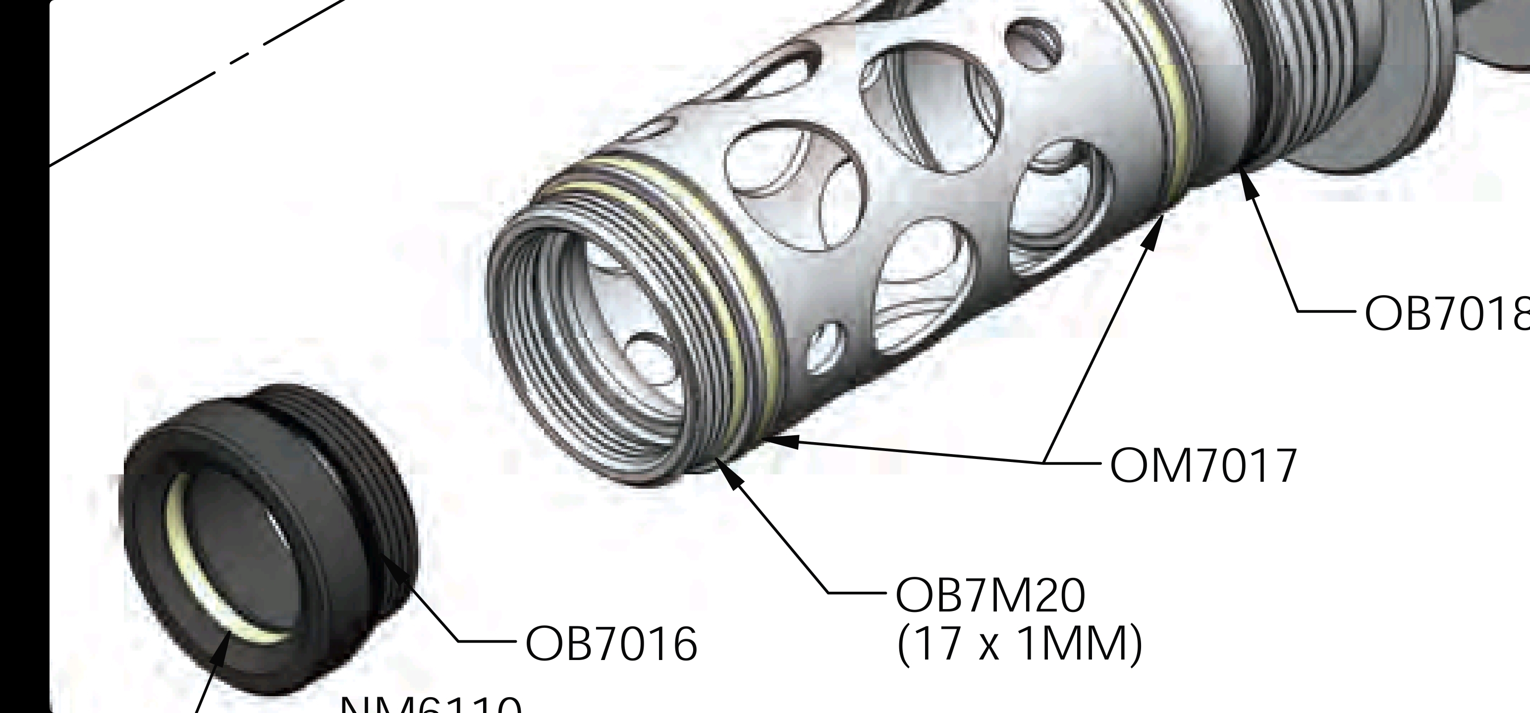

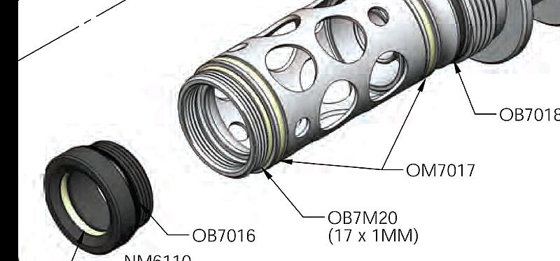

    Two of the three bolt assemblies I had were leaking out the rear body screw and it was driving me nuts after solving several other leaks before those presented themselves. It turned out to be the metric o-ring (OB7M20) that the diagram shows at the end of the rear bolt assembly. Removing that allowed the bolt tip to screw all the way into the rear bolt assembly and let everything seal properly when gassed up.
