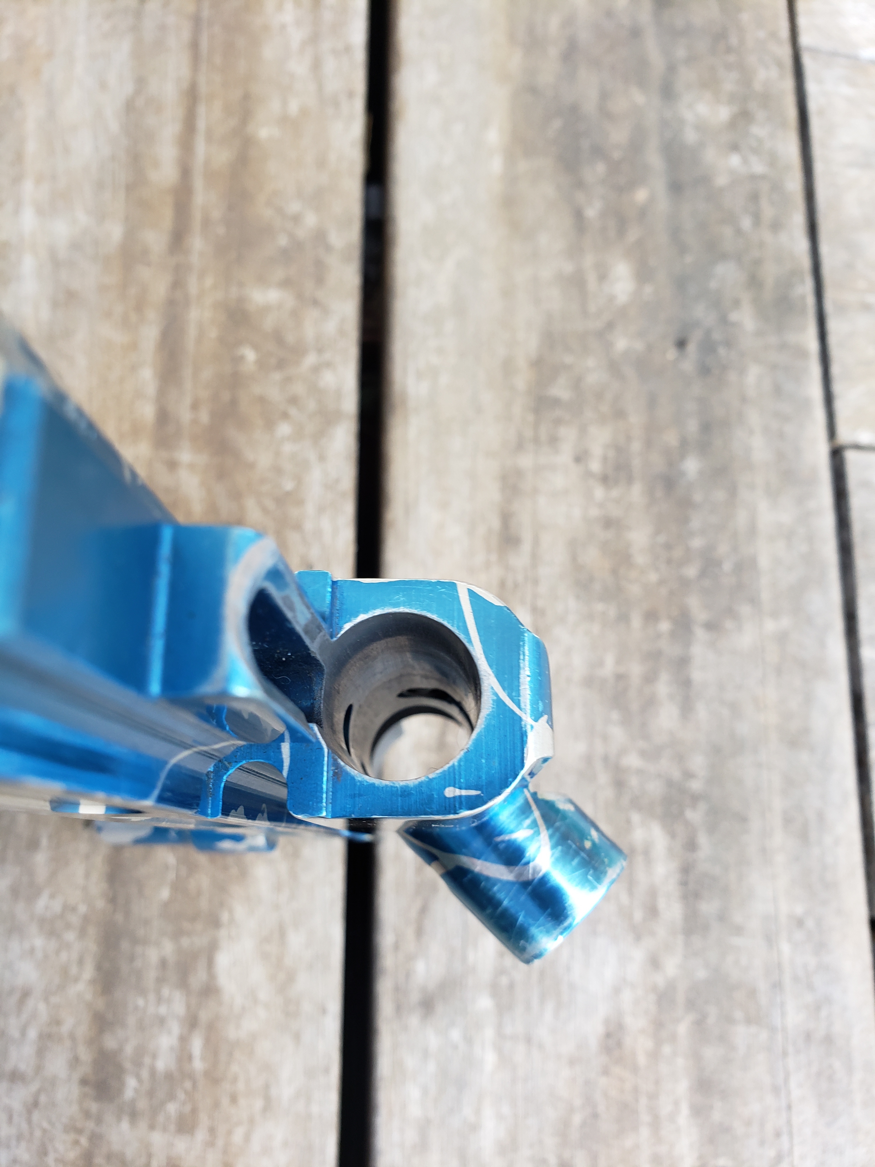

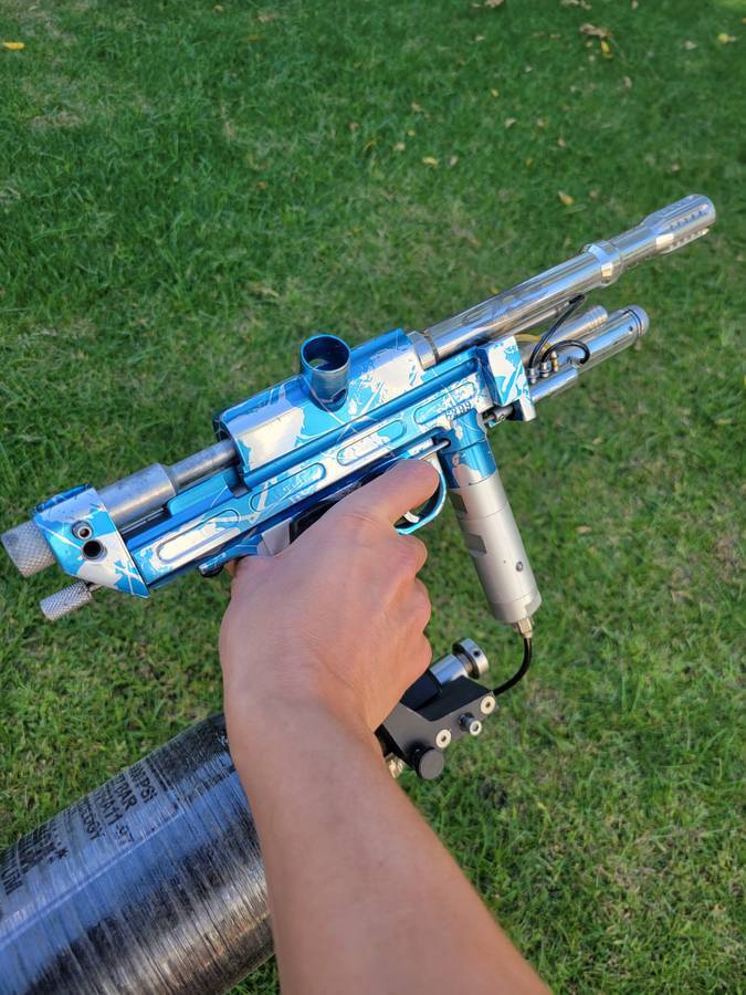

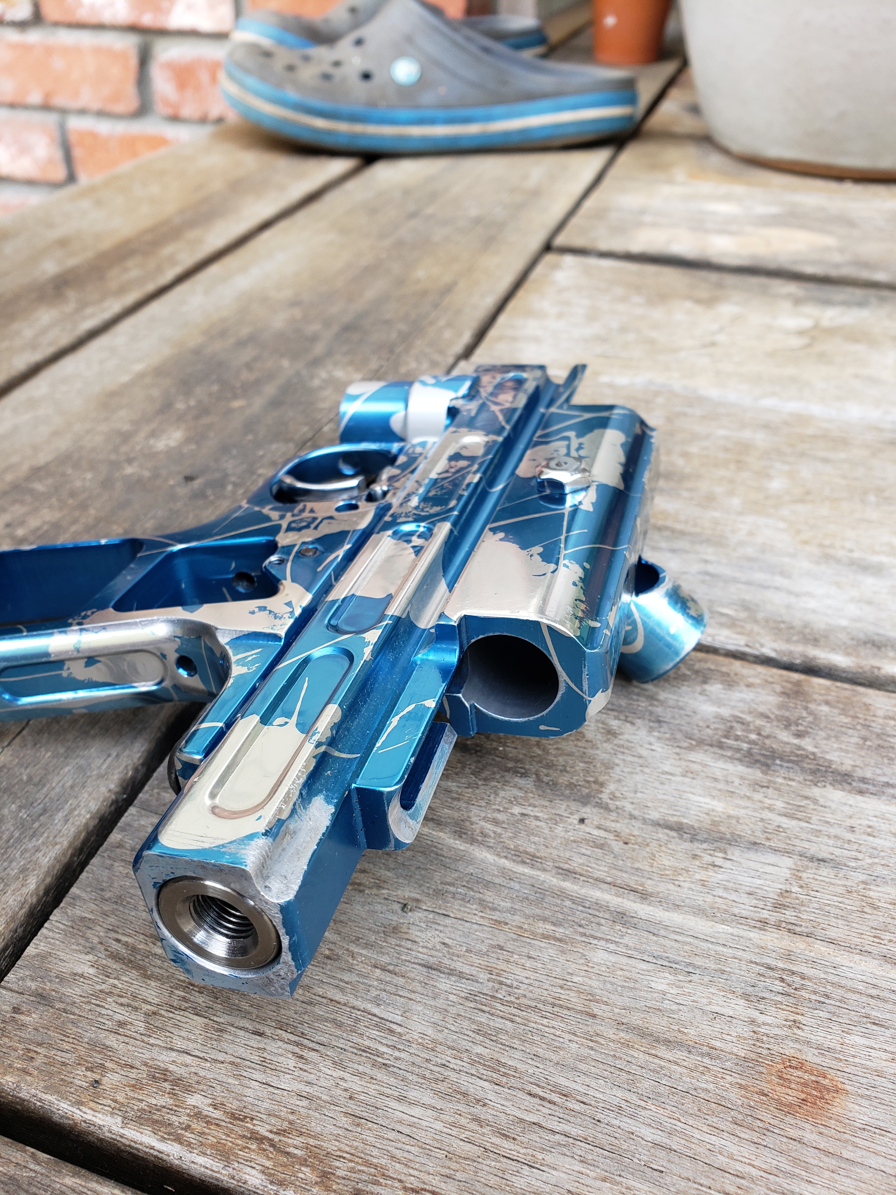

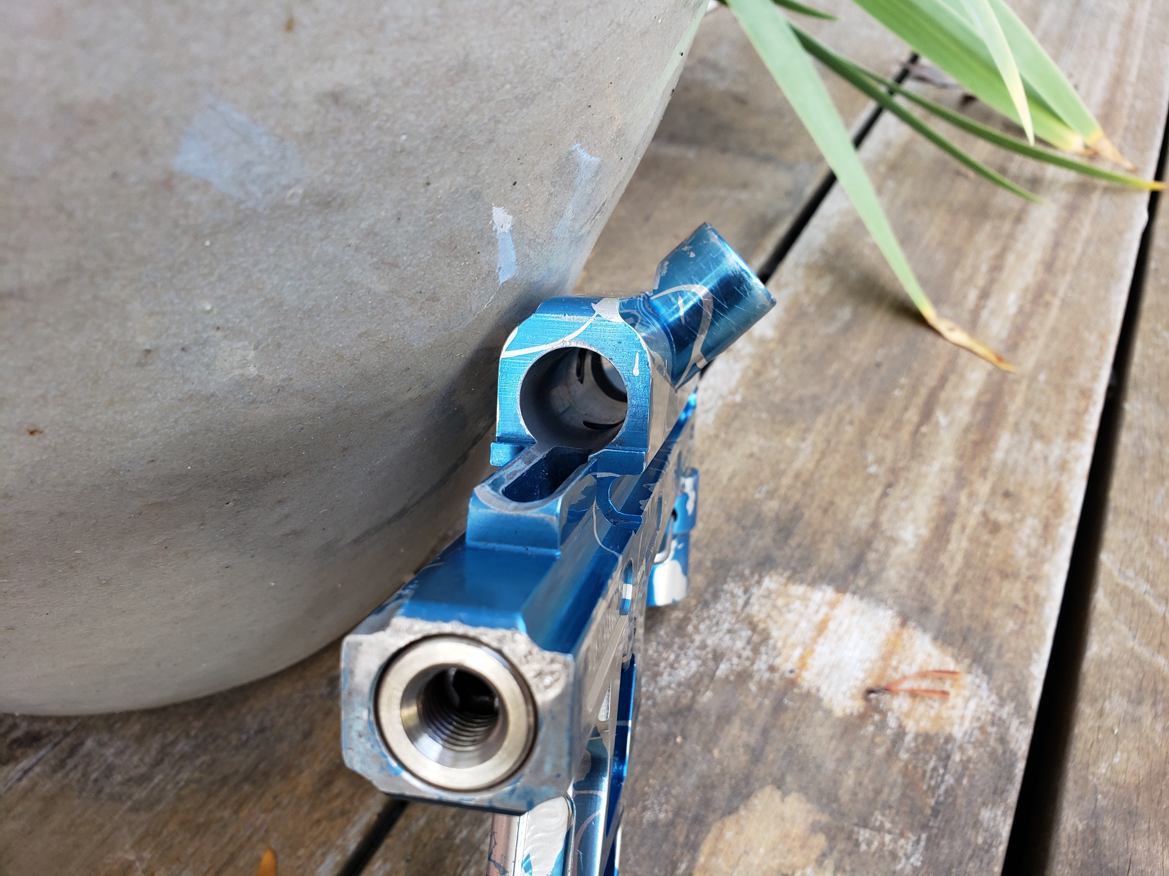

                20211026_155204.jpg 20211026_155137.jpg Breach wear isn't as bad as i anticipated.. however the list of bad is getting longer and longer the deeper I dive.
                  Ecapnation commented
                  The back off that body.... Yikes pitted as hell
                • Loophole
                  Loophole commented
                  Yes some major pitting. A better photo below.

                • russc
                  • 407
                  Is it just me or does that look like a halfblock that lost its bolt, sled and pin?
                    It looks like a cocker some dude milled "all cool bro" with zero knowledge of the mechanics of the gun.
                    At this point it should be half blocked.... Or parted and the body chucked

                    • DocsMachine
                      • 2821
                      Yup. Almost certain that was some early form of halfblock. It was clearly milled for a "lug slot", which wouldn't have been needed if they'd intended to keep the back block and conventional bolt, and that slot has been notched to the side.
                      Meaning the bolt likely had a fixed lug, like the early Sheridans, and the bolt was slid in, and twisted to lock it back into place. Again, like the old "quick strip" slots for Sheridans.
                      But, with that layout, the bolt would have been supporting both the lug and the "block", which was almost certainly a wrap-around affair. (That is, not a "sled" as we know such things today.)
                      Loops; If you want to "restore" it, for want of a better phrase, I'd love to take a crack at making a functional backblock and bolt for it.
                      Doc.
