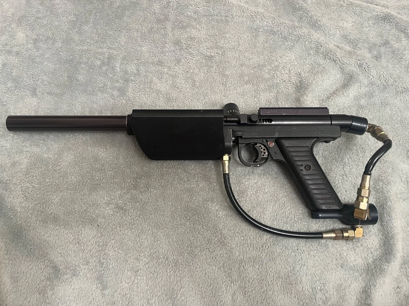

    WGP Auto-Ranger?
    https://www.ebay.com/itm/287438122589
    It looks like a ranger to me, but with a cocker front block?

    I believe it’s an auto Ranger but someone else might know for sure.

      Think AutoTraccer but for the WGP Ranger
      • DocsMachine
        • 2821
        That IS an AutroTrracer. The kit came with a WGP slide frame- the Ranger came with a pivot frame.
        Note the snap ring on the barrel at the front of the pneumatics- that's a Trracer barrel. (The AT kit came with a thin sleeve to space the Trracer barrel out to 1", so the shroud would fit properly.)
        Except for the hand-drilled trigger and "ported" feed neck, that's a box-stock AutoTrracer.
        Doc.

          I stand corrected 👍🏼
          XEMON commented
          You're right, good catch on that.
          I keep forgetting there was 2 semi conversion for the traccer.

                One tip: Constantly check the bolt screw is tight. You can't check it too often- because it WILL come loose, the action will try to bend it back and forth, and eventually ruin the screw.
                Timing is also a bit tricky- that's old enough it probably has the early cup-and-clip 3-way, which has a longer stroke than modern switches, and of course you can't adjust the sear for release.
                We fought with a couple of those for years, back in the day, and I always wondered if modern mods, like an adjustable LPR and a better 3-way, would have helped.
                  Plus the Chameleon and the Trojan. Maybe Colin could have sold Autospirits as a bolt on kit? He only made about 100, using off the shelf parts.
