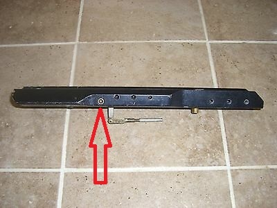

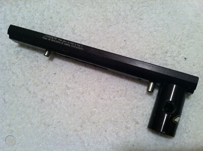

      black-agd-automag-minimag-body-rail_1_65330a3f260c5e2fe6289a7bc4864b2c.jpg AGD-Automag-RT-Pro-Paintball-Gun-Rail-Airgun.jpg
      The rail with the red arrow pointing towards a screw is a rail that uses the RT style sear. The other rail uses the classic AM/MM-sear. Those two different sears are not interchangeable. To my knowledge Luke has made plenty of custom rails of both configurations, so it could be either.
      However, since you have the rail already, you can easily check that up for yourself. Just check whether or not the sear is supposed to be fastened with a screwed in axle pin, or if it is supposed to be dropped in from above - in which case there should be no threaded hole on the side of your rail.

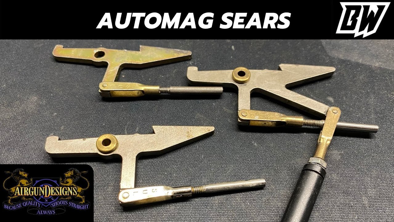

        superman recently posted a nice video about Automag sears on his Bearded Works YT page.

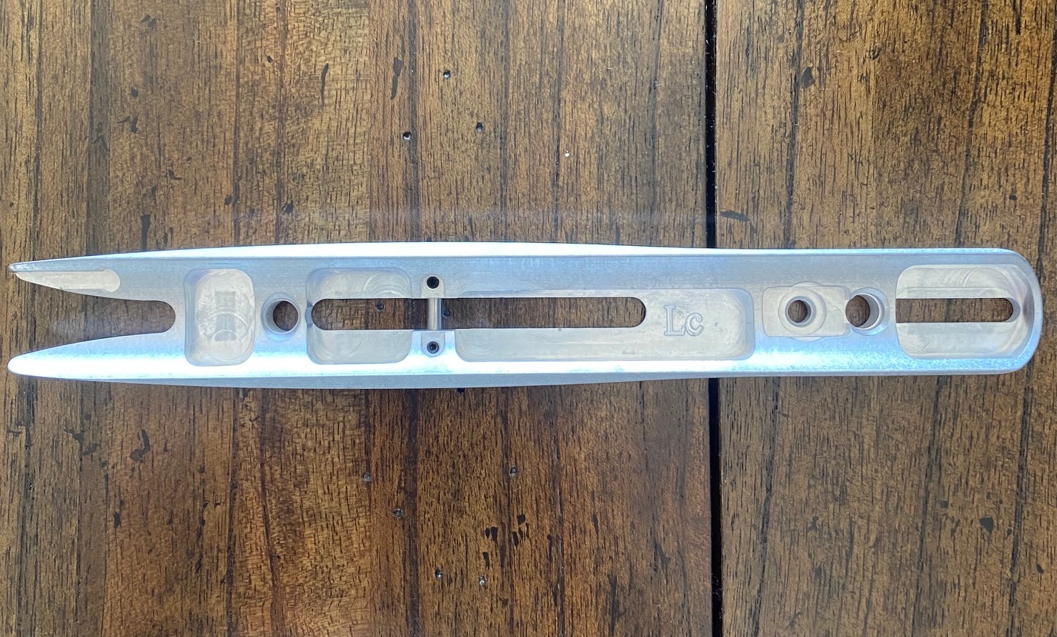

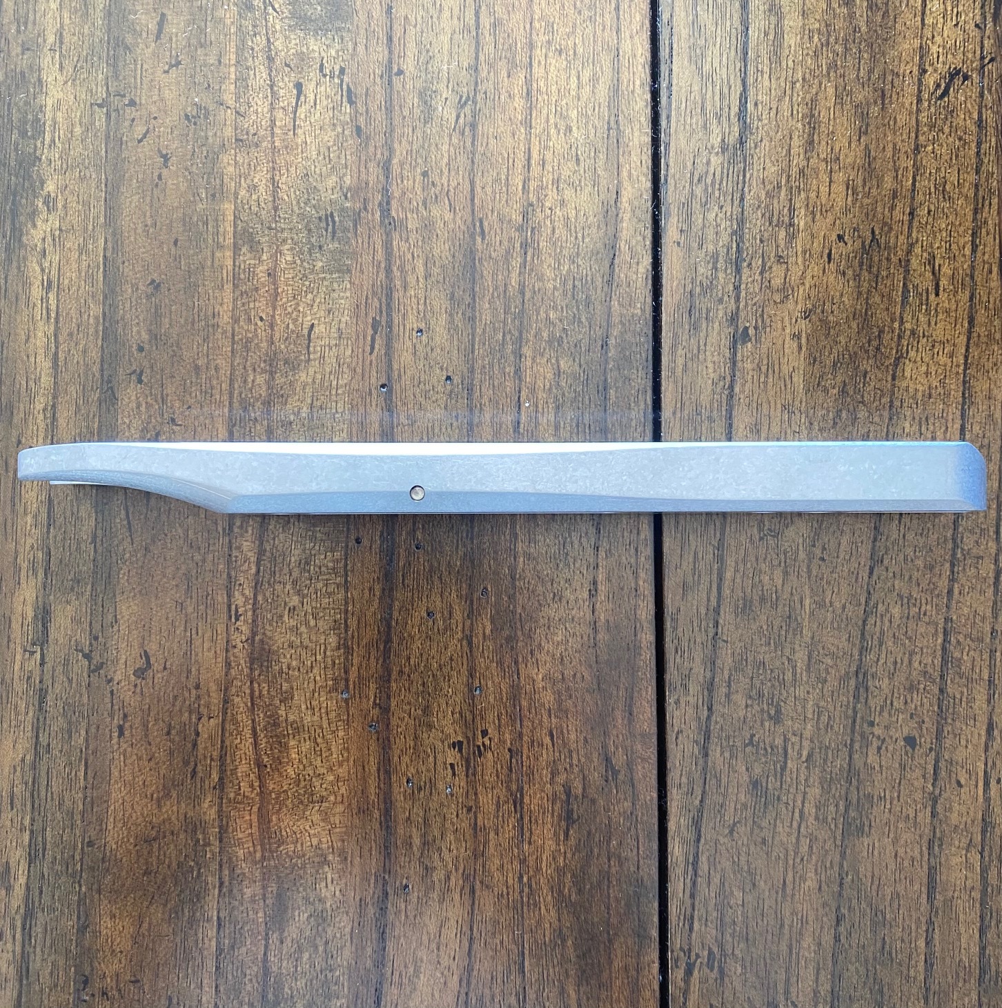

            I have attached pictures of the rail I have. is it the standard Automag/Minimag rail or a different one?
            • superman
              • 3386
              • Mount Pleasant, SC
              https://youtu.be/XajhYT1srrc
              That luke rail requires an rt sear.
