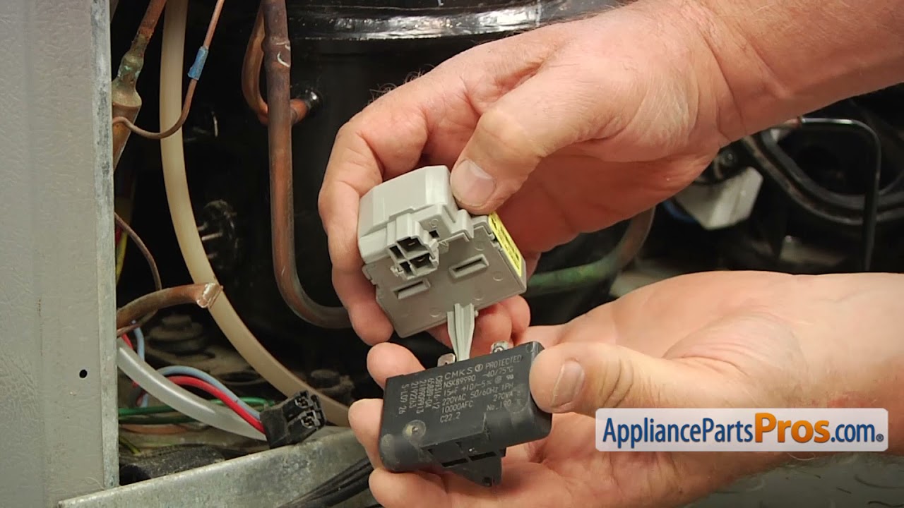

            Mine did the same thing, It was the Compressor Start Device (Capacitor), I also replaced the Run Capacitor since it was connected to the Start Device. They are both mounted to the left side of the compressor. (mine is very much like this video I have attached). Also, since I was down there with things apart, clean all the coils I could get to.
