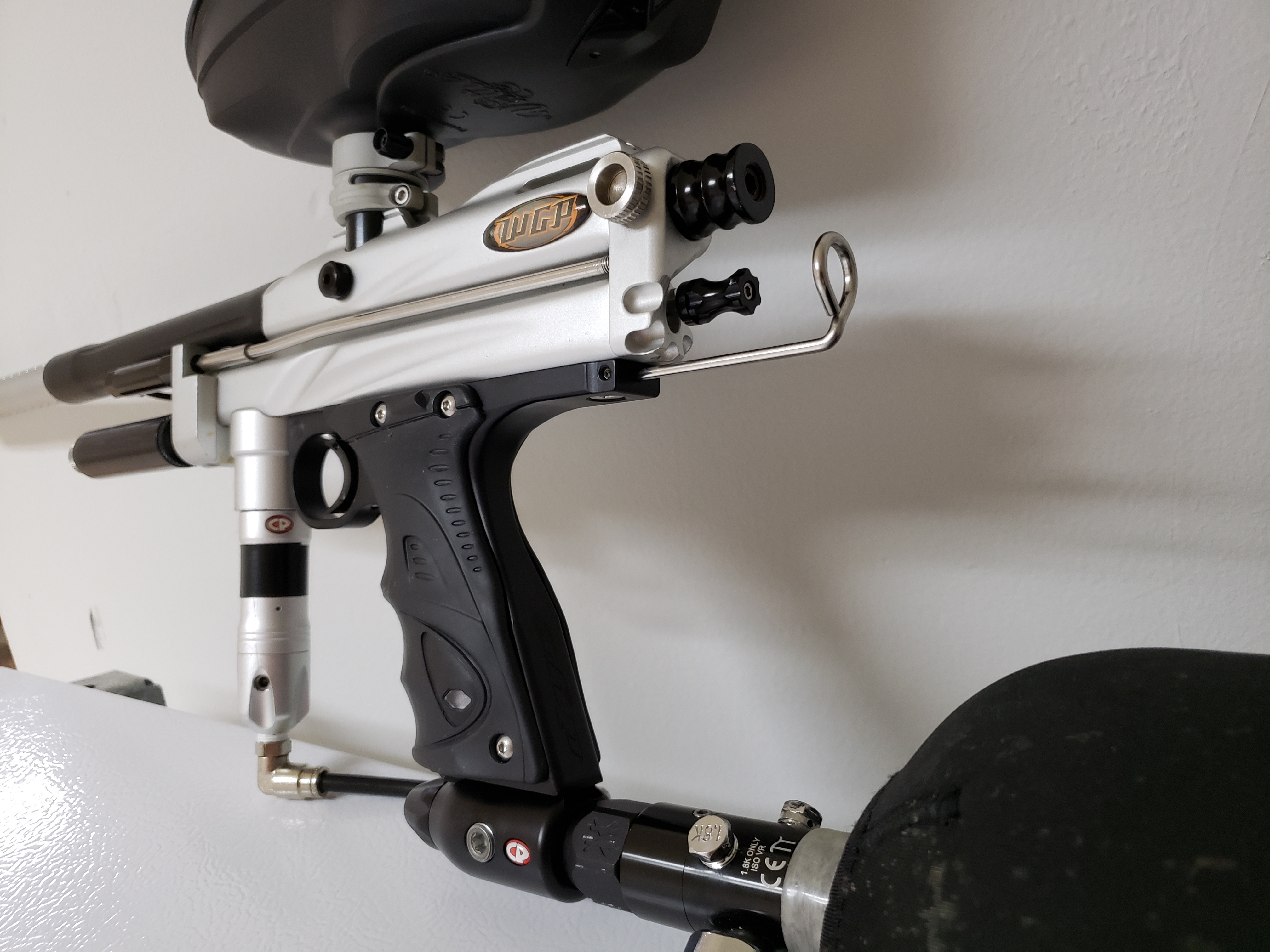

                  Originally posted by GenPunishment
                  Holy crap! Thanks for all your inputs, great to see MCB is still super active! Based on all the cocker responses that may be the route to go. Any new brands to avoid?
                  You could also pick up an older Autococker and just start throwing newer stuff onto it, like I did with my 2k3.

                  • latches109
                    latches109 commented
                    what bolt is that
                  • Brokeass_baller
                    Brokeass_baller commented
                    Honestly not sure. Pretty sure it was a leftover piece from a long ago ebay build. I can snap better pics if you want.
