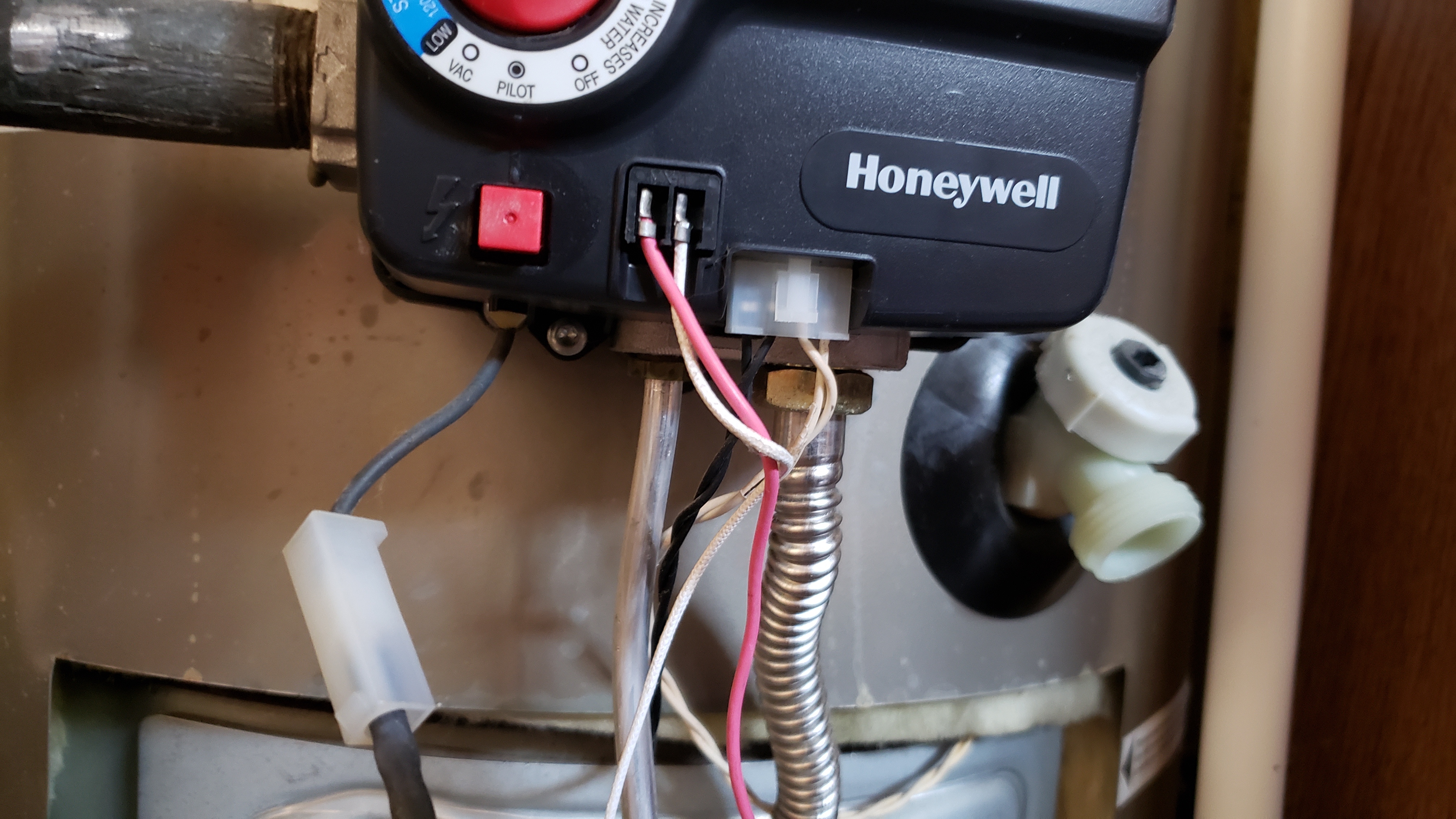

    I'm looking for a Honeywell gas valve. Model number: WV8870A1008
    I've found two on eBay, but it looks like the thermometer is missing on both.
    This is for my elderly mom's water tank. I'd like to fix it up rather than spend the extra couple hundred on a new tank.
    Thanks everybody.

    That one has the wrong connectors. I have considered buying that one, though, and the accompanying burners, and "upgrading" it I guess.
    I need something like this.

        Damn. I used to do HVAC and I've installed plenty of HWTs. But I've never seen this black valve before. It was always either the white one like BrickHaus found, or the old cast valves. I wonder what the deal is.

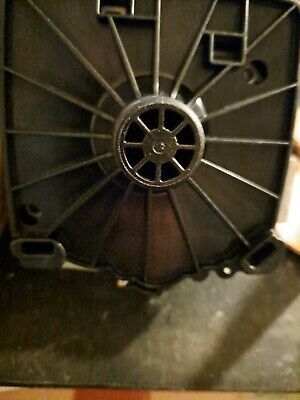

          This looks like it:
          https://www.ebay.com/itm/266050668644

              Originally posted by Painthappy
              That is it. But they usually put a temperature probe on the back. This looks like it's missing that. I messaged the guy and asked about it. We'll see what he says.
