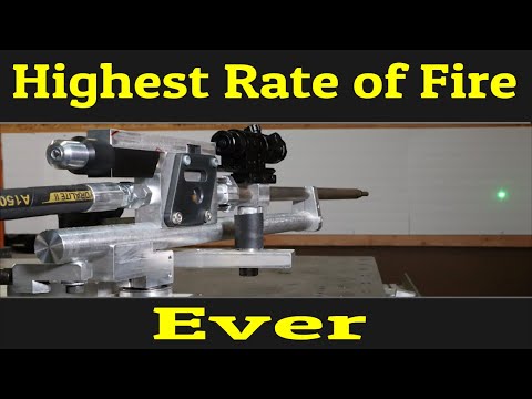

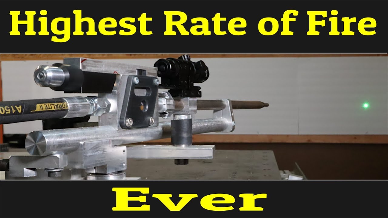

    I mean, to me he is really not shooting that fast because he is not loading each round or firing each round individually from what I can tell. He has basically made a sand blaster where the rounds are just pushed into a stream of air.
    If you count each grain of sand my sandblaster "fires" faster. Or, just get one million bbs and put a lift charge in the bottom of a bucket. That will "fire" one million rounds in a thousandth of a second.
    It's a cool piece of engineering but he basically had to redefine the word "firing"

      Agreed! How is it any different from a shotgun firing birdshot?

    Trbo has it. There's no bolt/chamber mechanism in that gun- it's an air blast with a spring-loaded magazine of some kind.
    Some of you might remember the old "Annihilator" freon-powered "machine gun" they used to sell in the back of magazines. Basically the same thing- all the trigger did was release a spray of freon (at the time, a convenient pressurized gas) and release the BBs to fall into the air stream.
    Not that this guy's gun isn't cool, and for that matter, we can't exactly say the 'Metal Storm' is exactly chambering/firing/cycling either.

                No but to me that one at least does control the firing of each individual round. If you tell it to fire 52 rounds, that's exactly what it will do. This guy's BB blaster can't without just loading exactly 52 into the magazine.
