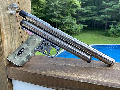

      Look up Blue Fork on Facebook. He makes cool trigger frames that fit AR style grips (Like a Phantom 45 which would allow an ASA or stock to be easily mounted) Make sure you ask for a PGP frame. Bottom left in picture
