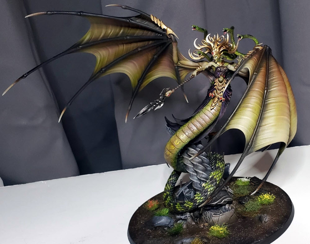

      If you are new to using an airbrush, needle/nozzle size are a factor as a larger size is more forgiving on paint consistency and your cleaning regimen.
      I use an Iwata HP-CS which has a .35 mm nozzle/needle and I highly recommend it. I also have some cheapy Chinese brushes that I had no issues with but again, larger needle size.
      Shameless link to some of my stuff. CoolMiniOrNot - Rickfactor's Portfolio
      • the_matrix_guy
        the_matrix_guy commented
        Those are super cool. I sent the link to my friend that’s into Warhammer 40k
