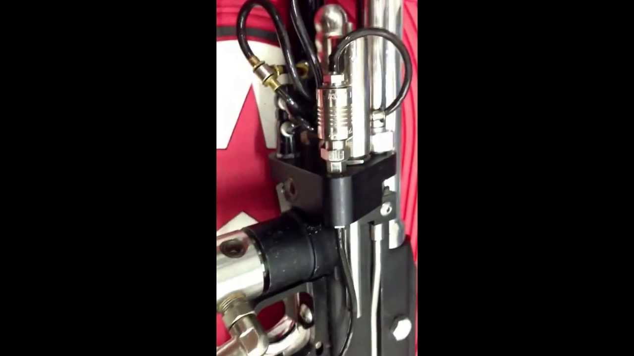

    Has anyone ever seen or built a FRT (forced reset trigger) autococker? Basically putting an AT on a standard cocker.
    I was messing with my pump gun (empire sniper) and realised what it was doing, and how it may be possible.

    Here ya go.

      I get a strong feeling that trying to time that thing would kick my butt 🤣
    • superman
      superman commented
      Which is probably why that one was sent in for timing. lol
    • cougar20th
      cougar20th commented
      Blackmagic71
      They really arent that difficult to time. I find mine easier to time then some of the normal cockers Ive done. Just time it as if it is a normal cocker. With the air restrictor on the ram set to full open (rememeber that step). The "auto" portion extra and doesnt really get adjusted.
