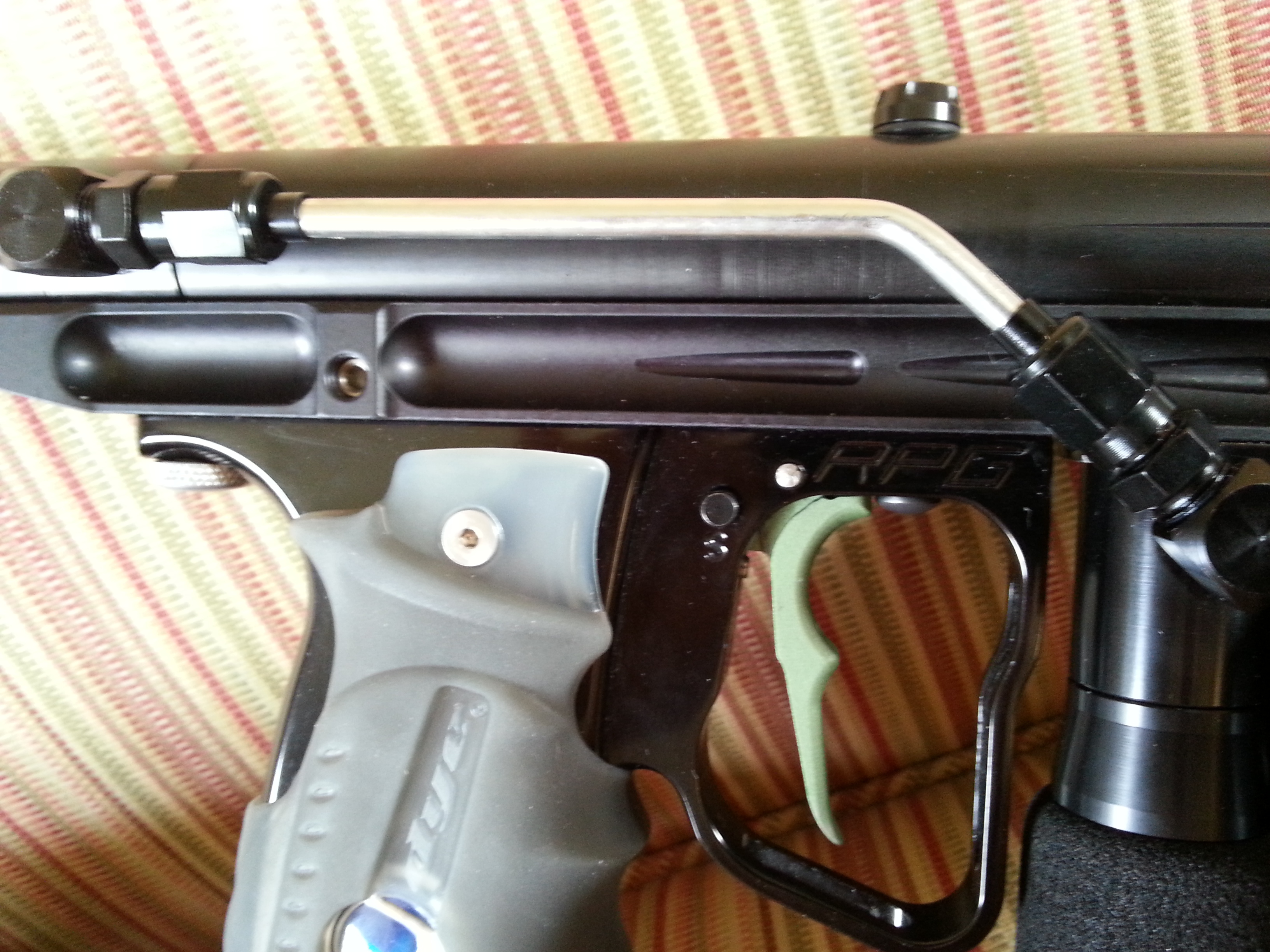

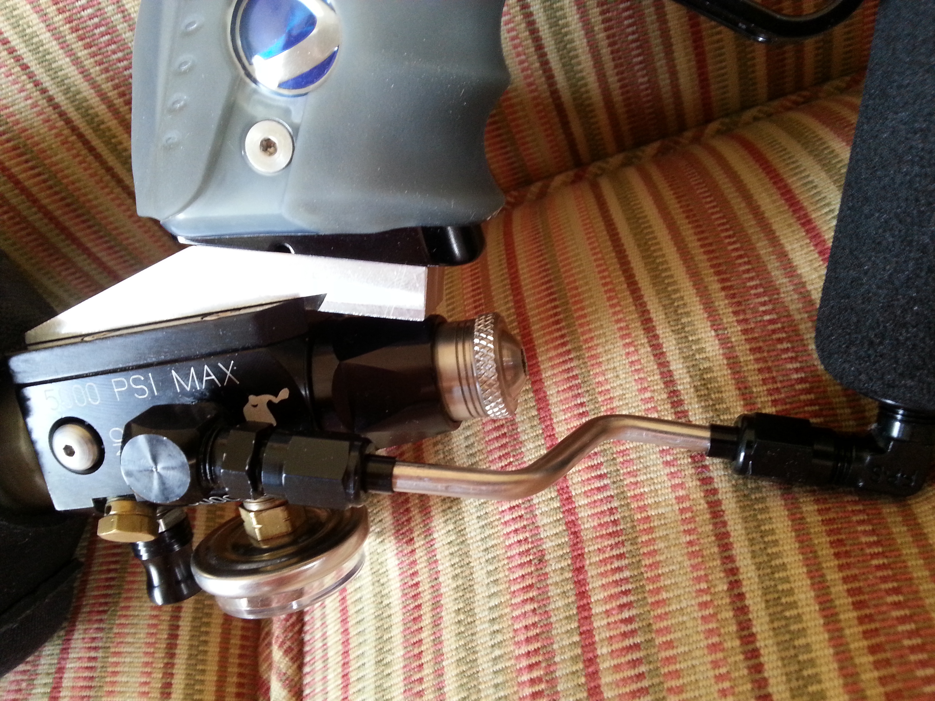

          • Levi
            • Feb 2023
            • 614
            I second shovelhead's advice. These are some I did. I ended up building my own bender because I couldn't find a reasonably priced small radius one.

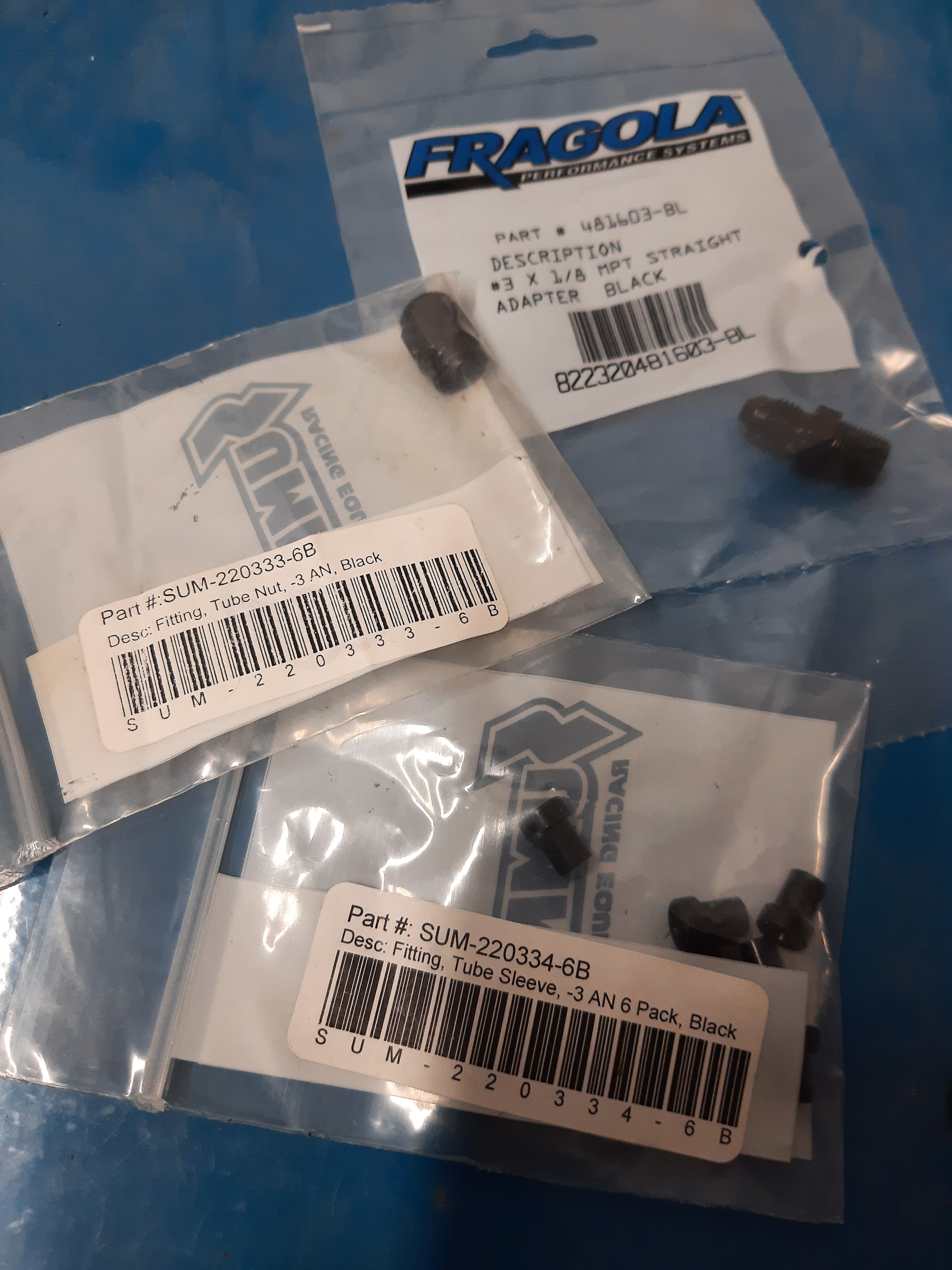

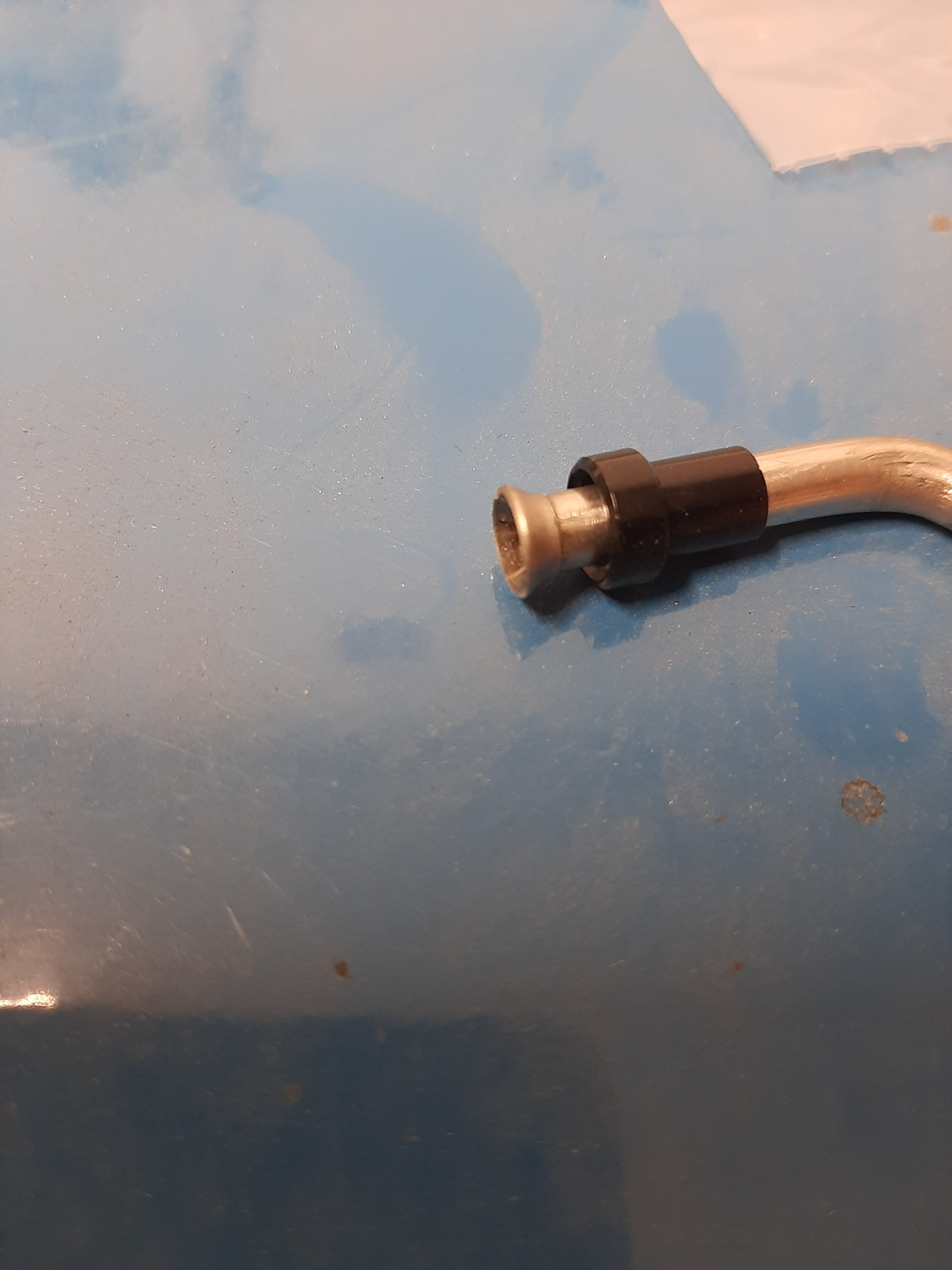

              Where did you source those fittings?

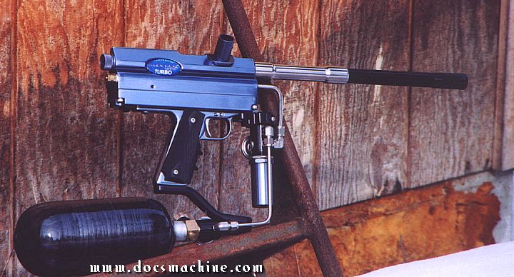

                Has anyone used stainless steel tubing and pressure fittings?
                [crochety old man] Since before you were born, sonny!
                Some of these date back to the 640x480 glass monitor days:
                (That's a 3K psi tank fed to the Max Flow.)
                How 'bout no fittings at all?
                And I was hardlining Phantoms before CCI ever offered a kit.
                Heck, how 'bout some coathangers?
                Now, the thing here is, as cool and unique as hardlines are- I installed a ton of them- for most players macro is cheaper, quicker to install, easier to repair when it starts to leak, and so on. Swagelok, A-Lok, Yor-Lok and others aren't really meant to be disassembled a lot. If you're careful and keep the sealing surfaces clean- and don't overtorque- they'll give you a good long life. But if you slap things on and off at the field, eventually you'll get slight leaks- which the typical player then tries to "fix" by simply tightening it harder.
                I tell guys they're enthusiasts' fittings- the kind of thing somebody who likes and cares for his marker and equipment will use. For the average player? Stick with Macroline.
                      Those are -3AN fittings. They are available from the performance auto parts places like Summit, Jegs, Speedway, etc. They are a flared fitting though, which makes for more work.
