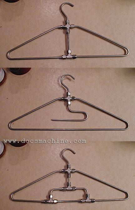

                [crochety old man] Since before you were born, sonny!
                Some of these date back to the 640x480 glass monitor days:
                (That's a 3K psi tank fed to the Max Flow.)
                How 'bout no fittings at all?
                And I was hardlining Phantoms before CCI ever offered a kit.
                Heck, how 'bout some coathangers?
                Now, the thing here is, as cool and unique as hardlines are- I installed a ton of them- for most players macro is cheaper, quicker to install, easier to repair when it starts to leak, and so on. Swagelok, A-Lok, Yor-Lok and others aren't really meant to be disassembled a lot. If you're careful and keep the sealing surfaces clean- and don't overtorque- they'll give you a good long life. But if you slap things on and off at the field, eventually you'll get slight leaks- which the typical player then tries to "fix" by simply tightening it harder.
                I tell guys they're enthusiasts' fittings- the kind of thing somebody who likes and cares for his marker and equipment will use. For the average player? Stick with Macroline.
                Doc.

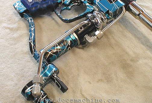

                  How do the „no fittings“ connections work?
                  -There's a threaded collar silver-soldered to each end. It's basically one big elbow. This pic shows it a little better:
                  It's all tricky to assemble, but once you're used it it, it's not bad. Kind of a pian out at the field, though.

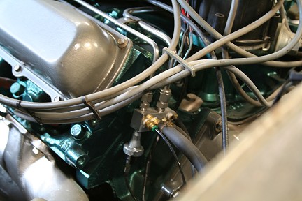

                  To fully instrument an engine for testing we may use dozens.
                  -Not the same class, but I used a bunch on my Olds:
                  Fuel line from the pump to the carburetor...
                  Manifold vacuum line, and along the lower edge of the pic, an oil line...
                  Both of which go to a "distribution block" at the back of the engine. That taps vacuum off to the brake booster, and has a tap for the vac gauge in the dash, an the other side of the block taps oil pressure off to another gauge, plus the idiot light sender.
                  The whole engine looked like this when I started putting the front sheetmetal on:
                  You can see the oil line right above the power steering pump, and some of the brake likes at the right are Swagelok stainless (plumbing in the proportioning valve, mainly.)
                  Doc.
