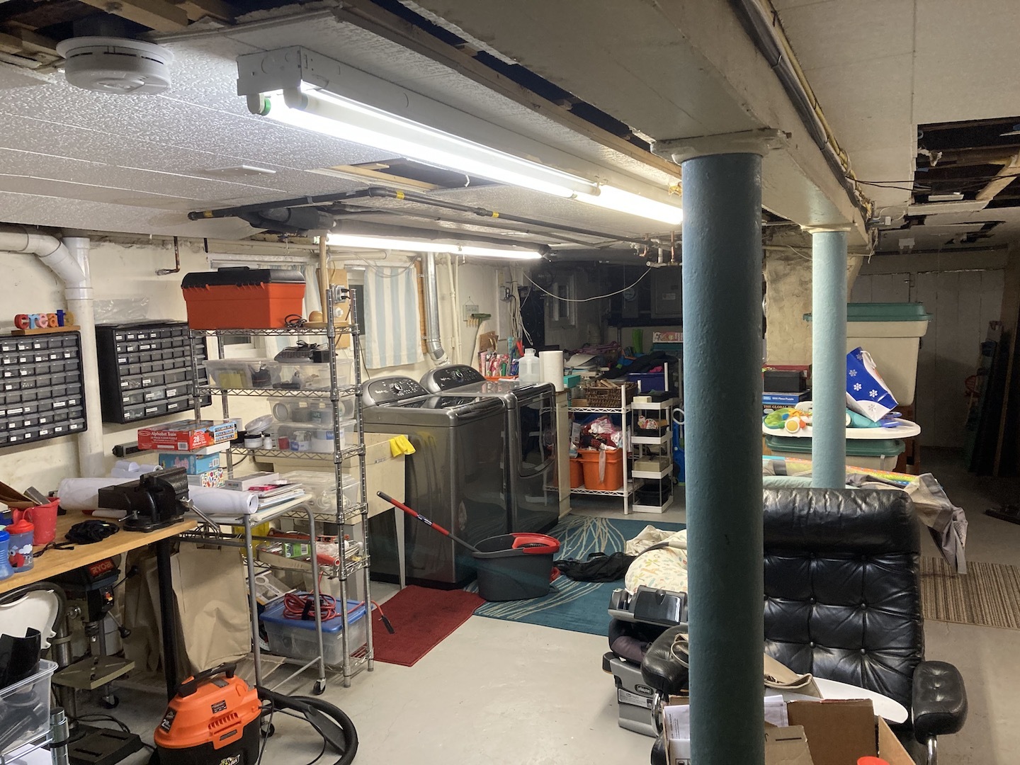

          Alright here's some pictures for everyone.
          First is an overview, you can see the general layout. between the two blue poles, you can see the chimney that runs all the way up and out. That's not used anymore, and all the ducts are blocked off. You can see some windows on the left, there are eight of those, but they're just a few years old and seal quite well. (You can see where ceiling tiles have been removed over the years to get into spaces as work was being done. For whatever reason, the previous owners installed fixed tiles rather than a drop ceiling, so doing work is a pain. We just get rid of them when we remove them, rather than fighting them back into place.)

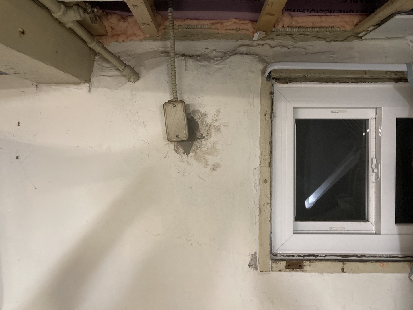

          Here is a wall. As you can see, it's concrete all the way up to the rim joist (recently insulated), with a few feet above grade.

            You can ignore the ceiling if your intent is to keep the basement at a temperature lower than the floor above it. In this case, the ceiling is actually a heat source for the basement. Probably cold for anything but carpeted flooring above, though.
            It looks like someone may have actually sealed that concrete already, as the color is one of the common tints for it; basically beige/"bamboo" and white. That's a win.
            I'd go ahead and frame the wall to the left in the first photo - at least. You have a lot of plumbing and electrical there that needs to be protected. You can then use fiberglass insulation instead. You won't need to add drywall, but at least add a sheet of plastic to add some puncture resistance over the paper. What you save on foam board you'll spend on lumber (and then some), but you'll have a lot better insulation (R-13 over R-5) and have to put in a lot more labor - with more tools involved if you need to save time. If time is no object, you can get it done with a saw, hammer, chisel, and hammer drill. A staple gun, rotary saw, nail gun (+ compressor) , and hole saw kit will cut down on time dramatically.
            If you don't use the windows, I'd create some removable insulated inserts to cover them. 8 of those windows is enough to address.

                Okay, so a bit of backstory to help everyone see where we're at: In May, we added solar panels, and the idea is to be all-electric. BUT! We had at the time an oil boiler with a hundred-year-old cast iron single-pipe steam heat system. And the plan was to replace that in 5-ish years with an electric heat pump system, and expand the solar setup at that point to compensate.
                But then last winter the steam system kicked the bucket. So we had to replace that this past year. But there was an unintended consequence: the boiler and steam pipes were keeping the basement warm, so now there's no heat source in the basement.
                So we've done some work to deal with this. We had the rim joists insulated (you can see the lower edge of that in the 2nd picture), and I sealed a crap ton of gaps and cracks and caulked around the windows to seal any and all gaps I could find.
                But it's still cold, and I think it's mostly because of the above-grade concrete walls.
                So we want to keep the place warm, but no gas, no oil, etc. If we're going to add heat sources, it's going to be electric. So the question it seems is insulation vs. a heat source, and it seems like insulation is the way to go. But ugh. More work.

                  Architecture student/residential drafter here.
                  It's not just the above-grade stem walls, it's all the stem walls. Insulating just the above-grade bits isn't going to be the solution, you need to insulate it all. It is certainly more work, but obviously just adding a heat source is going to be incredibly inefficient if you're dealing with this level of heat loss. Furring out the walls and adding some real insulation won't be the worst job in the world though.
                  You should also look at the windows themselves; I know you said you caulked the edges but in most old homes the windows might as well have a negative R value. Upgrading to a newer window system might be a good idea, especially if you're already doing all this other work.
