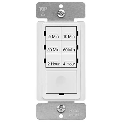

    I installed something like this in my bathroom for the sealing fan.
    We love it, its easy to control and see how much time you're asking for, digital so no "tic-tic" of the older mechanical style ...
    PS: I have no affiliation with this or any other electrical equipment (that's why i didn't put a direct link, but you can find them easy enough everywhere ...)

      I meant to add in for 12-24 hour timer.
      XEMON commented
      They also make them with higher intervals.
