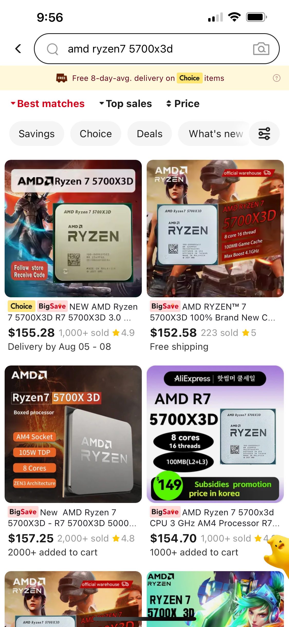

          How are Chinese sellers on AliExpress able to sell the 5700x3d 25% (+-) cheaper than everyone else?
          • jetenginekyle
            jetenginekyle
            commented
            they could be used or fake? maybe they get ya on shipping cost
          • latches109
            latches109
            commented
            bad bins - avoid

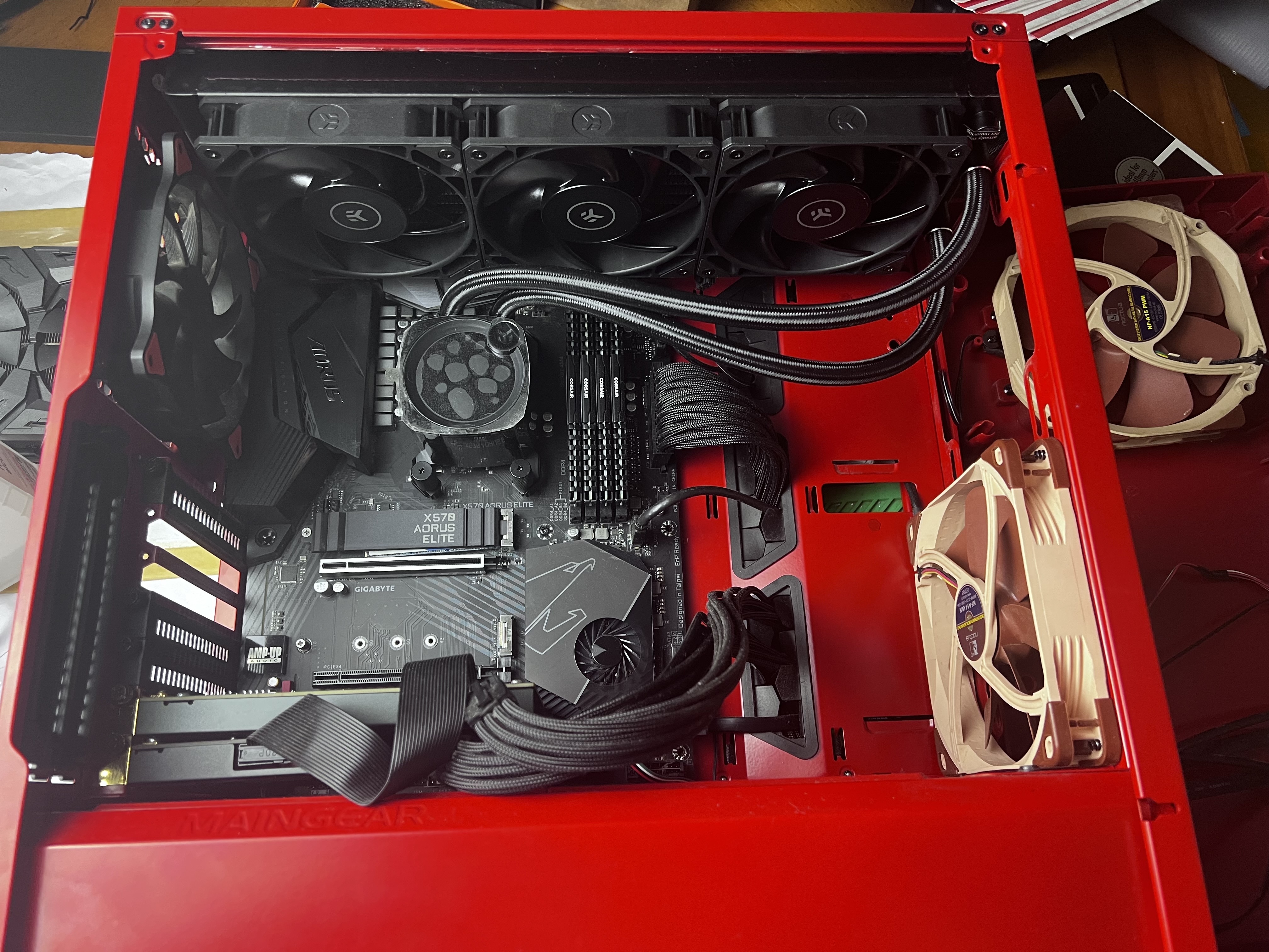

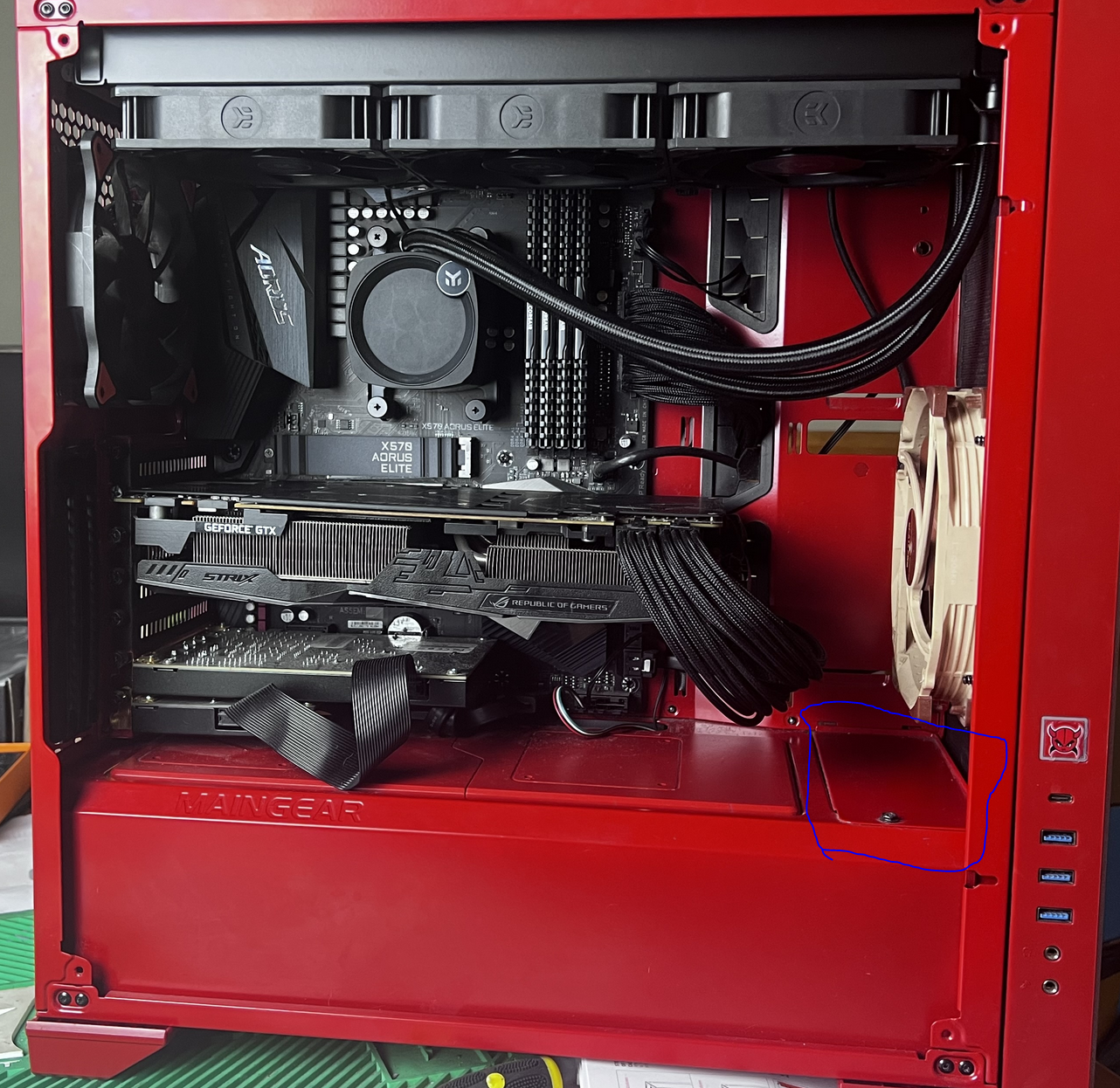

          it fits, I had to sacrifice one of my front fans but I think that’s normal for a mid tower
          • jetenginekyle
            jetenginekyle
            commented
            Looks nice! the sleeved cables are a nice touch

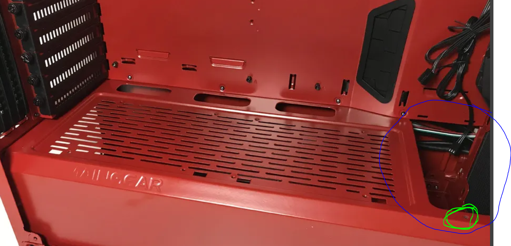

          Remove the circled panel and you should be able to get the second fan to fit. Also right now your fans are setup such that you have negative pressure this will increase the amount of dust the computer collects. Id recommend flipping the rear exhaust fan to be an intake would provide fresh air for the rad and help balance the pressure.
            Click image for larger version  Name:	image.png Views:	0 Size:	2.22 MB ID:	572987
            Ok, I’ll flip the rear fan. That sounds like a good idea. That 120 Cougar moves a lot of air.
            what do mean remove the circle panel? The fan enclosure?

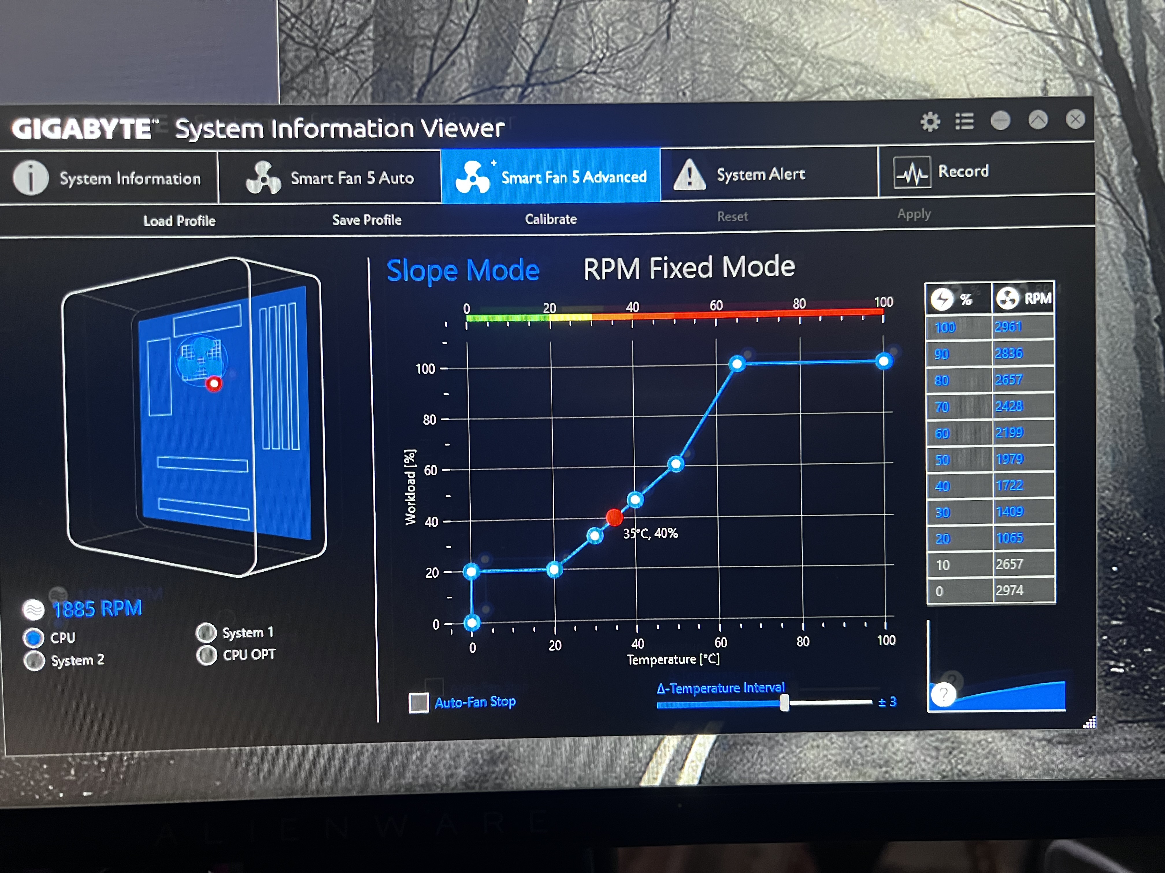

            Regarding the fan settings, the pump should always be max/ 100%, correct? And the radiator fans can be curved. Any tips for curvature?
            also, I have 32 gigs of 3200 MHz Corsair RAM, and according to the Gigabyte app they were set at a default of 2400 MHz this whole time, so I set it to 3200. Now I wanna see if I can overlock it, maybe give the voltage a little boost.

              Oh wait you circled it in the pic, hmm let me see if the fan can move down into the cavity a little.
              I have both the rear and front fan connect To the same pwm controller in the back of the case, but i dont feel the Noctua moving any air even if I set it to max. It’s 150mm air cooler fan i used in my previous build. I think im going to swap it for the other Noctua AF-14 (3 pin)

            For best performance :
            Set fans to static 100%
            Tun a stress test for about 10 min to reach your max temp
            Turn the pump speed down ~10%
            Let stress test continue for 5 min
            Check temps if they increased,
            Repeat until temps go up when the pump speed is dropped
            Or just turn it down until you cant hear it anymore, thats what i did

            The small rectangle cover can be removed, looks like its just one screw. You should be able to fit the second noctua with that panel out of the way

              "i dont feel the Noctua moving any air even if I set it to max. It’s 150mm air cooler fan i used in my previous build. I think im going to swap it for the other Noctua AF-14 (3 pin)"
              Make sure you dont have the low noise adapter going to the noctuas. will look like a splitter or maybe a short extension for the fan cable. Its a resistor to reduce the power going into the fans to make them much quieter by reducing the speed.
              will look something like this

                Haha good call! i do have it installed. I guess i didn’t notice t wasn’t moving air before because i had it right below the other fan
              • the_matrix_guy
                the_matrix_guy
                commented
                I removed the low noise adapter. In regards to the rear fan, however, it started making a vacuum noise when I flipped it. It’s interacting with the radiator fan. If I move it just a little bit lower— it stops making the noise but then i cant screw it.
              #25
              "In regards to the rear fan, however, it started making a vacuum noise when I flipped it. It’s interacting with the radiator fan. If I move it just a little bit lower— it stops making the noise but then i cant screw it."
              Maybe put the low noise adapter on the rear intake fan? Though at this point I'm sure you've had the computer put back together for a bit and would rather just use it.
