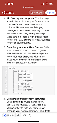

        Documentation and meta data file management will be your issues. I’d suggest creating a file structure on a portable harddrive and then pull albums from that master archive onto your thumb drives.
        The biggest issue I ran into was file management. After like 500 albums you can’t find shit.

          Regardless the OP owns media in CD format and wants to rip that media so they have it (since CDs are perishable) and have the ability to play their music in their car. With both Power2Go and EAC you can easily set up your meta tags not a hard thing to do and a lot of instructions and recommendations out there. They'll ever grab and add meta tags from various databases out there. I have over 400 albums of music files and have no issue finding the music I want at any time. Hell I keep lossless versions of all of my music on my phone.

            I just used windows media player for part of my collection with few problems. As long as you’re connected to the internet it can look up most newer albums and automatically name and sort the files by band/album/song.
            the big problem I ran into was after a couple hundred cds (mileage varies) media player wants to put everything in the same folder. You can manually tell it to change and it looks like it did but when you open the settings box again it has gone back to the original selection. I’ve had it happen on two separate laptops. None of the suggestions Ive found online work, not even a reinstall of media player. At that point I switched to nero.
            second issue I had was that I need multiple thumb drives in my car. My radio seems to run out of memory for file names. If I put everything on one drive my car can’t see anything past bands that start with “N.”
            3rd issue is with audio books. If you’re using the auto naming previously mentioned, regardless of software suite, the publishers like to use a different naming convention on at least one disc so that it is filed away under a completely different folder somewhere else in your collection. For instance discs 1-5 and 7-16 go into c:\frank herbert\dune\ but disk 6 goes to c:\penguin publishing\dune\herbert.
            4th more of a side note from the op question. Thumb drives in my car seem to be okay with just adding a new disc or two but the sd cards in my mp3 players require me to completely rewrite the sd card to get a new album to show up. Sometimes just adding one file corrupts the whole file system and I can’t use it again until I rewrite the whole thing.
