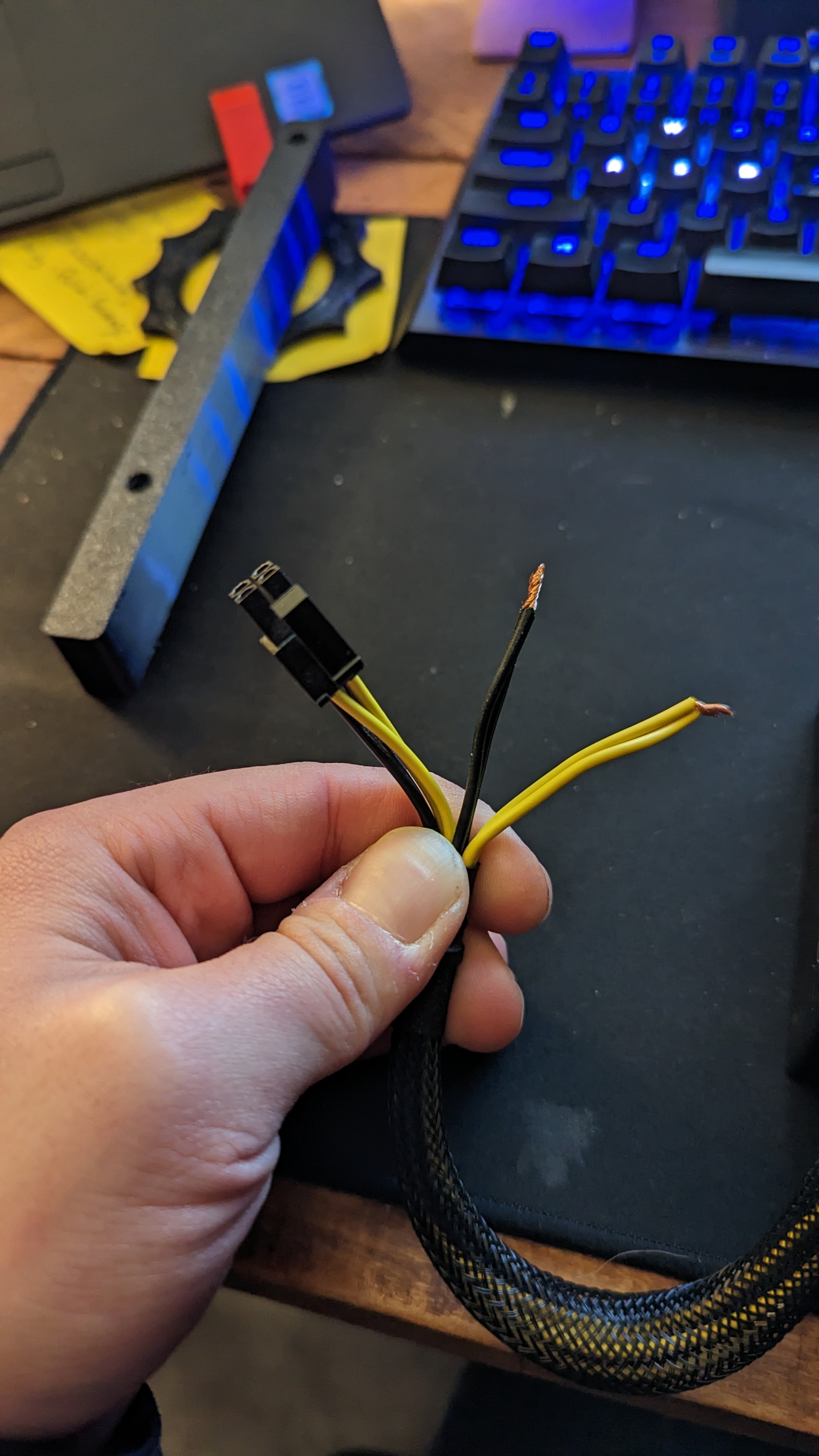

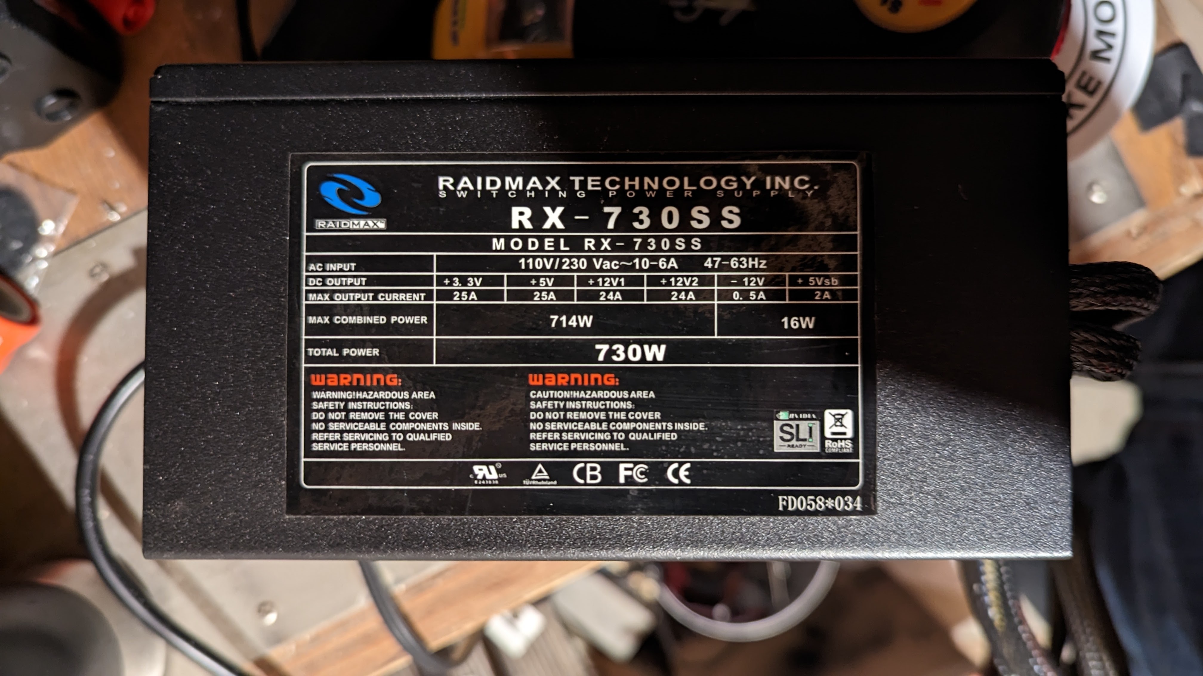

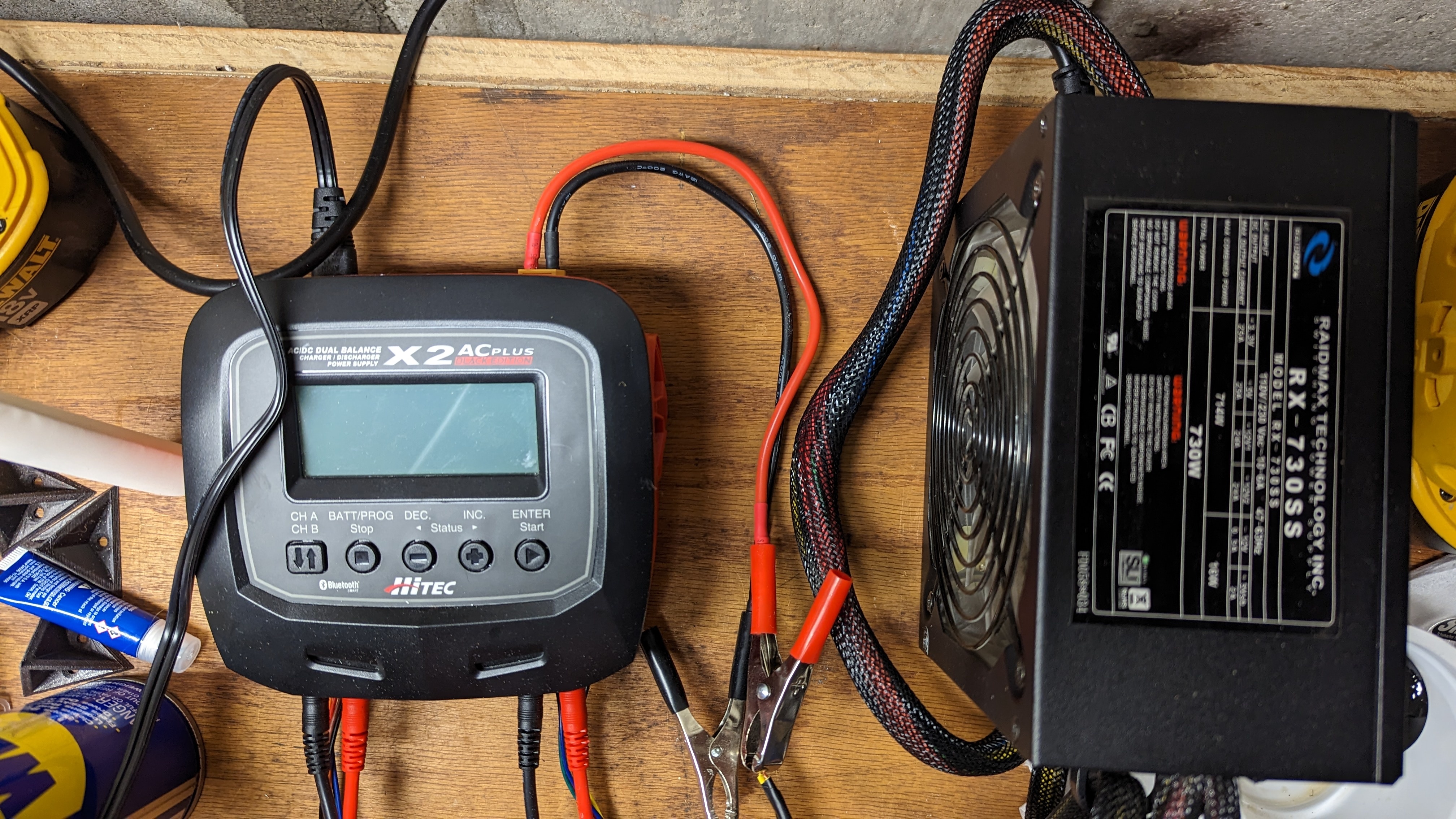

    I'm trying to use an ATX power supply with my HiTec charger so I can get more amperage via the DC 12v rail. I'm grabbing power via one of the 4-pin connectors (showed 12v), but once the charger starts to pull around 8a+, it kicks out a 'low dc input' error. Both of the 12v rails on this PSU state they're 24a, so I'm not really sure what I'm doing wrong here (other than my currently janky connection to the wires).

    If you only pull out of 1 of the 2 rails you'll create an load imbalance and the PS won't be able to put out full power.
    the solution is to put a load resistor on the other leg 👍
      EDIT: I believe I just need to add a 10W/10Ohm sandbar resistor to the 5v rail?
