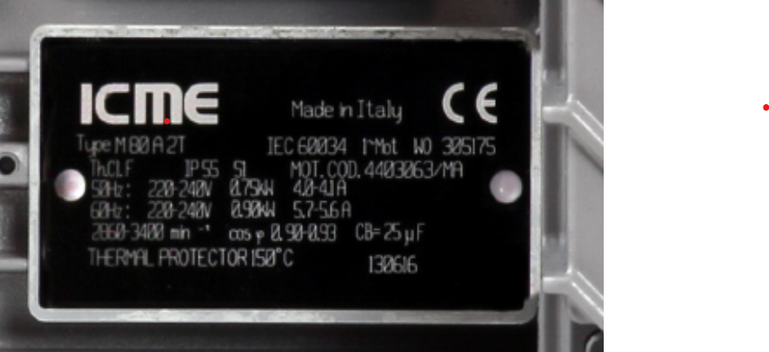

      heres a pick of the motor plate
      for the visually impared
      at 60hz 220-240v 0.90kw 5.7-5.6A is the relevant info i think

        so... can throw a 3 prong 220/30A plug on this thing and hook it up to a standard 220V single phase circuit and expect it to run fine? i did talk to tech support in england and they have sold a few of these to US customers who got them to work, but did not know the specifics

                Make sure you get single phase - it'll have some capacitors the size of a shot glass sitting on the motor, usually. It doesn't specify on the spec sheet, but I'll guess that's their default. The q&a also says they'll supply a US plug as long as you confirm that it'll be on a 220v circuit.
                It's about as much power as a small table saw. A typical shop "paddle switch" from Rockler or Powertec would be a good investment.
