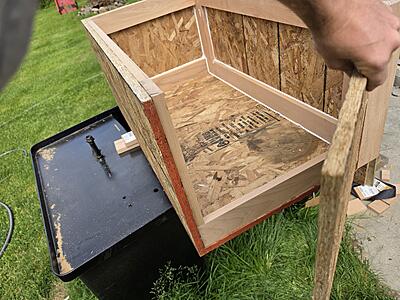

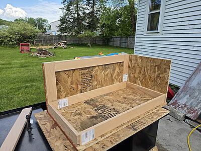

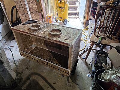

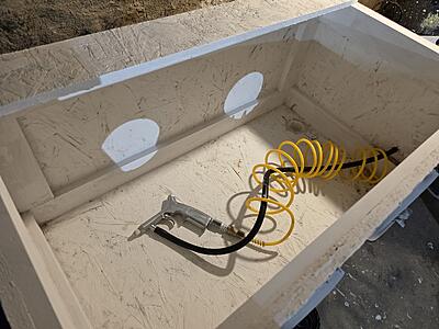

    Well I need a cabinet for so many reasons, it doesnt even make sense for me to not own one at this point. I could have went to Harbor Freight and grabbed one ready to go for $229 + tax, but they arent even in stock.
    So here we are again with another DIY project. I had just enough of this subflooring scrap laying around, and a bunch of leftover planks from building a kitchen island. Dont judge me to harshly on the box itself, I kinda changed the plans that I didn't make halfway through. I went from side door to top lid for ease of use. I just need to go to hit the stores for the clear panel, the gloves and clamps to secure them to the rings, a pair of hinges, and a filter for my catch bucket. I'll probably add a light inside as well. Total is about $75 including lights. I'll also be painting it inside and out. And I also have to dig through my scrap pile and find some kind of plate/grate for the bottom so my parts are elevated slightly from the bottom.
    This gallery has 3 photos.

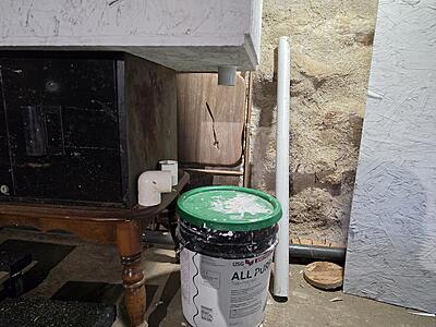

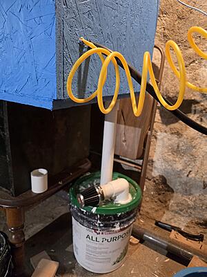

        So here's my plan for the outlet / reclaim side. Pvc pipe to a bucket with an outlet with a filter. I also plan on adding more ports and more buckets for different types of media later. So I use one, sweep it all down into its port, plug it and open the next port for the new media. I can essentially keep adding buckets and media types as needed. Then later I can filter and reuse old media.

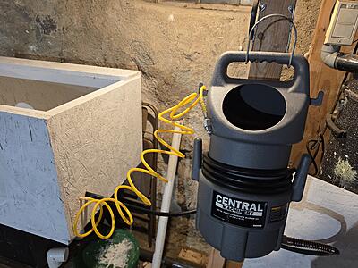

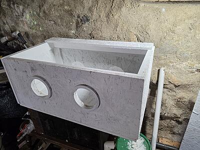

          I robbed the crappy coil hose off my old compressor, and got everything plumbed. I probably should have finished painting first, but I can paint around it.

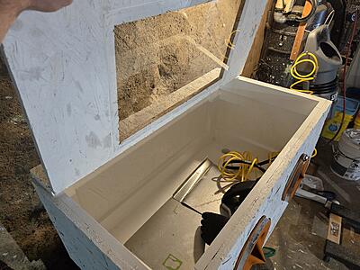

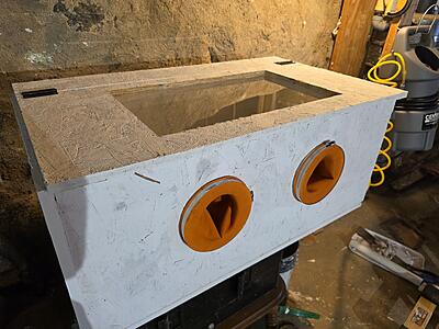

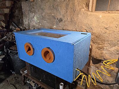

            Just about done now. Just needs a gasket around the lid I'll use these $9 gloves for now, but in the future I'll probably upgrade to the $30 gloves for a little more reach inside. I'm just waiting on the lights to come in tomorrow and I'll finish the catch bucket later today.

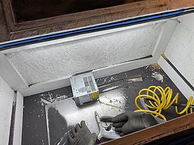

              It works perfectly.

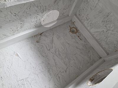

                Keeping with the low cost theme, I am using this leftover paint from my kids bedroom. It almost looks like proper shop equipment now.

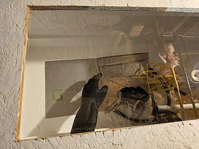

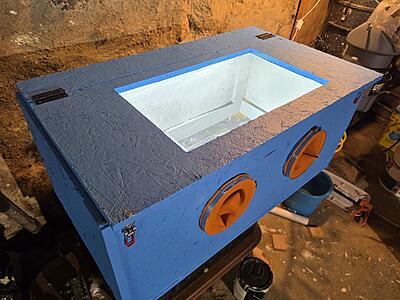

                    All done. I added some $6 latches to the lid to really seal it up.
