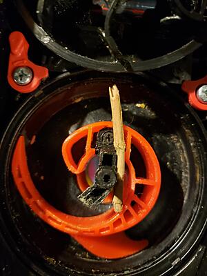

                Got Bork?
                  • 3415
                  Gotta watch out for them trees though, rotors dont make good mulchers. I recall coming off of the field SO pissed that my rotor wasnt working and I found this. Couldnt help but laugh, and snap the pic.
