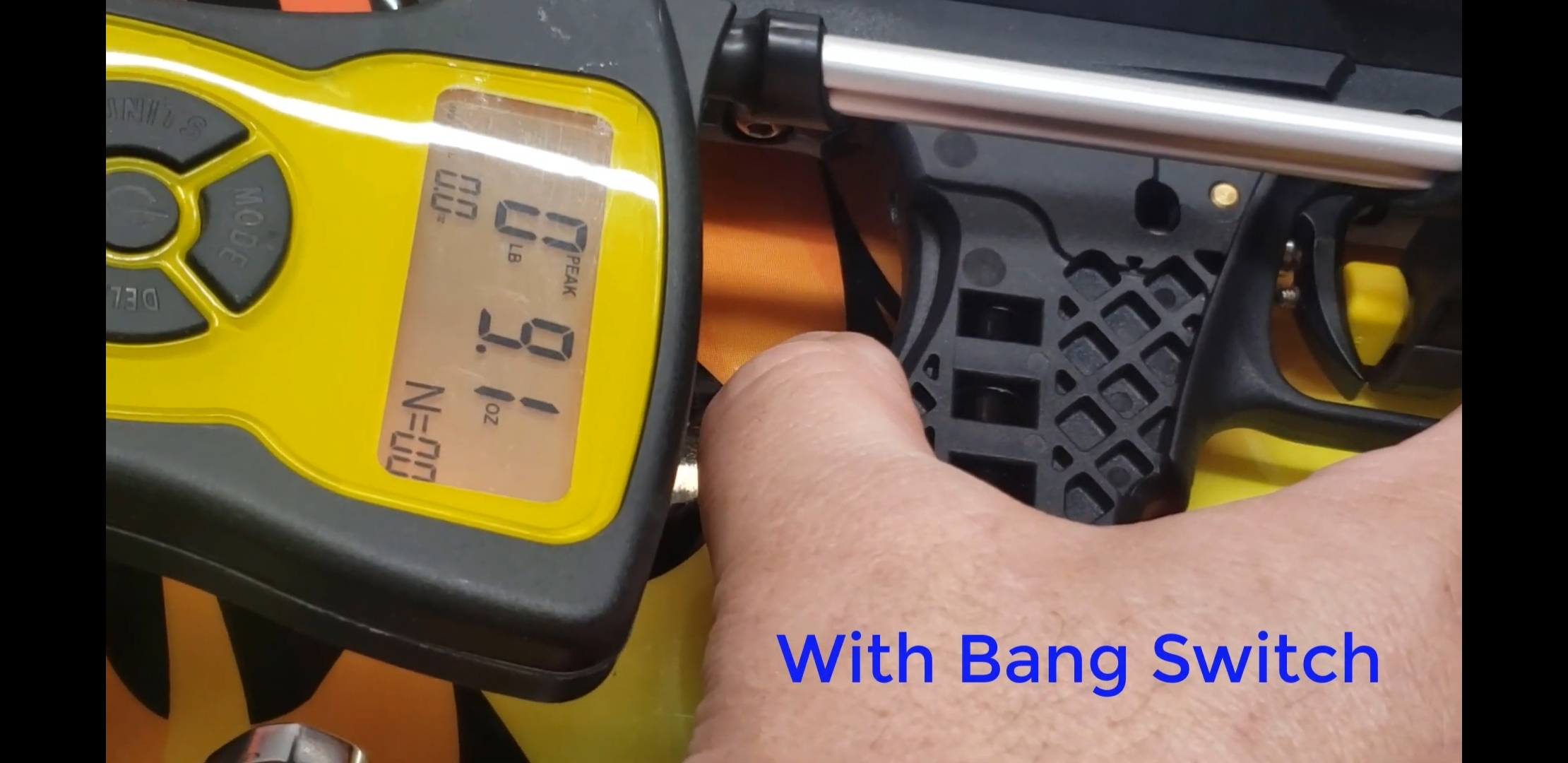

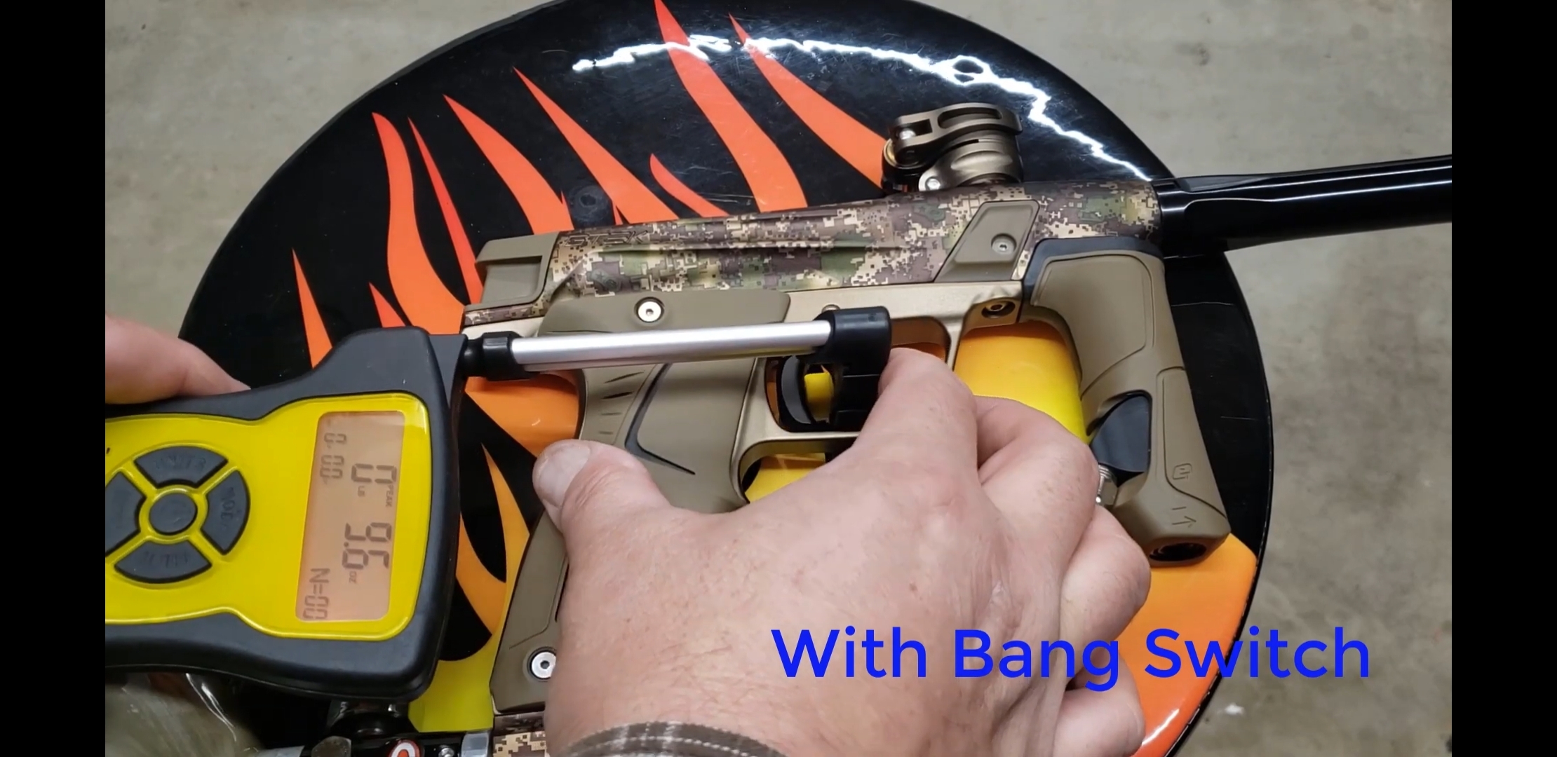

                          Here are some screen caps from docfire 's video about the Bang Switch. It definitely does lighten the trigger a bit.

                          • Bow
                            • 229
                            • LV, NV
                            I had one and liked it. I have since given it away and much prefer the Hair45. It did make a difference though, with an adjustable trigger you could really take advantage of it, but in a marker with a bone stock trigger you probably won't notice it.

                              • 6287
                              If you are not changing out the trigger for an adjustable one the pen spring mod will give you a similar feel. The bang switch shortens up the throw but you really need an adjustable trigger to take full advantage of it. IMO
