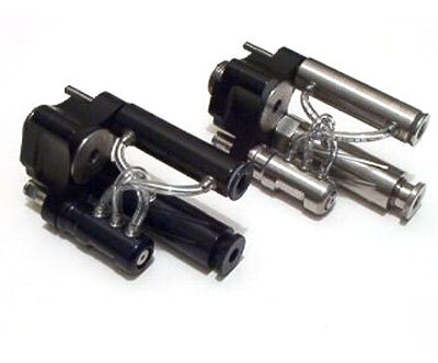

        Anyways, I tracked down a cocking rod, front block, and LPR. Any ideas on where to look for the 3-way and ram?
        And found a picture of the pneumatics kit Evil apparently once offered...

          The evil 4-way was the only one in paintball.to use -002 o-rings instead of the standard -003. #FunFact
          Also, evil barb's suck, they are super short, however the front blocks were I think the most cut down/lightweight blocks offered.

            Do the smaller O-rings translate into any tangible results... less friction due to less surface area? Higher pressure due to less surface area?
            Either way, thanks for the tidbit of information. Always welcom, and appreciated.

              Looks like they used a fairly large diameter ram housing too. I wonder if this is kind of like the "gentle touch" ram that Inception makes where the aim was to lower the closing force of the bolt.

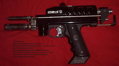

                Wasn't Evil in bed with PMI for awhile? Didn't PMI produce a few Autococker right feed bodies back in the day? Would it make sense to combine these?
                I know it doesn't matter what pneumatics go on what body, really, but in the name of keeping everything as Evil as possible...

                  Yeah I think that be most "evil" way to do it . Also ive never seen a pmi body cocker so that Be cool. And everything else be evil parts.

                    This gallery has 3 photos.

                      It's not so much that Evil was "in bed" with PMI so much as they were subsidiaries of the same parent company.
                      Just so you know, Evil pneumatics are generally considered among the worst pneumatics ever made. I'm not entirely sure if the smaller o-rings or the barbs are a factor in that, but I'd assume so. The barb issue should be easily rectified with some hose locks. The ID version is pretty innocuous, way less noticeable and easier to use than the old top hats. In theory the smaller o-rings would translate to faster switching distance. The ram diameter doesn't look any different from an STO, it just looks fatter because it's shorter. The ID ram achieves its "gentle touch" by using a fatter ram shaft, meaning there's less surface area on the piston.
                      And as a random fun fact, the PMI cockers were ghost built by BBT.
