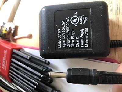

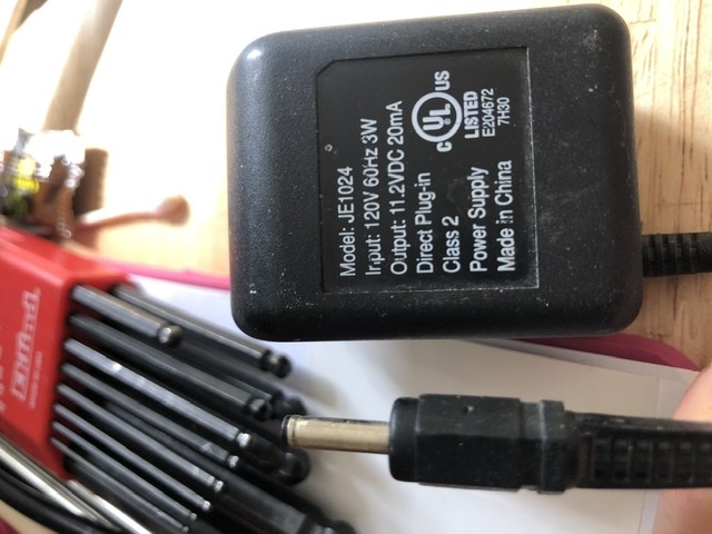

                  • 567
                  Here’s what’s on my old charger. The jack OD is 3.5mm and 12mm long. The ID seems to be 1.5mm. I bought these batteries from ANS https://www.ansgear.com/Tenergy_Valo...96valorkit.htm
                  Good price and better batteries than the old Spyder ones. Comes with a charger too
                  Click image for larger version  Name:	6344633C-0AFC-4C6A-9577-F2058A20E98C.jpeg Views:	0 Size:	87.0 KB ID:	135375
