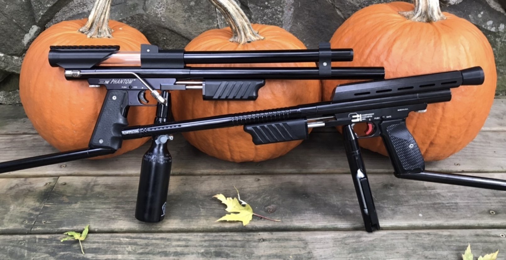

              Click image for larger version  Name:	C864AC29-48D2-48FD-83D8-1816B553FED3.jpeg Views:	0 Size:	1.12 MB ID:	137440 Give you an idea of size.
              This is the MAX Tac 9ci but the Tippman is almost identical and comes powder coated instead of painted finish on the Max Tac. Tippman is also Substantially cheaper and the finish is more durable (however it is covered in warning labels). I run a Max Tac only because the Tippman wasn’t available at the time. The Tippman 9ci is a better bang for your buck. This is the way.
