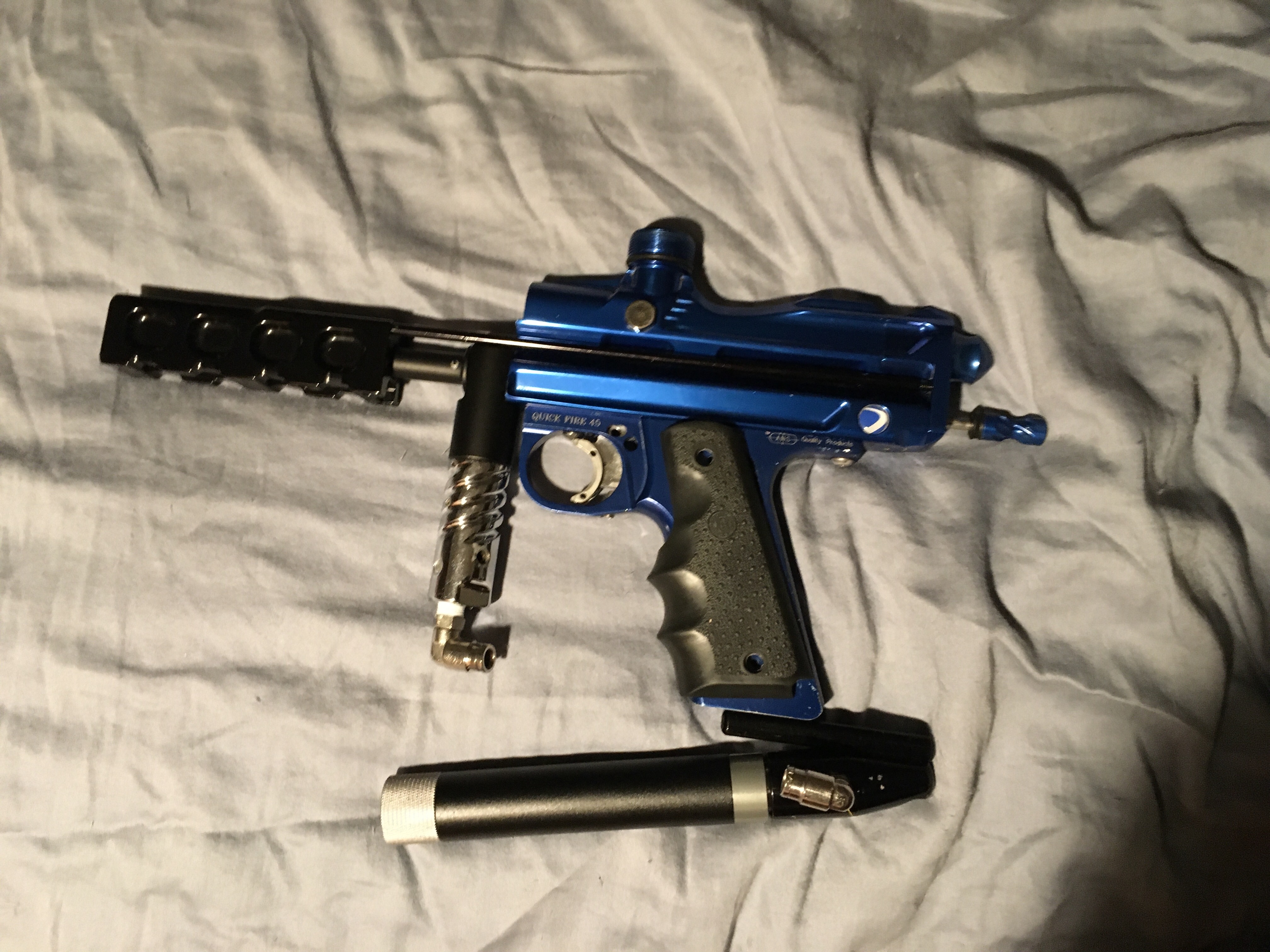

                        Thank you everyone for your help. Here’s a picture of what will be my Sniper Ultralite. I ordered a braided stainless steel hose to replace the macro line. D47CCBF6-22F1-472F-83AD-0D164F5395F5.jpeg
                          • 4511
                          Cool build! I would recommend a different HPR, mini-regs are notoriously janky.
