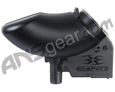

    I thought ans had replacement empire shells last I looked so you may be able to just replace the shells cheap enough.

        Didn’t know they had shell kits! That’s a bit steep though when you can get complete working loaders for $25-30. Maybe I’m just a cheapskate though...
        BrickHaus commented
        No, thats steep. Lol
