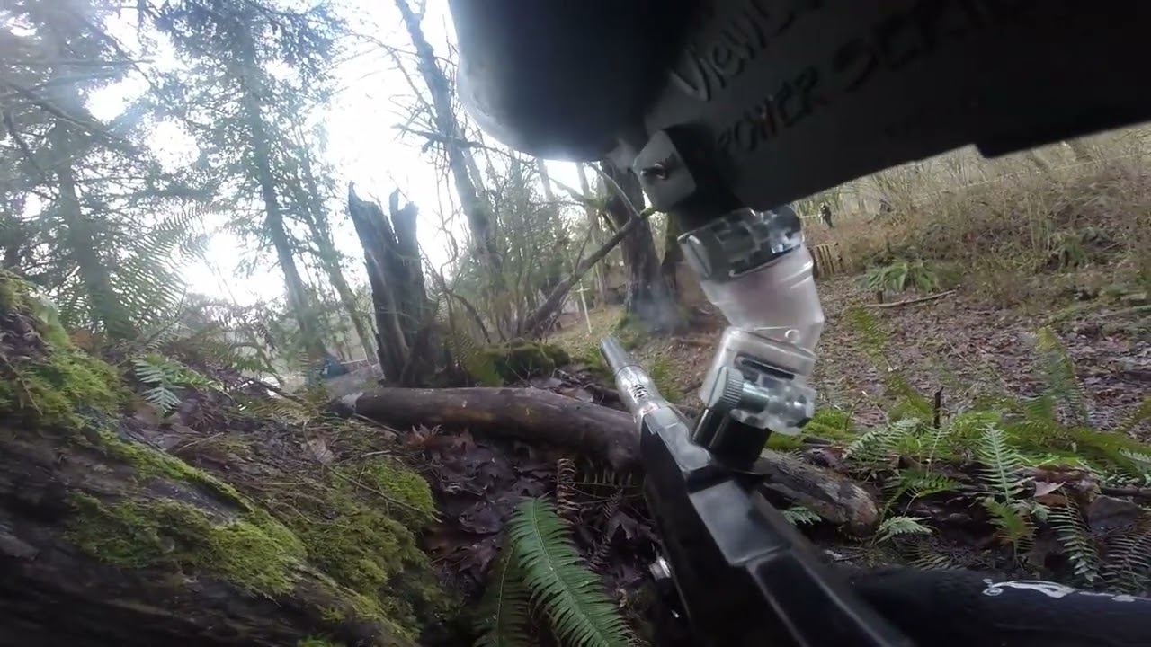

          So, I know it has been a few months, but I figure I might as well update this for anyone that searches too. The performance is kind of hard to explain so here is a video of it with a clear elbow so you can see when it is and when it isn't loading
          As you can see, sometimes even a decently quick string of paint has it filling the elbow pretty quickly other times it takes a weirdly long time to get any paint back in the elbow. If I had to guess I would say the hopper performance is greatly tied to how much paint is in the hopper.
