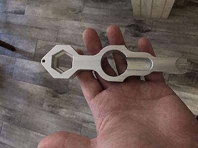

            I don’t put any thread locker on the tank reg just torque it down good. I got this cool tool I snagged for removing and reinstalling them. Before I got the tool I use to use the crook of a tree in my yard. lol

              Which company made that tool? Looks like it’ll work on both co2 tanks and HPA regulators.
              Honestly I’m not sure maybe CP back in the day.
