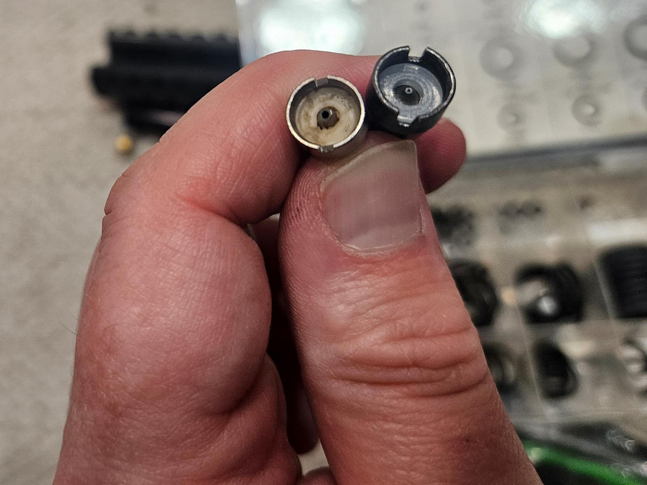

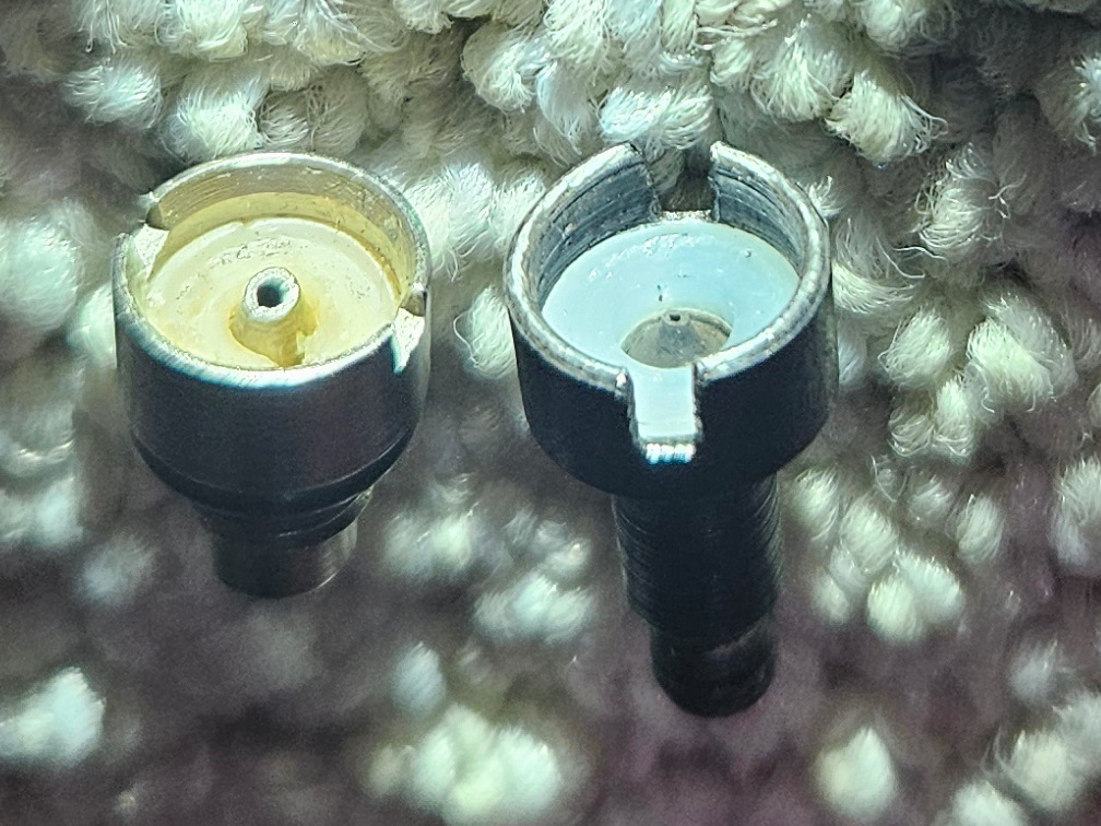

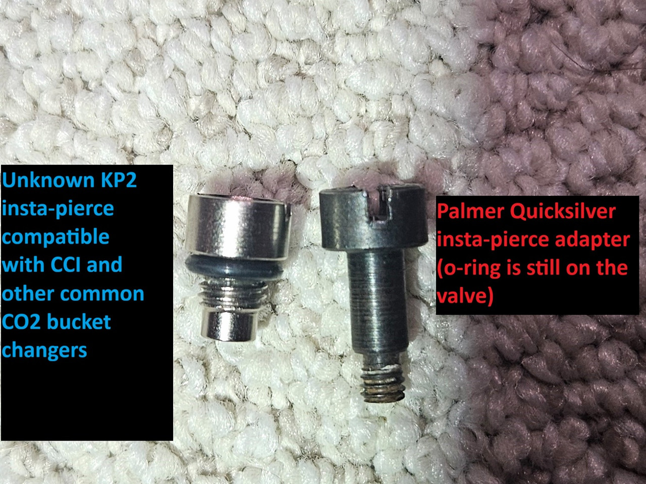

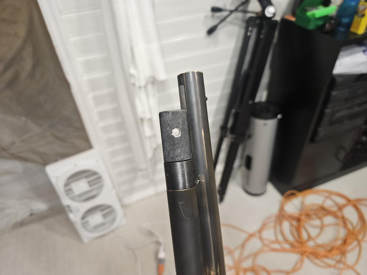

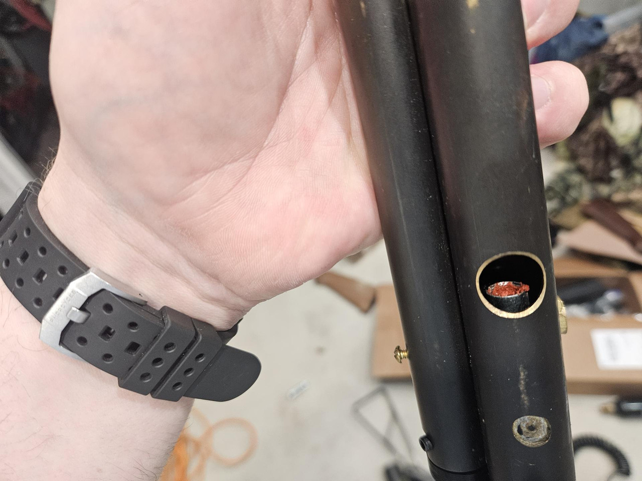

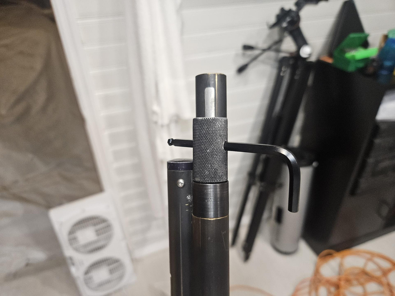

              Old thread but I wanted to chime in.
              My KP2 came with an insta-pierce and a coarse thread fast changer. After I had JeeperCreeper convert the gun to springfeed and shorten the lower tube, I had a real problem getting the cartridges to seal. I don't recall if there was a seal of any kind in the adapter, but Jeeper tells me there wasn't one, but with the knob no longer sticking out from the front of the gun I couldn't put enough torque on the knob to get the cartridges to seal up. I tried using a cartridge seal from PGP Junkies, but it was very thick and wouldn't allow the carts to pierce at all, or if they did it was a tiny pinhole which wouldn't allow proper use. I tried a couple other solutions, like using small O-rings, or covering the front of the cartridges with plumber's tape to have their own seals, but nothing seemed to work. What ended up working for me was to create my own seal with red RTV sealant and to crossdrill the knob so that I can use an allen wrench on the field as a tommy bar to really torque it down. Maybe not the most elegant solution, but it worked.
              I've recently acquired a very early PPS painter rifle with a Quicksilver conversion. After rebuilding the gun I can get it to seal up and shoot very well using a dummy cartridge and a remote line, but haven't had any luck getting cartridges to pierce yet. I put an Extreme Velocity Phantom urethane seal in this one's insta-pierce, which is thinner than the PGP Junkie's seal, but I still can't get the carts to pierce reliably.
              One thing I've noticed is that the pierce knob assembly on this one is very different from the one on my KP2. Its pierce knob is compatible with the same sorts of pierce needles that are used in most modern CO2 bucket changers, including CCI's. The older Palmer conversion, however, has a much thinner stem and finer threads, and I'm curious if anyone knows where I could maybe get a replacement for this part with a sharper or longer needle. Barring that, does anyone know how to adjust or tune a Quicksilver changer to put more force on the cartridge?

                    Old Nelspots used a needle, no elastomer. The cart sealed around the needle well enough. (If they ever broke, the things were hard as diamonds to drill out.) The newer ones were 8-32 threads. The CCI pins are 1/4-28.
                    Some people have successfully used CCI pins without a seal in an emergency. The newer EV pins are, frankly, a little rough looking to try. I have some that are a closer match, both port size and surface finish, to the old CCI pins.​
