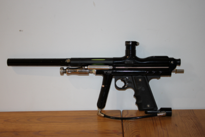

    Here is my gun, if you are looking for ideas. I went the Tech T LPR adapter nut route. I also wanted the SF model to get the threaded STO feedneck. I was pretty happy when I found one with feedneck already upgraded to CCM (my fave feednecks!)

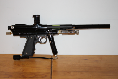

      Here is my current upgraded trilogy build
      I also bough a ID 11/16 valve that look to be a good option (not tried yet)

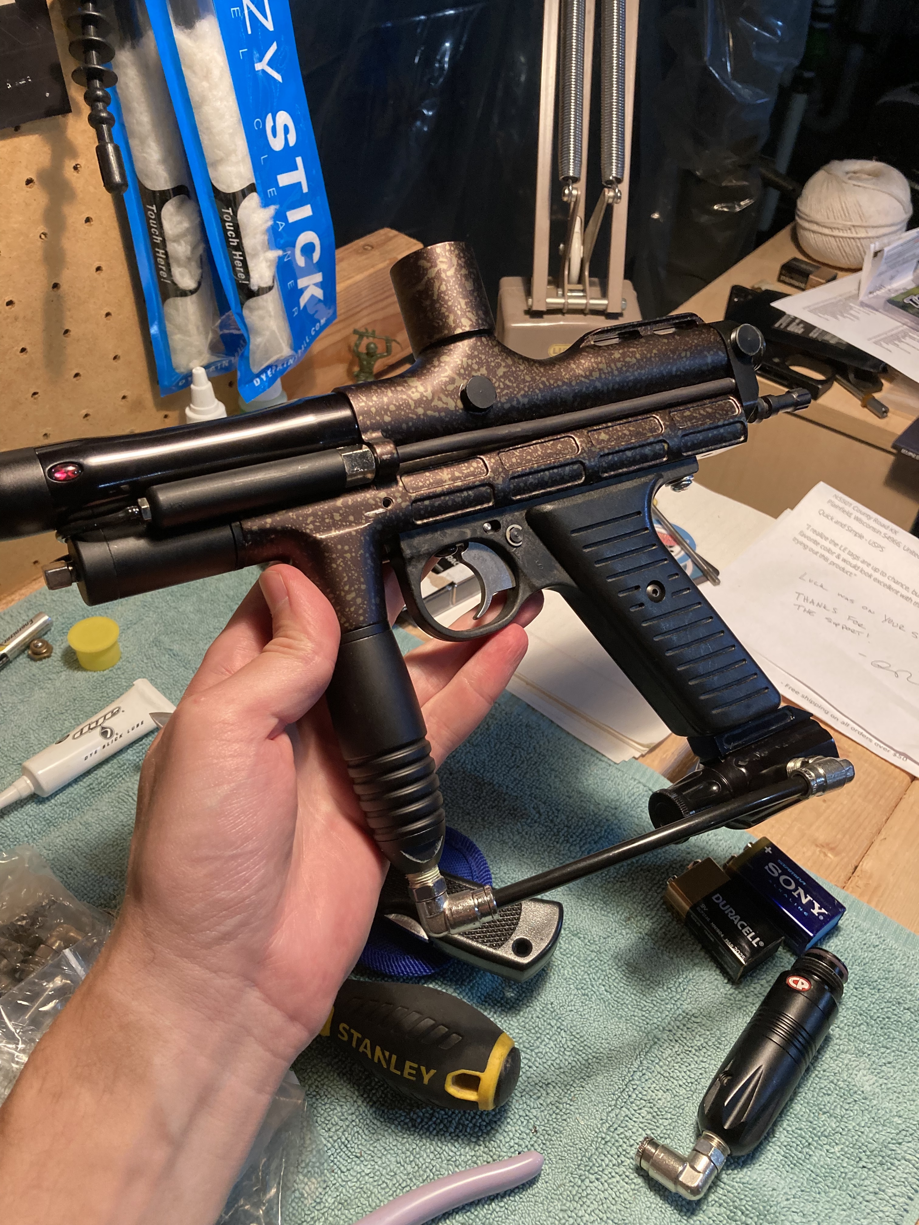

        I'm slowly building up a Trilogy Tactical myself. I went for the barrel first. Added a AC Parts Spine bolt and TechT delrin backblock to reduce the reciprocating mass. Then I picked up an ACParts cocking rod with the hex on it for changing velocity without a wrench. This past weekend I put a slider frame on it. Next on my list is probably a clamping feedneck mod (mill down the neck to a stub for a clamping one). I'm not sure I'll even swap out the regs & springs. If I do, I'll probably keep the factory HPR and go with a Palmer's Micro Rock.
        IMO I'd go for the other stuff before messing with regulators & springs. Unless you have a Sport model.
        EDIT: Picture of mine so far.
