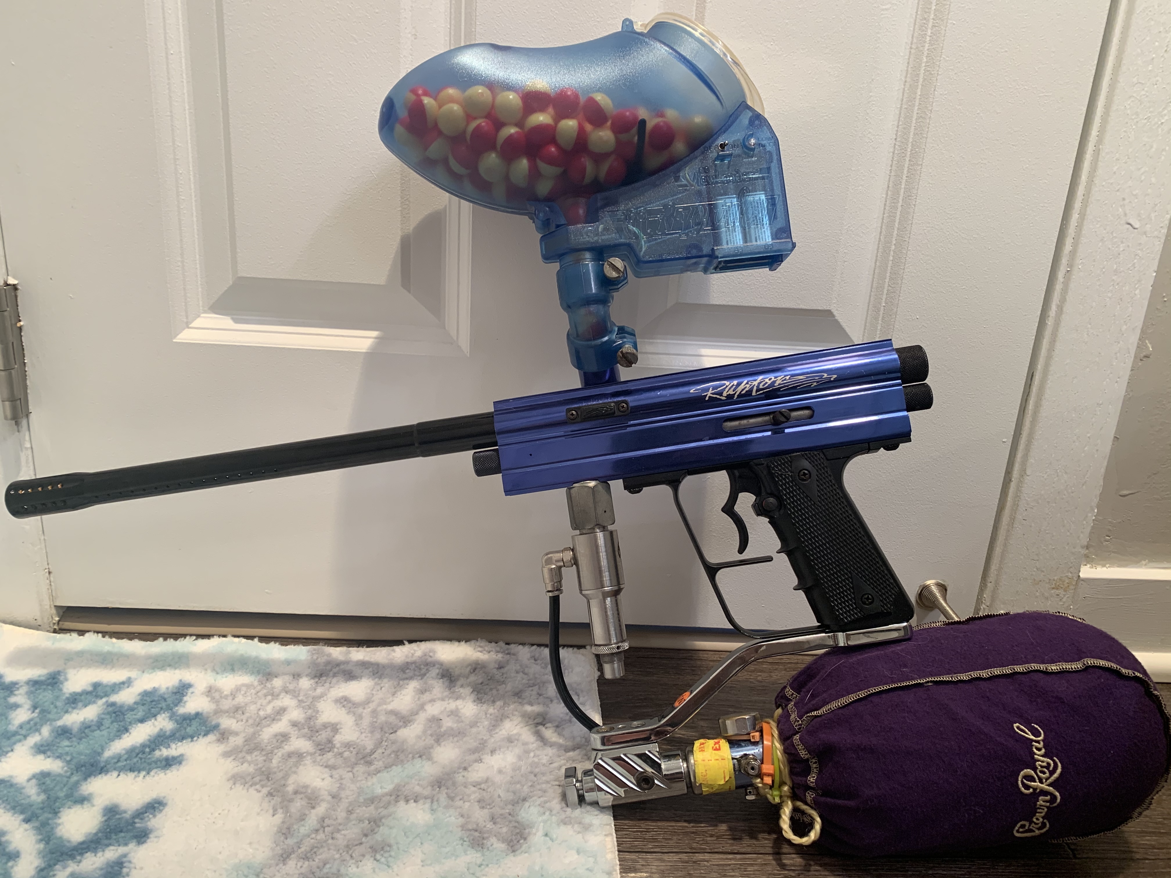

          I used an old air America unireg i gutted on my be raptor. It had just Stock internals and it would still chrono pretty consistent above 270fps
