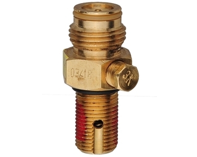

            I thought this design shown here was the reason newer valves could not be used for Siphon tank applications? That groove and extra input hole would allow gaseous co2 to bypass the siphon tube was my understanding.
            https://paintball-online.com/valken-...ank-pin-valve/
            4000+ paintball guns, markers and other gear from Tippmann, Dye, Kingman and more.
            • Chappy
              Chappy commented
              Yup these need to be avoided. No matter what you put below that valve it’ll just suck gas through the side

              If the safety groove has a hole the goes though the stem then it will bypass the siphon and just suck gass through the groove. If it does not have the hole all the way through the groove then it will work.
              Another issue with some more modern tanks is they are not all 1/8” at the plug.
              • Meleager7
                Meleager7 commented
                Ok cool, I didn’t know the grooved valves come in two versions, one still siphon tank friendly, and the other not. Good to know!
              • Chappy
                Chappy commented
                Unfortunately the one you posted above is the most common and does not work. I typically find the old ones and use those. I have seen grooved valves without the holes but they are rare in my experience. Much more common to see the hole without the groove but they stopped doing that since thread raked can block it.
              -Odd, I'd never seen that particular style. All the ones I ever dealt with with a groove, said groove was just on the outer threads, about 2/3rds of the way up, with no hole.
              But yes, you're exactly correct- that style of valve would not properly work with a siphon.

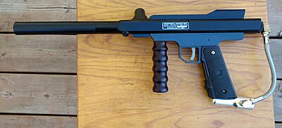

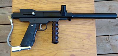

                        In honour of this liquid co2 related thread, I wanted to show off one of the guns I used this weekend at Wasaga Frosty’s big game. I figured with some name like Frosty’s , I had better not show up with anything less a co2 cloud spewing beast!
                        This gallery has 3 photos.
                        • Meleager7
                          Meleager7 commented
                          Fantastic! That was my first time playing with a montneel , man , it’s a surprisingly fast little gun! The gun was really consistent at the chrony too. I just wished I had more co2 , I only had a 12oz siphon tank that Jordan whipped up for me, and I went through it pretty quick
