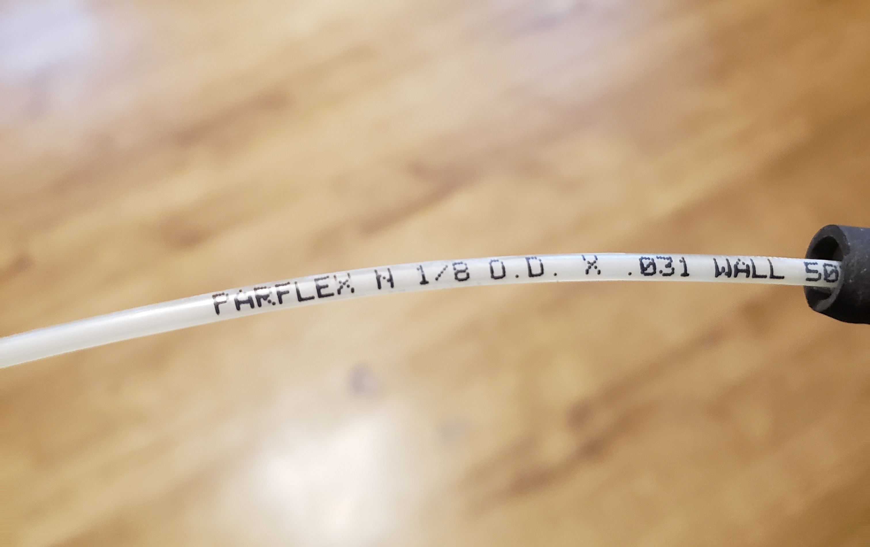

                  #24
                  I grabbed a pic of the hose last time I built a siphon setup for Meleager7.... the compression fittings should be easy enough to find either online or at a hardware store.
