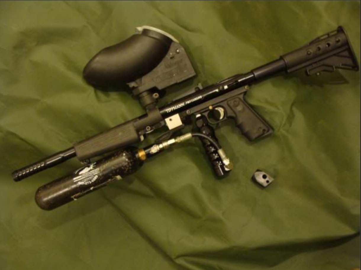

    Came across this pic on Google when looking for info on my Pro Carbine. Really like the set-up and would like to know more about it.
    Looks like the pic was from the old Mcarter before the hack.
    Does anybody know the owner of this or what im looking at?
    thanks!

    I did not build this one particular Carbine, but I have built many with this configuration. What do you want to know?

      Well, I've been contemplating doing a spring-feed like Chappy has on his Pro Carbine, and running a small 13/3000 or a Ninja 22/3000 tank. I think that would fit nicely. That tank there looks like an old CO2 tank, but I could be wrong.
      Obviously that one has some kind of expansion chamber. But that one looks to be running directly under the valve inlet. Usually the chambers are set further forward (at least thats what I've typically seen on the pro carbines).
      And I've never seen a stock added to the Pro Carbine before. I've seen them on 98's and A5's, but not on the pro carbine platform.
      I assume sourcing parts for a similar build would be somewhat of a pain now-a-days.
      • BlindFaith429
        BlindFaith429 commented
        Looks like a quick Google search turned up the stock. Its an Allen Paintball "Hittmann" stock. Guess I'll be giving them a call tomorrow to order one.

      I have a similar stock. They are cool, but not practical.
