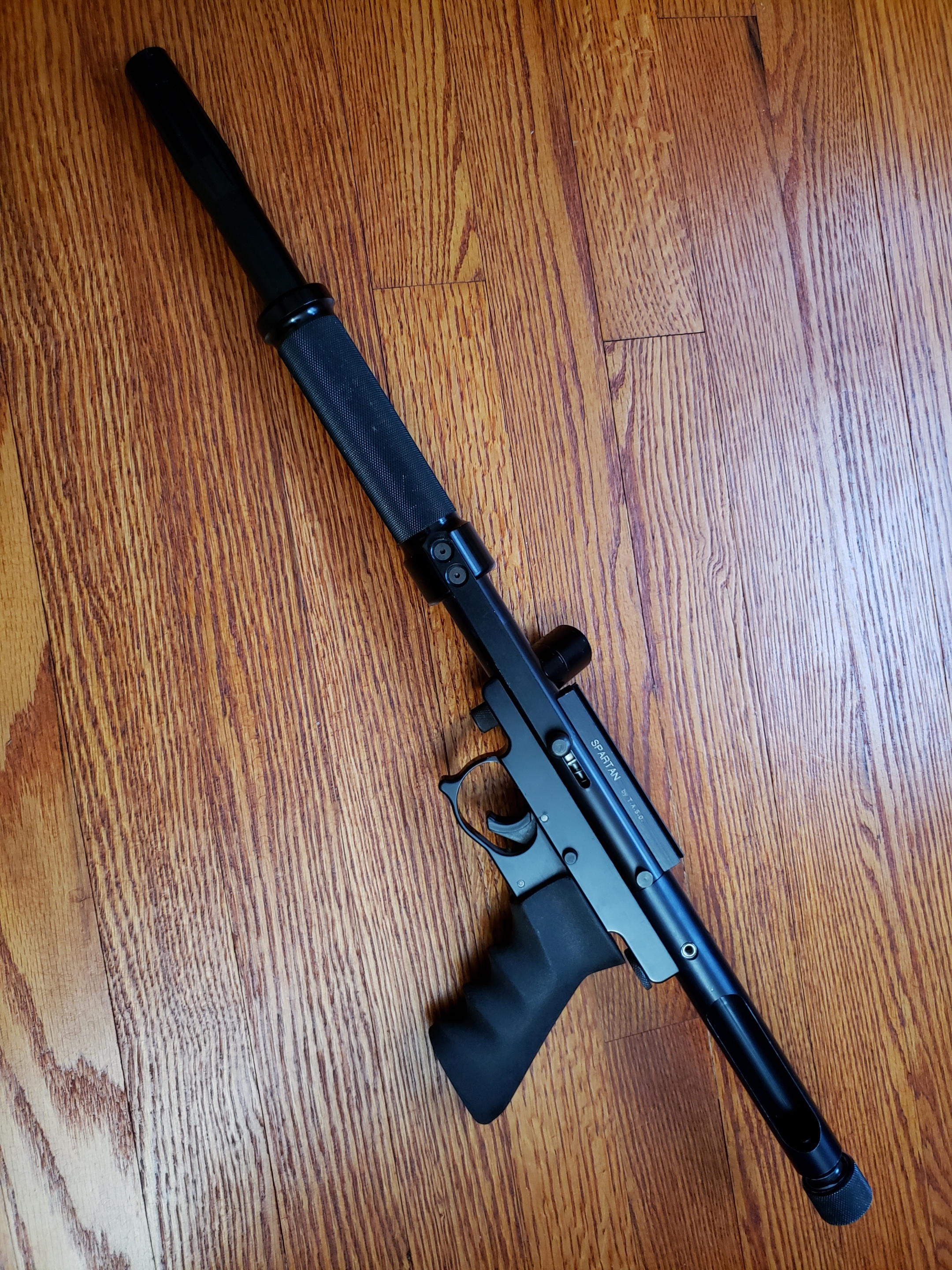

    Picked up this Taso Spartan off the BST. Need to figure out a way to feed this booger.

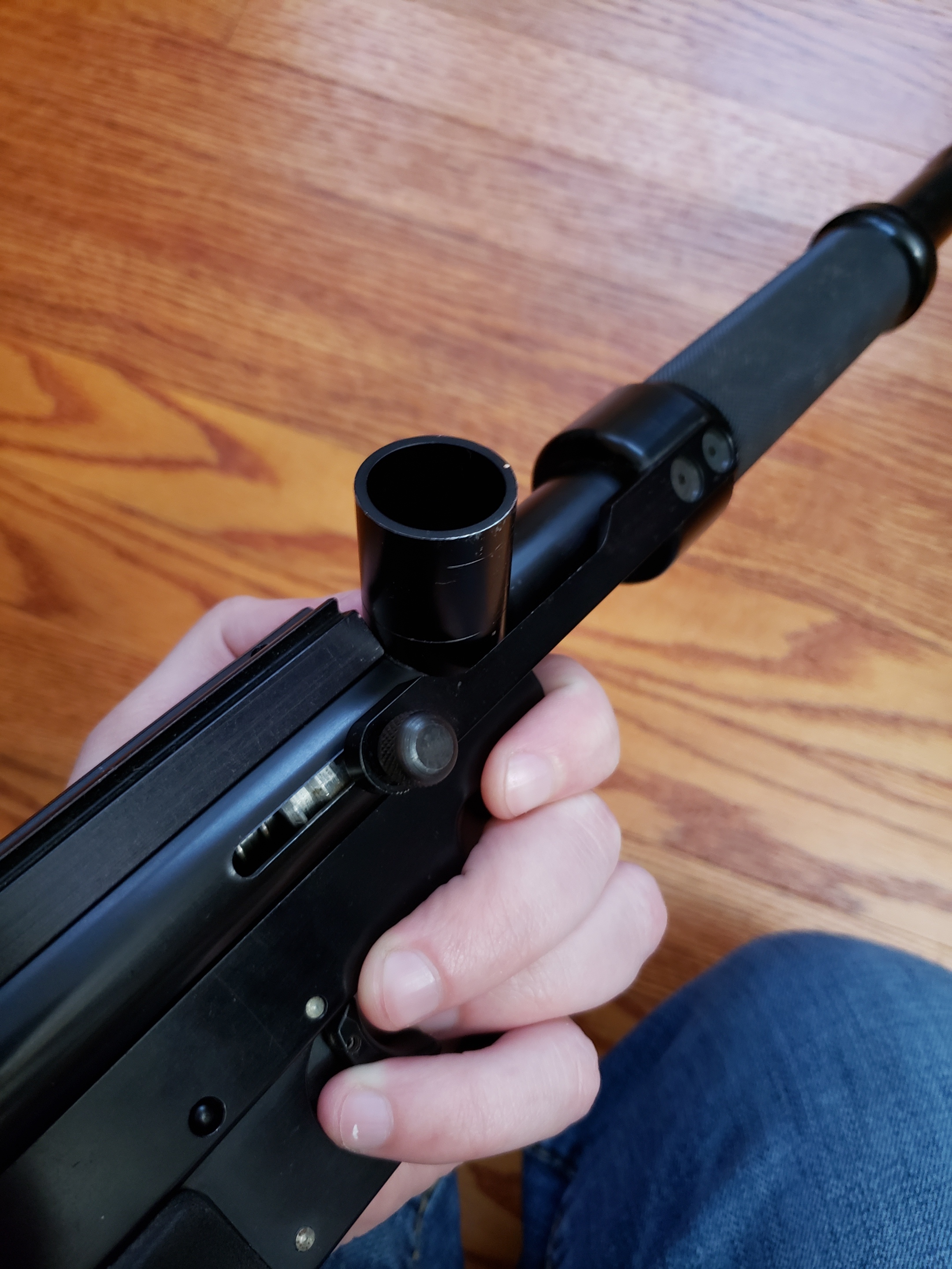

    The feedneck measures .995 OD and .840 ID I tried to use one of the elbows from my right-feed AC, but those obviously won't fit due to them being made for 7/8" feednecks.
    So what are my options here? A stick-feed from Paintball DNA, or a 1" elbow and a small hopper?
    I dont have any 10-round tubes at the moment, so I dont know if those would just jam into the feedneck and stay put.
    My local PB shop has some of the small Tippmann hoppers for like $10 or $11, which would probably work nicely due to the reduced size.

    You need a elbow like this

      I have elbows like that, but all mine are 7/8" one side, 1" other side. I'd need a 1" on both sides.
      Thats what I was referring to when I said I would need a 1" elbow and a small hopper.

        If you draw a line parallel to the barrel, from the front of the bottom of the grip (where the female ASA would be) to the tip of the barrel, I have about 17-1/2". Thats with the 12" barrel thats on it now.
        The 22 Ninja sounds like it would still be shorter than the front of the barrel, though a 17 or 13 would obviously be a little better in terms of meat hanging out the front like that.

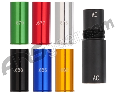

        As for the barrel, I'm considering 3 options.
        1. Get a standard barrel and have it freak bored
        2. Buy a freak 2-piece barrel (this was re-threaded for AC threads)
        3. Find a small bore barrel and just leave it.
        I dont think this gun has a detent as far as I can tell, so i think I'm going to have to constantly underbore to prevent roll-outs.

              Oh, other thing I was considering, was the "Warrior" barrel kit. Probably not as good as a full Freak kit, but it would probably do just what I need for $40.
                Will that font in the handle? Is it less then 1” around?

                For these being knock off tech t/python insert kits they work pretty damn great

              Just measured the front and back of the forend, both measure 1.015.
              I just picked up one of the Ifit Kits off the BST, seller said it measures 1" OD, so it should fit.
              Think im gonna pick up one of the Paintball DNA Stick Feeds for this, just to give it a shot.
                That’s should work well.

              Back in the day, there were two sizes for elbows. I'm assuming that most of the larger elbows were for pumps. Anyways, I bought a BE 45 round hopper and it came with a 1" elbow that I could only use on my vulcan paintball gun.
              They did make those 1" elbows and if you search around you can probably find them.

                PTP had elbows that have a split bushing in one end; leave the bushing out and it's 1".

                  Thanks for the heads up, but this one was re-threaded for AC barrels. The Ifit kit i got is for AC threads.
                  Will be able to tailor the bore to prevent roll-outs
