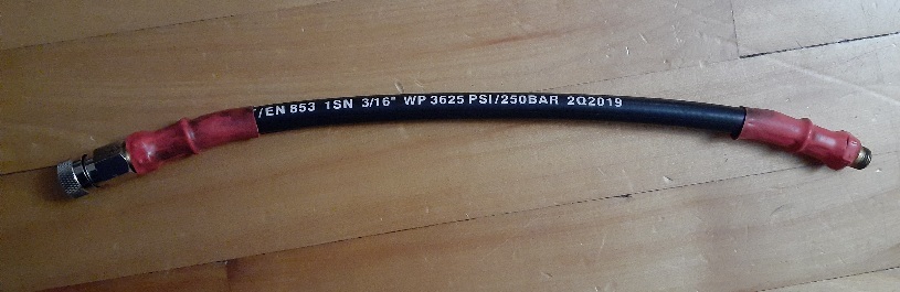

    I bough two mag recently and the previous owner used hydraulic tube between the ASA and the reg.
    I see they can sustain lot of pressure but are they any good with air?

    Yup, they will work fine if they have NPT fittings on the ends and you use some form of sealant. We used to go to hydraulic shops all the time to make up "air" lines for us in the late 80s and early 90s until paintball specific sources became prevalent.

      Also used those for scuba ... was able to get custom length hoses this way ...

            Looks like a grease gun hose to me, which work fine for PB purposes.

              I was told years ago that in order to use hydraulic hose in place of pneumatic hose, you need to triple the pressure rating. I don’t know why that is and I can’t back it up. And most of the hydraulic hose is rated 3000 plus so even if true this stuff is fine for most pb use. But I’ve always wondered if there’s anything to it, anyone know?
                Alexndl commented
                I would imagine its related to operating pressure and burst pressure.
                Its a good rule to operate 3 time lower than the bursting pressure to allow for pressure fluctuation/surge

              Only thing you have to "worry" about is moisture. So the potential of corrosion/rust. Most lines are either rubber reinforced with something else or stainless.
                My understanding is that they fail differently, and have different testing standards, so the numbers are not directly comparable. I've read that the pressure rating is fine, but hydraulic lines are not rated to handle carbonic acid, or thermocycle shocks associated with co2.

                  Hmm, I'm using hydraulic fittings for a home fill station. You think it's safe or nah?

                    Pressure is pressure ... but the hydraulic hoses might not resist "well" to moisture for extended period of time.
                    I would not worry about it for 2 reasons: 1) compressor do not spit out as much water as they used to 2) the contact time (under pressure) is extremely low for us, those things are design for 24/7 full operating pressure and we are nowhere near it.
                    Also, a 3.6kips hose will likely have a burst above 5kips (i would bet closer to 10kips) so the CO2 (1kips on hot day) and thermal issue will not cause any problem ...
                    This issue of pressure becomes a really problem with higher diameter stuff, but 1/8" and 1/4" is never going to be a problem with compressed air and CO2 (all inert gases).
                    Just don't put oxygen (or combustible gases) in there ...
                    There is a lot of "rules" and "rumors" about pressure system around because people don't understand what is OK/safe and wheat is not. So the neighborhood idiot blew himself doing something dumb and now everyone is freaking out ... same things with oil in the tanks, it never been an issue with air or inert gases .. but the neighborhood idiot filled with oxygen and blew his garage so people are saying no oil ...
                    Bottom line: anything rated at or above the tank pressure is perfectly fine for paintball.
