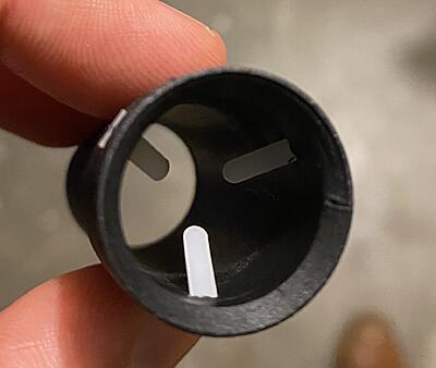

      I've done nail polish wedgits in a Freak insert, worked for the time I used it.
      Spider! had a neat rig he made to press wedgits in - maybe he can post a picture of it again.

          Carter style printed insert with Mylar finger wedgits.
