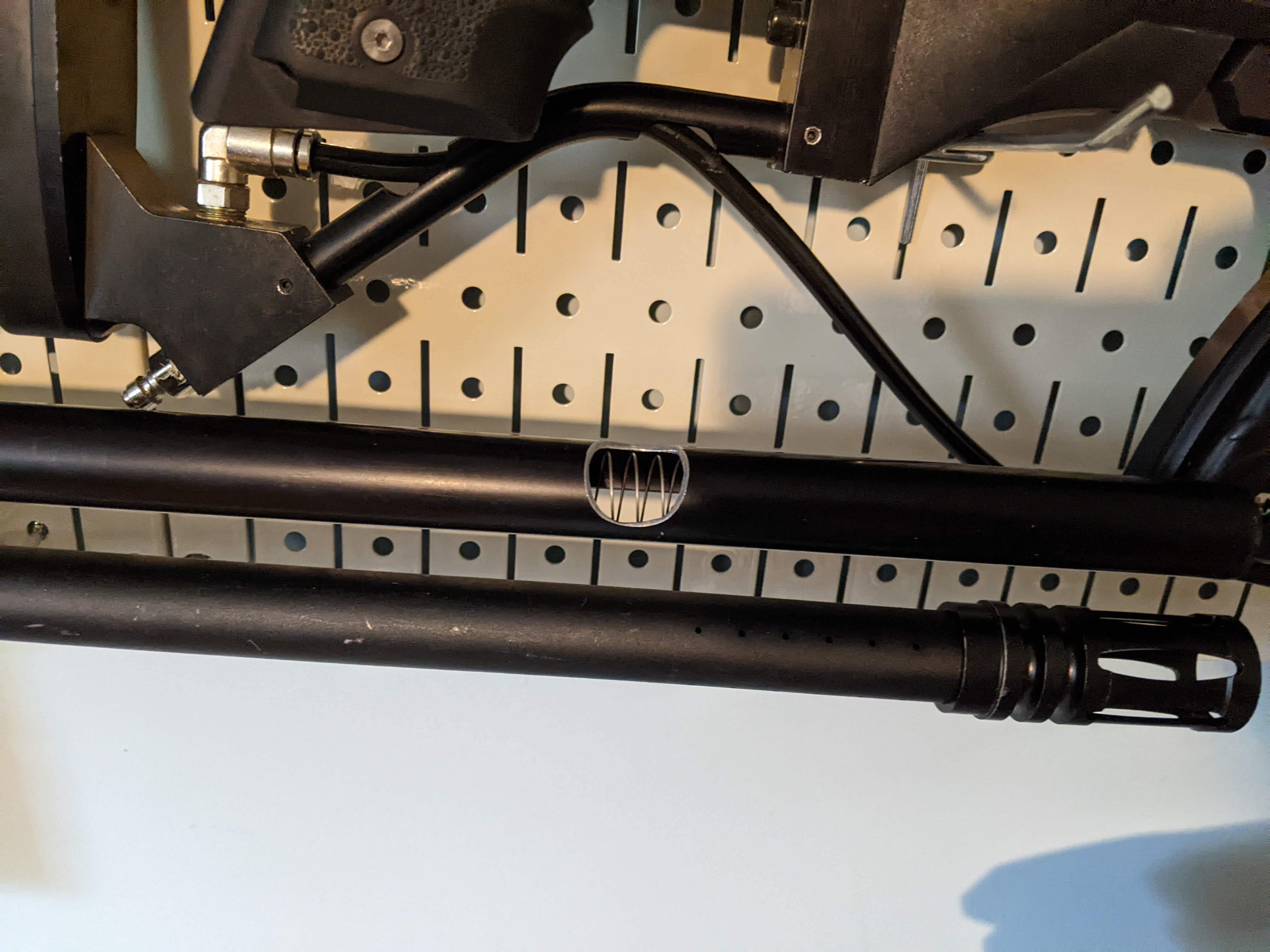

      I was not a fan of having to swap out magazines on the field. I prefer to be able to refill on the field. Luckily I found someone selling a magazine that has a hole drilled in it so I can refil it with 10rd tube.

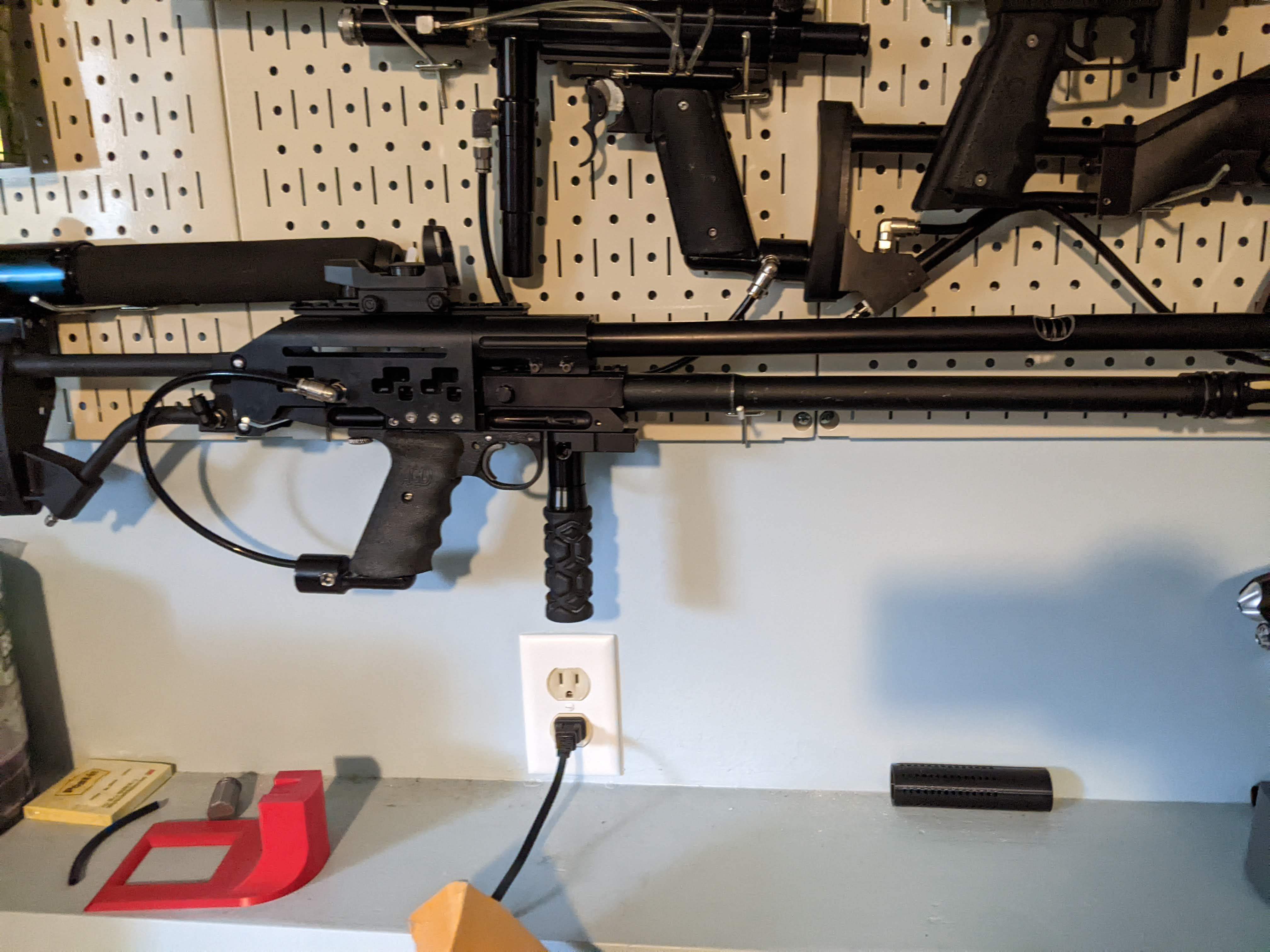

      Complete personal preference but I swapped the intelli frame out for a single trigger and the xvalve for a classic vale. Makes it feel so much more like a sniper gun to me.

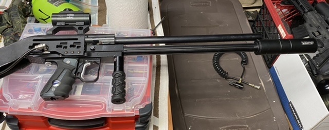

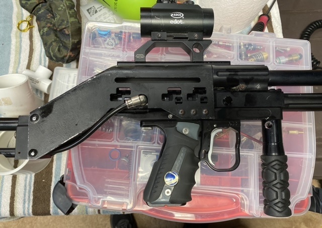

          She’s a beast! Air up and shot without an issue. Brought at SHP tank to test. Show it’s age and use but in good condition. Follower is smooth in the mag and includes a second mag.
          Barrel is an Armotech with a suppressor.

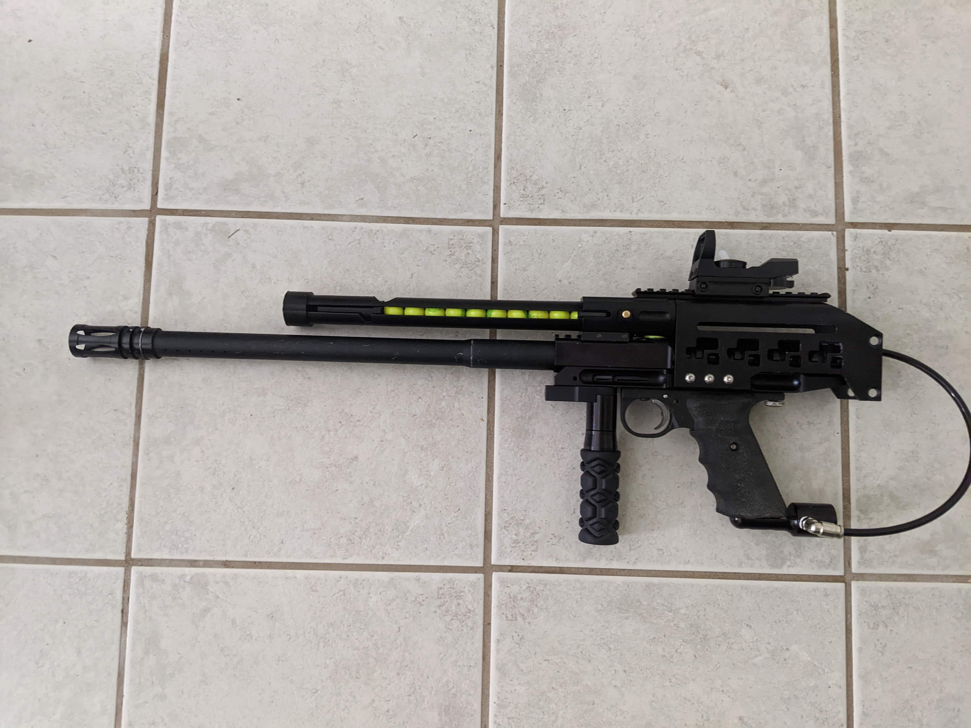

                The mags seems really simple, but no one makes them anymore and they are super hard to find. They seem to go for about $150 each. Before I found my reloadable one I made a 3d printed 15rd reloadable one. Worked great. So if you spot extra mags, it is a good idea to snag them!

                  Looking forward to shooting some paint. My arms a little short, so I might end up taking the stock off the back like yours.

                  Yeah, I have never been a fan of remote lines. I am already too big and gaumie to worry about catching branches and bunkers with a remote line, so I just run a back bottle.
