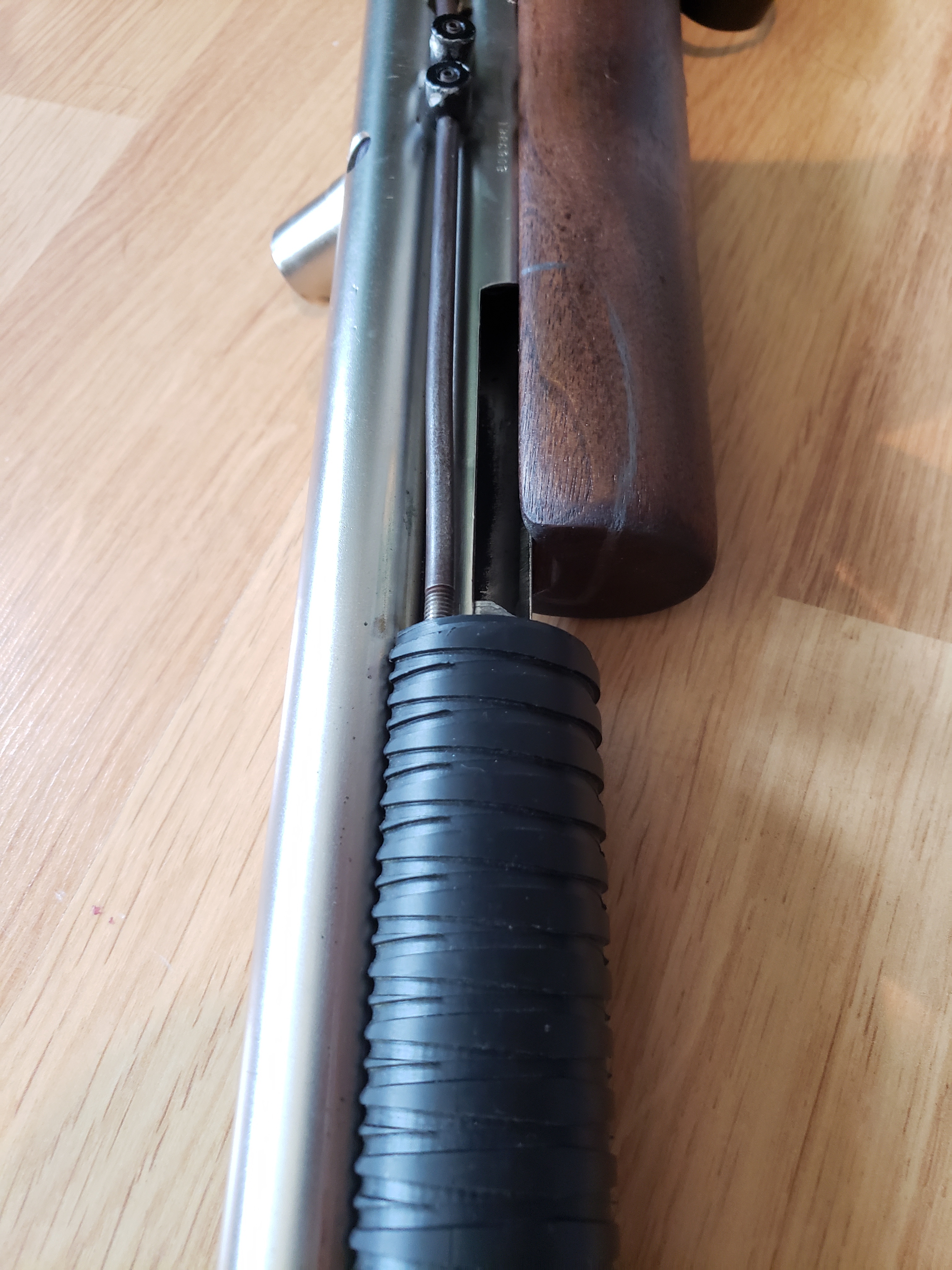

    Hey MCB! Another post looking for some guidance. I have a Palmerized KP with a side dropout for a quicksilver changer that I am dropping into a stock and getting back to the rifle fun! I was wondering if anyone had experience with this and what the best shape would be. Here are some photos of what I am working with and my idea penciled in.
    Click image for larger version  Name:	20220506_165448.jpg Views:	0 Size:	3.65 MB ID:	268652 Click image for larger version  Name:	20220506_165452.jpg Views:	0 Size:	3.11 MB ID:	268653 Click image for larger version  Name:	20220506_165506.jpg Views:	0 Size:	2.84 MB ID:	268654 Click image for larger version  Name:	20220506_165459.jpg Views:	0 Size:	2.34 MB ID:	268655

    I'm partial to my solution:
    I cut a relief into the stock to allow the 12gram to drop down and out. It retains the appearance of a full length stock.
    • WALZ
      WALZ commented
      I like this method,, clean and simple...
    • Loophole
      Loophole commented
      This looks great! Maybe that is the route to go.
    • 3414
    I was gonna suggest Jordan's method, but offset a hair to its a side out deal.
    • Loophole
      Loophole commented
      I'll have to get some better photos of the dropout cutout tomorrow. It will have to be at least somewhat offset. The question is how much! I guess I will have to start slow and ease into it by hand.

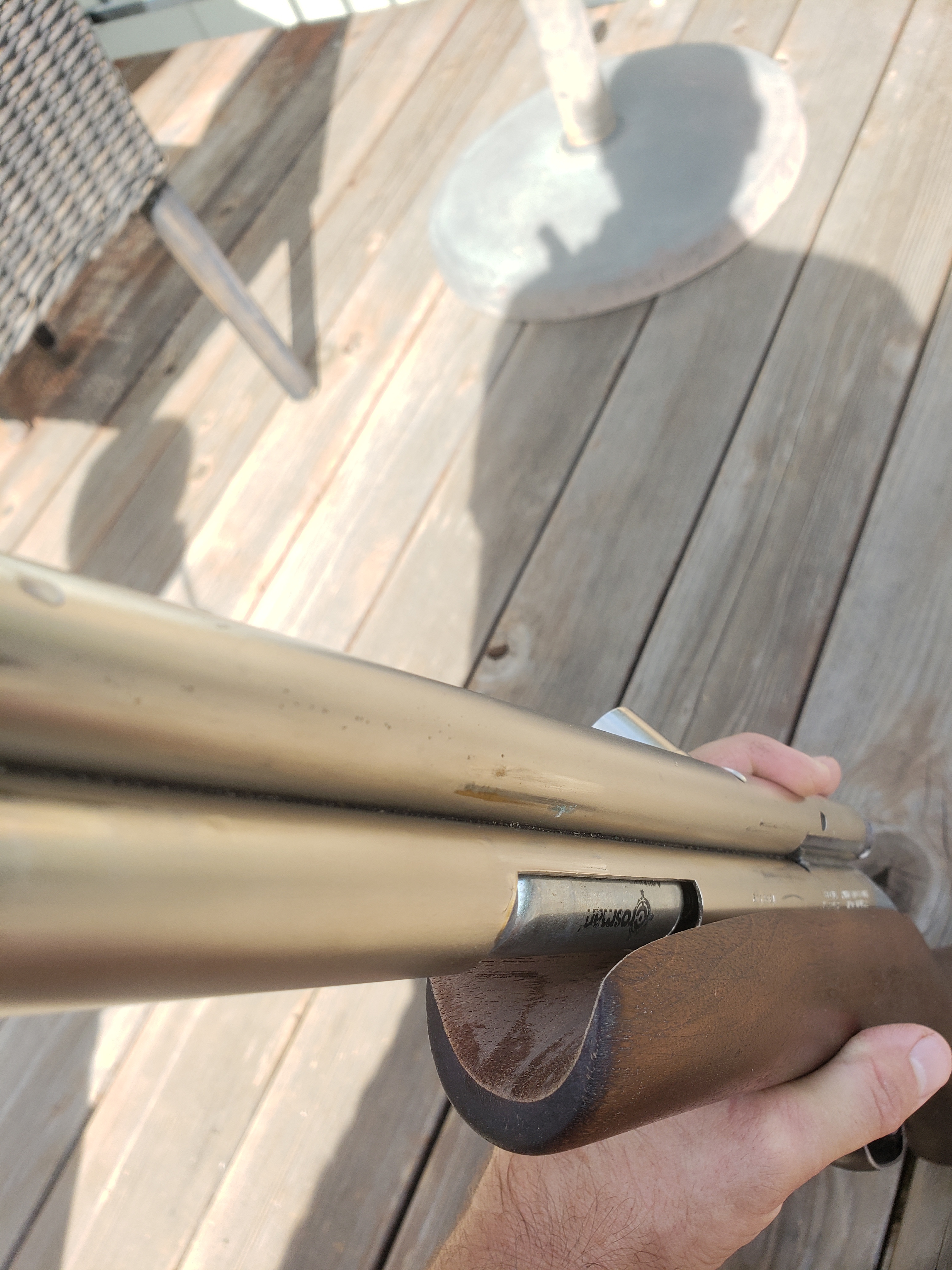

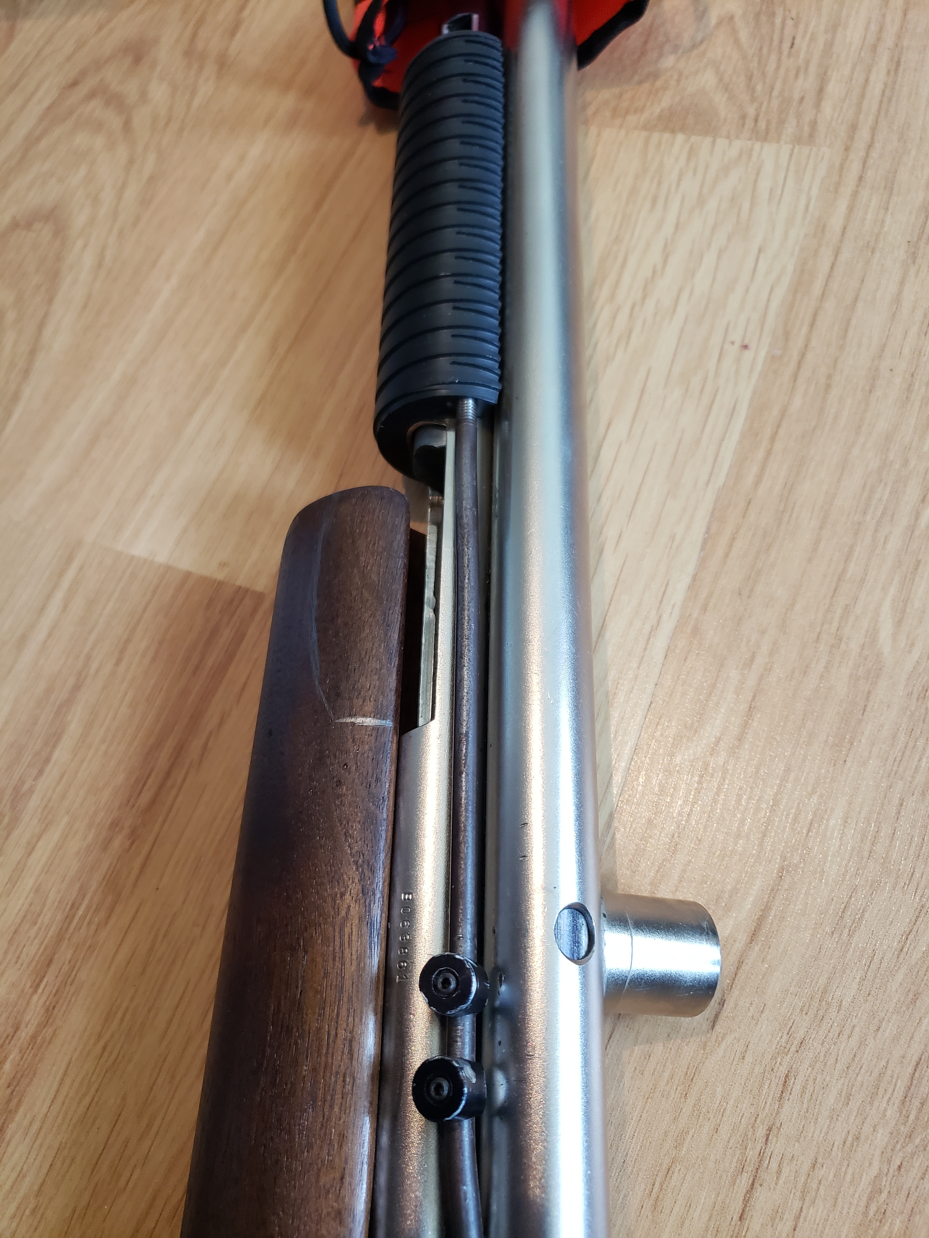

    Thank you guys for your guidance! I appreciate you all. I ended up having to slightly offset it and went pretty steep with the cutout. I don't have many tools so this initially started out with a little wood handsaw and the rest of the material was moved with 80grit sandpaper wrapped around a 12 gram. Finished it off with 120 220 320 400. Now it's just time to re-stain.
    Here it is !

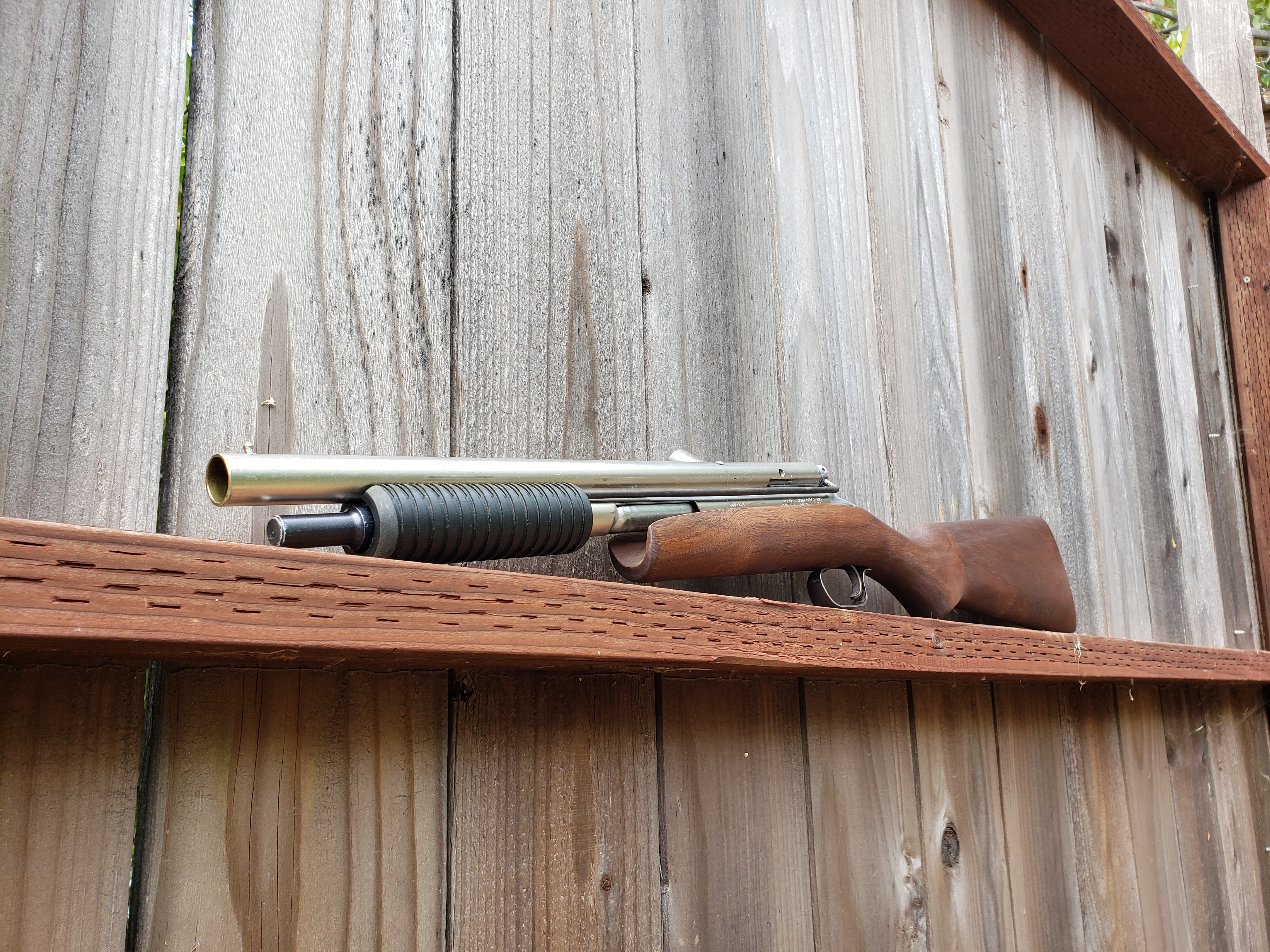

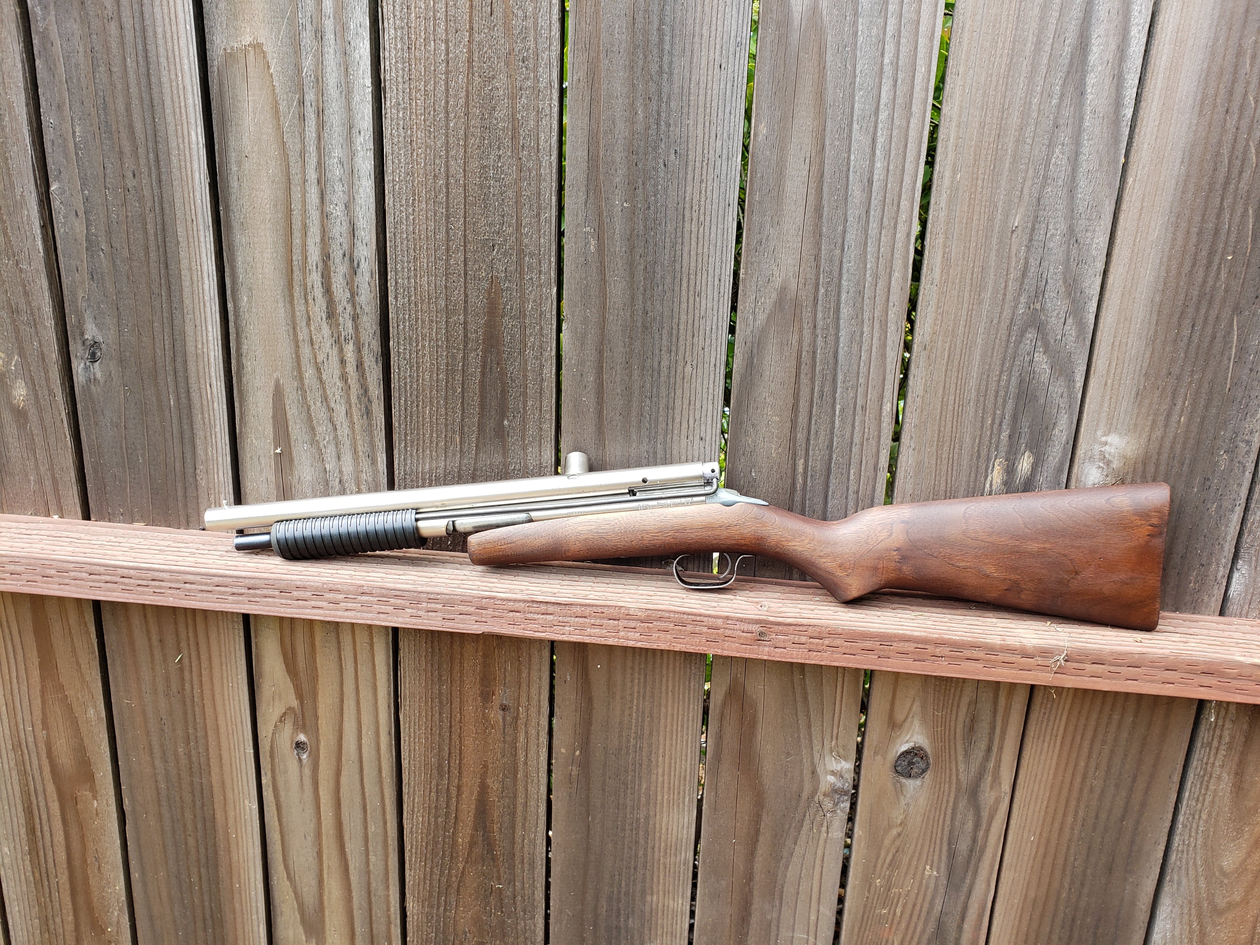

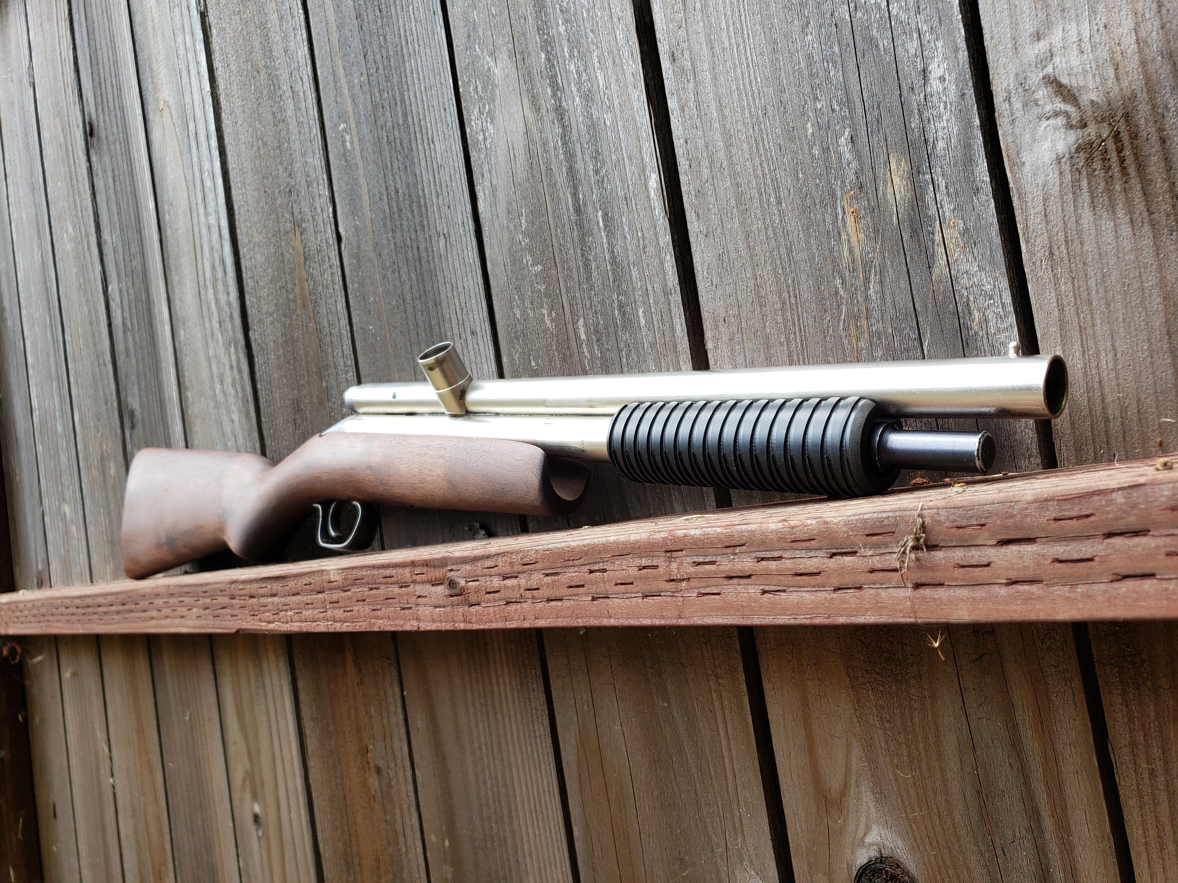

    Here she is, all ready to go!
    Thanks again everyone for your help!
    -Joran
    -Brickhaus
    -Walz
