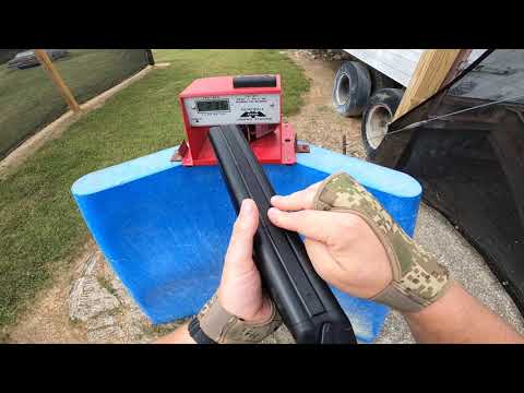

                    https://youtu.be/AyK0rv6lUiI
                    TLDW - It seems like the left barrel tends to shoot hot without a second ball in the barrel... Interesting.
                      Thanks, that's awesome!
                      This makes my idea more realistic ... I contacted Clipard for the valve I need and it doesn't exist ... But I found a solution (less elegant).
