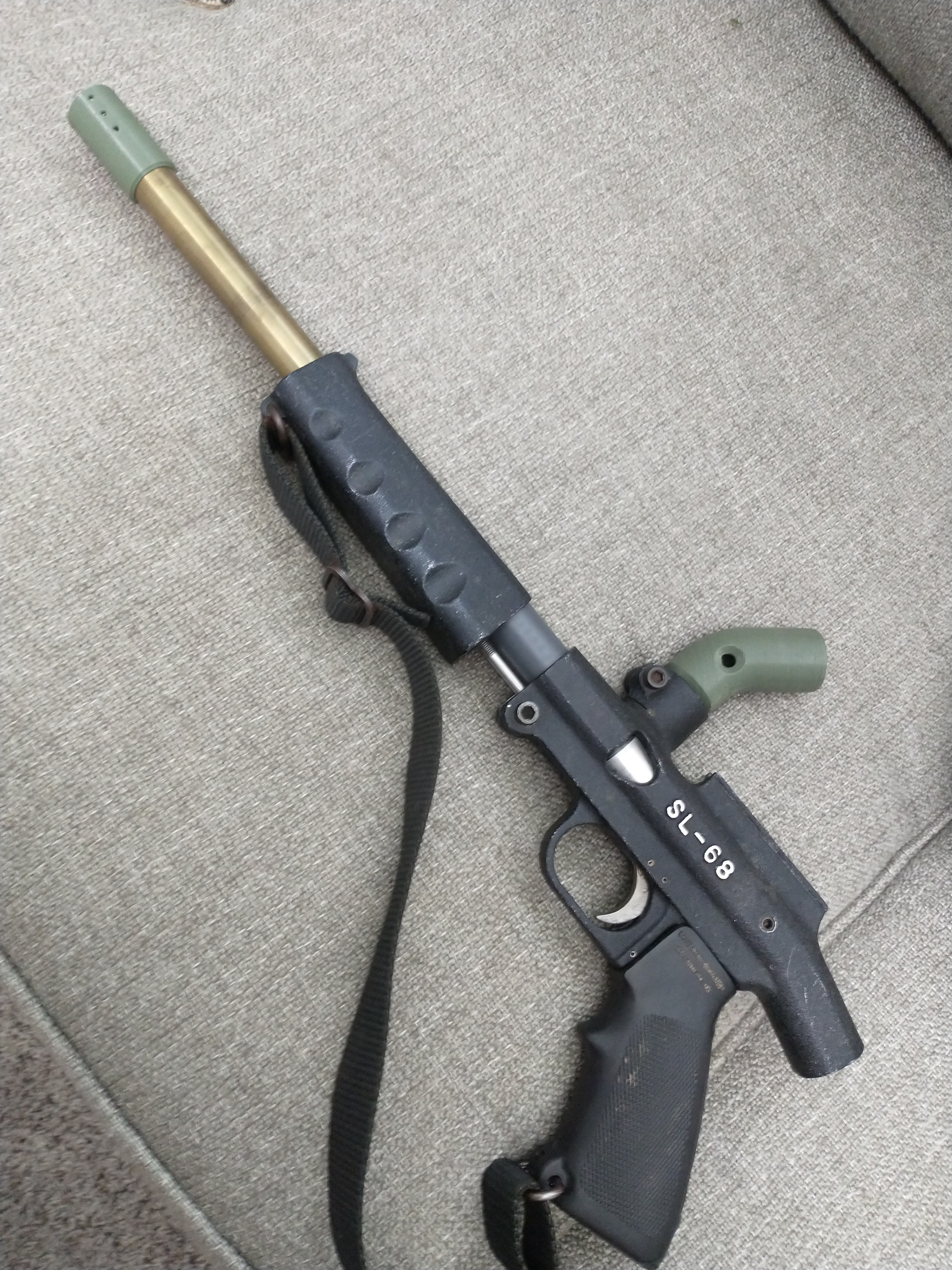

          I made a barrel from 686 brass and was going to put a palmers wedgit style detent in it, but I realized that I wasn't sure where to put it. I need to play with some fingernail polish first I guess. I might try just locating it by rod down the barrel.
          The brass tubing is layered over with some sprinkler tube and turned down for proper thickness. Makes a good pump stroke.
          Click image for larger version  Name:	IMG_20220522_143231490~3.jpg Views:	0 Size:	3.68 MB ID:	275654
          • Drcemento
            Drcemento commented
            5/8" from the end of the barrel works perfectly.
