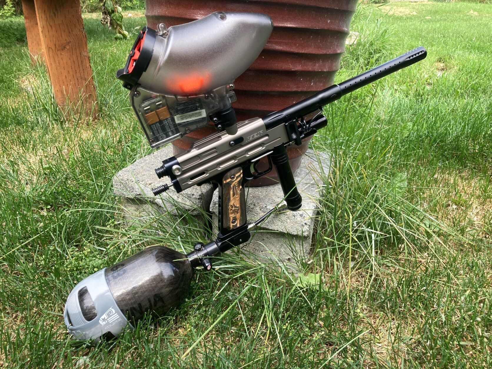

    • gabe
      Thirst Trappin
      • 1079
      Finally took some time and pulled my whole gun apart, lubed everything, checked it all out and swapped the springs. The valve spring was a mysterious straight sided spring that was very soft. I swapped the Meteor cone valve spring in its place. The meteor one is slightly stiffer but also slightly longer. I had the original hammer spring in which I think must have been a CCM because it had a CCM hammer. It currently has a Meteor hammer that I swapped in. Shot in the back yard (just eyeball chrono) and wasn't getting more than 250fps with 4.5 turns in on the IVG. I went back and swapped in a Maddmann green spring and now it's shooting up to velocity. I still haven't sweespotted it but it's doing an estimated 280 and my sidewinder hpr is maybe 1/32" of an inch from flush so an estimated 375-400 psi.
      The shot feel is snappy but the whole gun feels snappy. I love the meteor slider frame, it's so precise and with their rounded hammer lug it has an insanely light smooth pull. The trigger is pretty much not able to be short stroked the way I have it timed. I suspect I will fall in love with this gun now that its running.

        • gabe
          Thirst Trappin
          • 1079
          Glad you got it shooting now you just got to fine tune her. Post some pictures! I love my Meteor.
          Played with timing and sear springs and it's perfection now. The trigger has a crispy 3mm pull at a perfect weight.
            Nice setup! Love the UL revvy combo. Smoked revvy looks good.
          • gabe
            gabe commented
            Thanks! The meteors always looked to me like a retro-mod sort of build sort of like a modernized STO so the dye barrel and revvy just look right.
