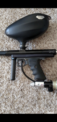

    Considering putting a single trigger mag frame on my Longbow. I know people really like the standard single finger mag frames, but being spoiled by metal cocker frames I would prefer a metal frame.
    Are there any good options around? Are there any modifications/tuning necessary when changing mag frames or is it essentially plug and play like a cocker (ignoring possible 3-way hose change)?

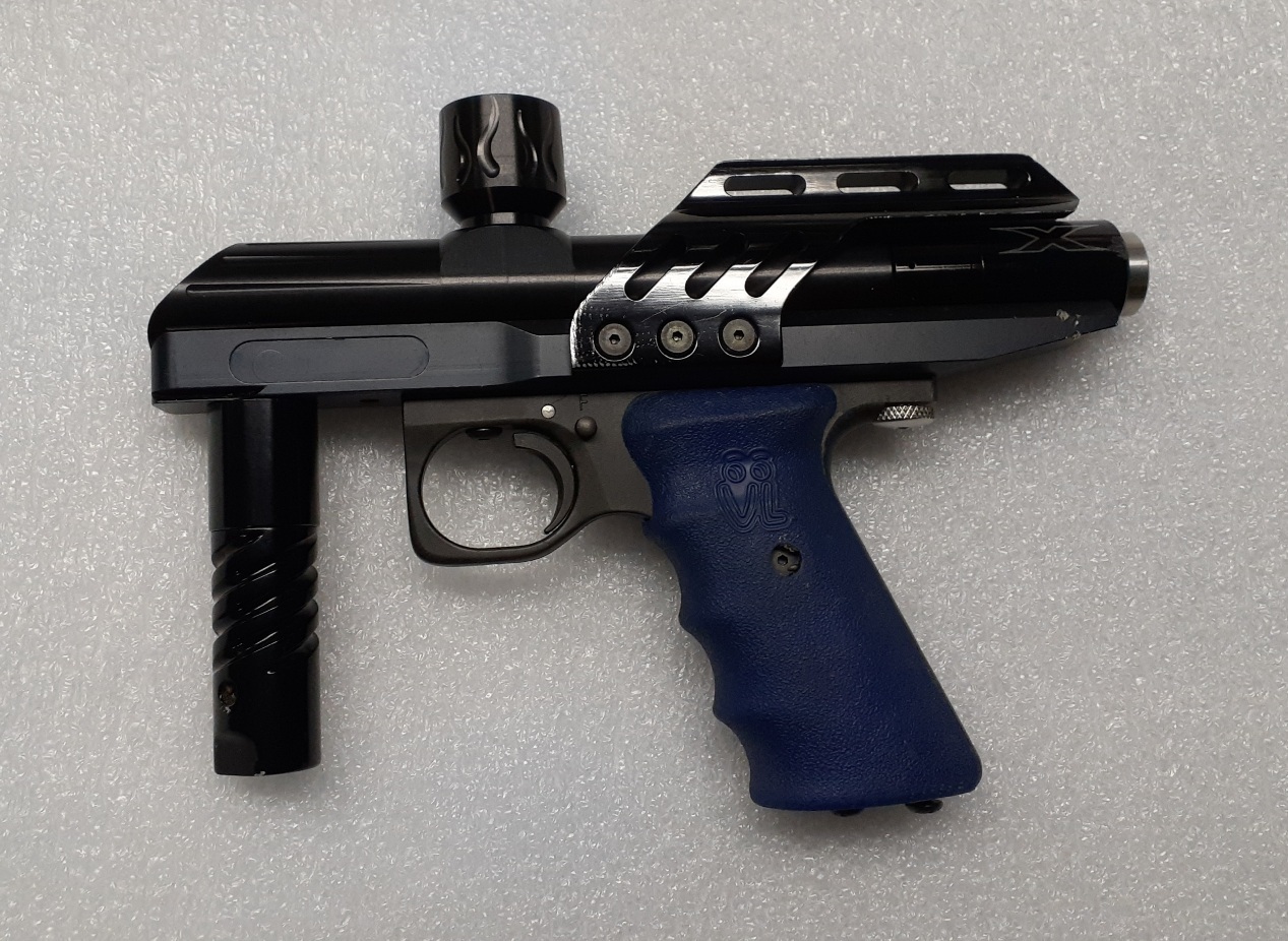

              Your tac one have a RT rail so yes you need a flat top frame
              Here is what a CF frame look on mine, color does not match perfect the ano but they are comfy. I prefer the AGD rubber grip over the VL68 rubber grip.
