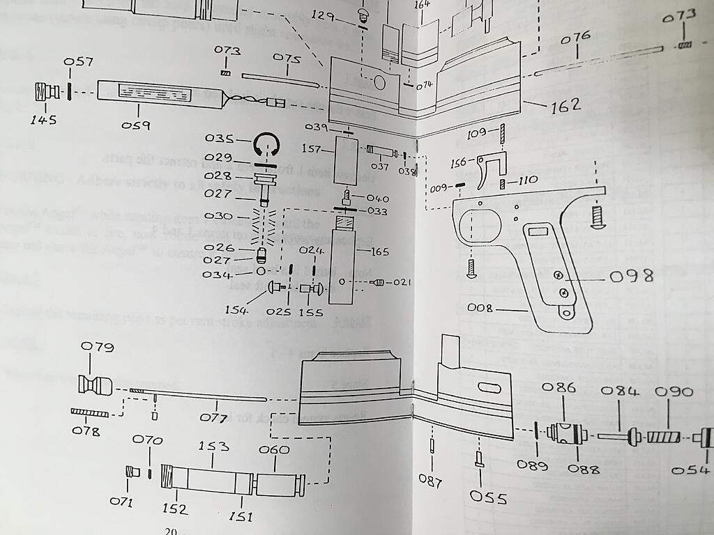

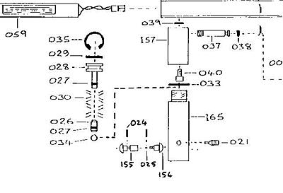

    Yes they are rebuildable. I have a diagram somewhere on the computer. I'll see if I can dig it up for you.

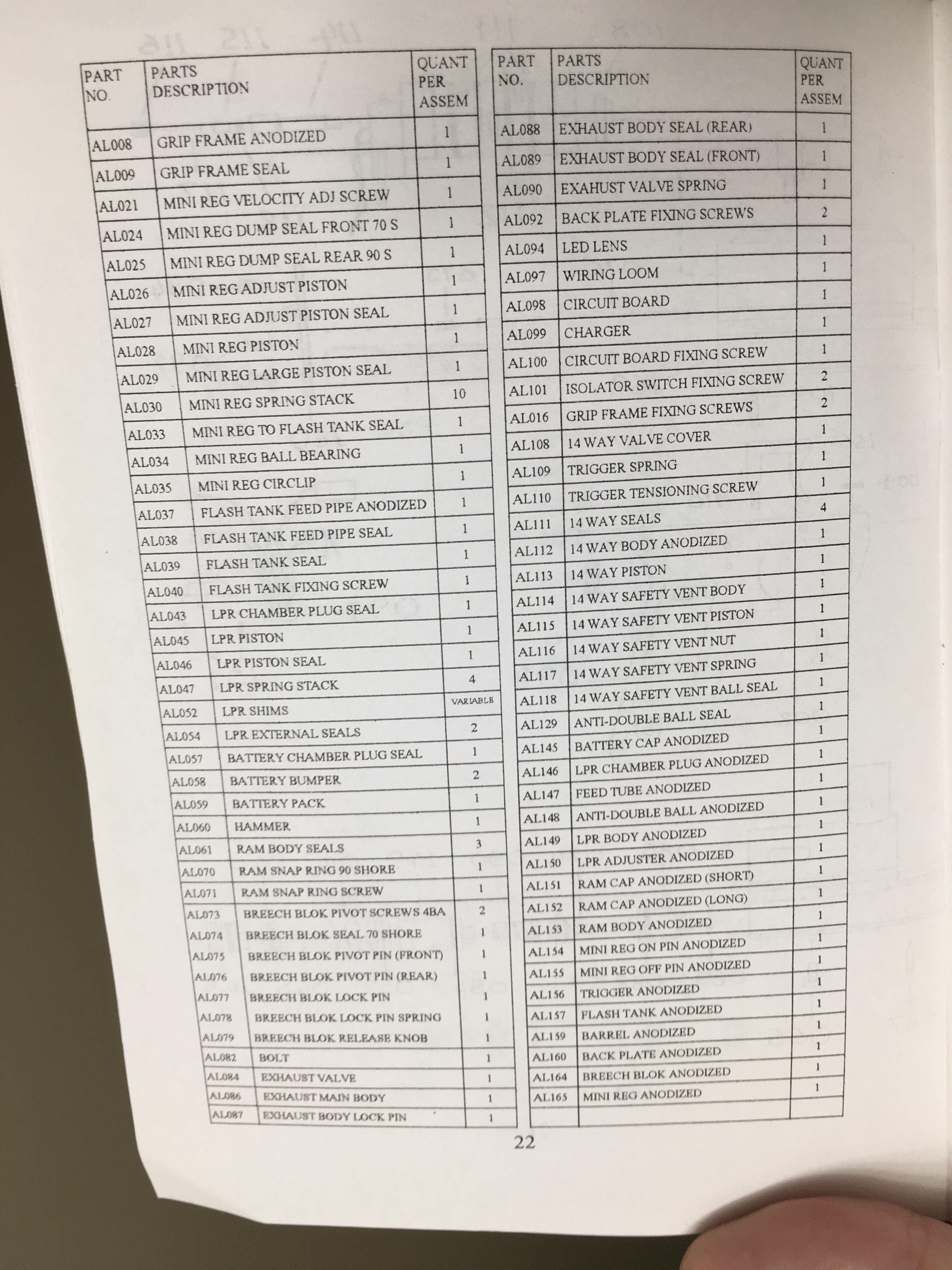

        027 should be a 006 70d
        029 should be a 012 70d
        024 is a 70d but not sure of size
        025 is a 90d but not sure of size
        Sorry don’t have all the details.

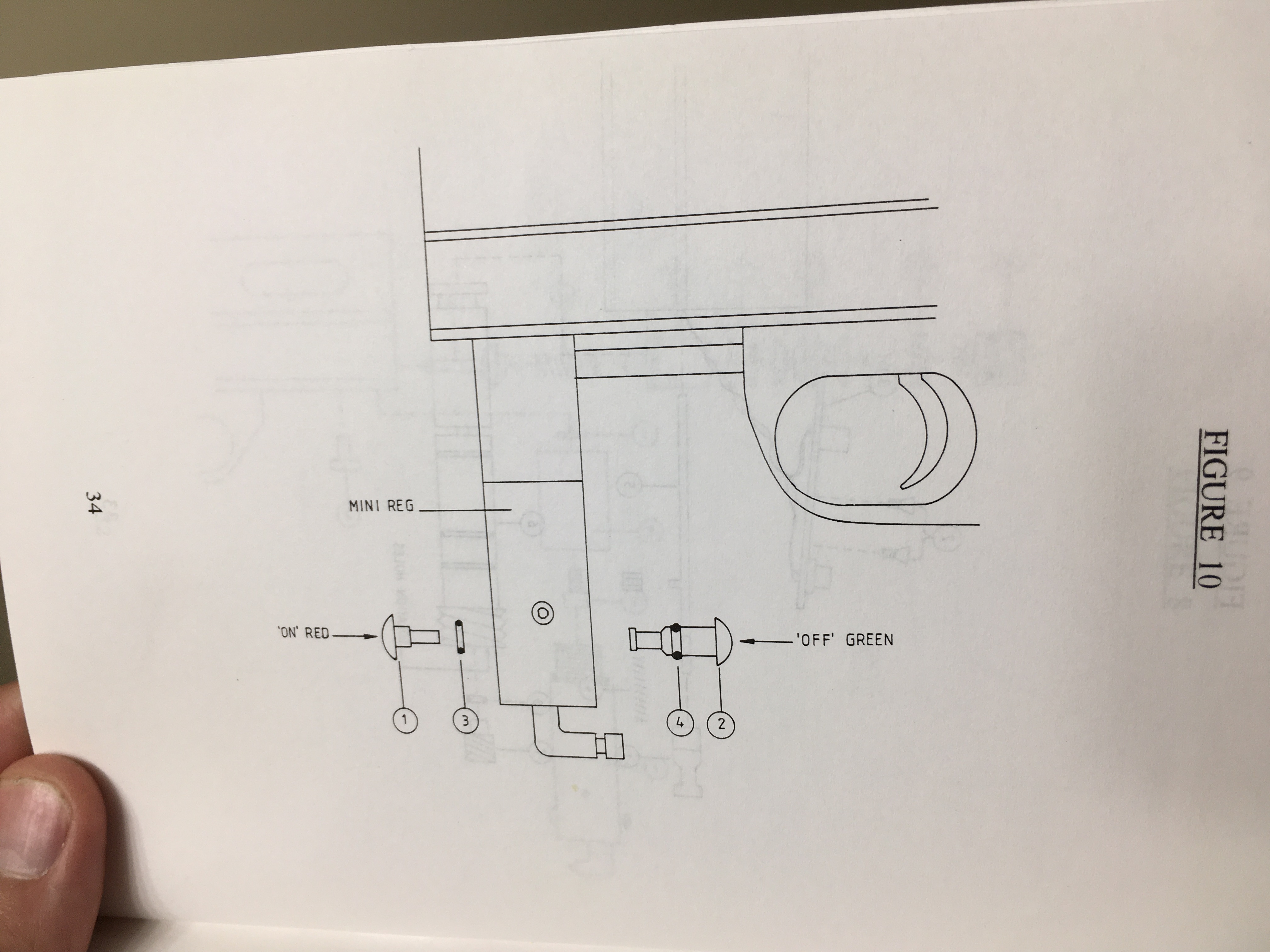

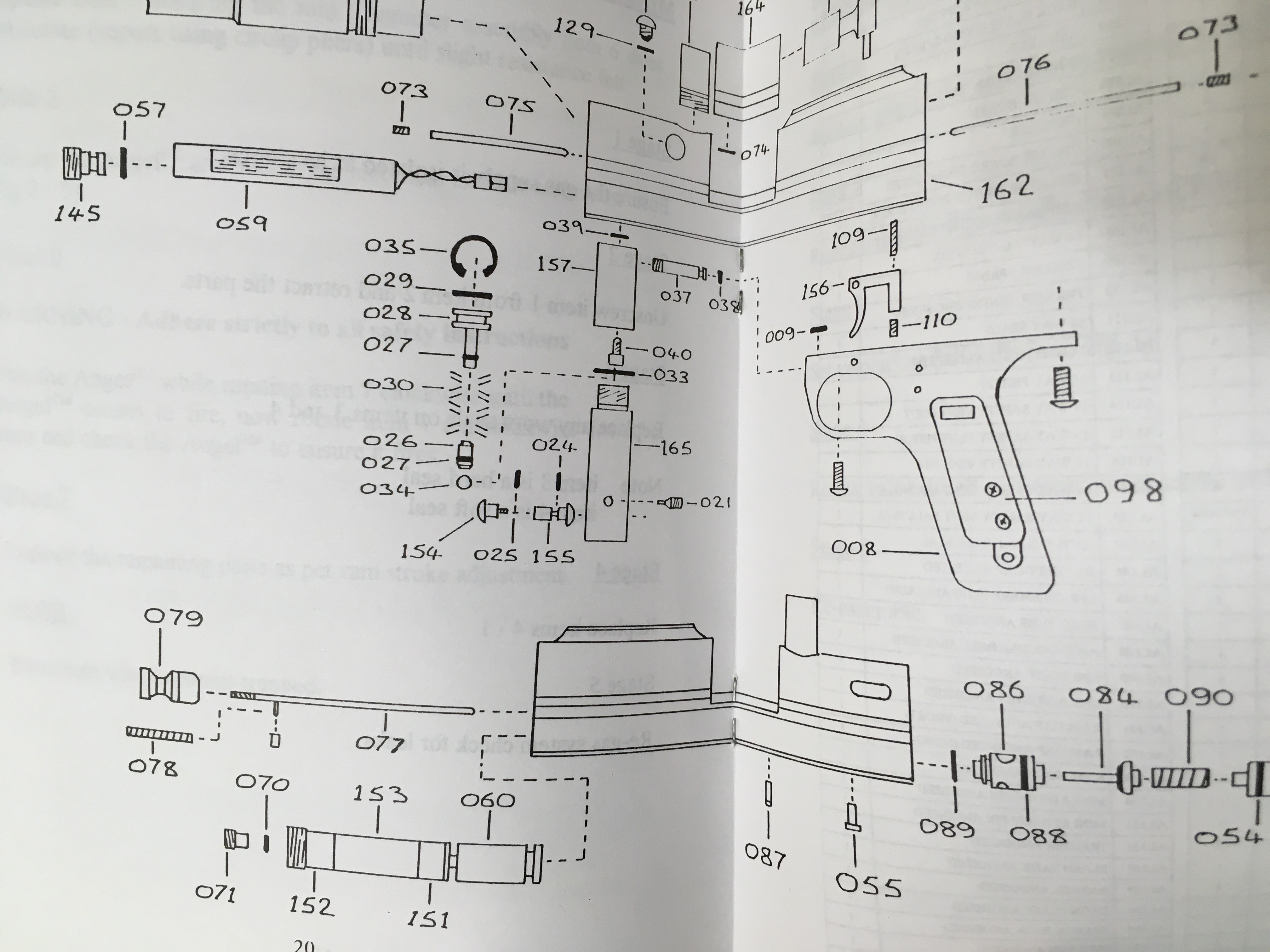

            Here are some pics straight from the owners manual.
