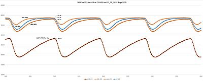

    Performance at 10.5 they’re all pretty darn close. I have a 30 bps compare somewhere or I can redo it.

      What are we looking at? Can’t see the axis labels. I’m guessing y is psi and x is time? can you do a test at 200psi? Is the volume of air the same for each regulator?

      Roger7pball commented
      Y-axis psi, x-axis samples. I could do 200 psi. The volume of air expelled per shot is the same for all regulators as they were tested back to back on the same marker with the same settings. The air volume internal to each regulator won’t be the same as they are different designs with different dimensions.

      latches109 commented
      200psi would be helpful.
      And a test @ 15bps mini pre-2k eblade autococker. test over chrono. I would like to see a dump chamber too small where the reg needs to keep up as the rof increases and pressure drops.
