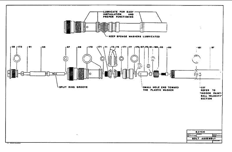

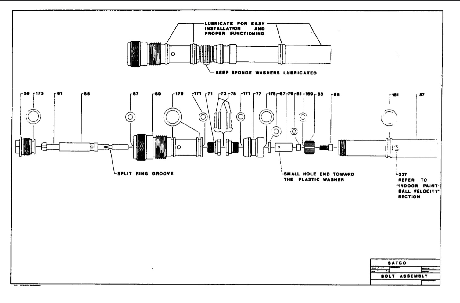

            Good grief, that bolt assembly is nuts!

              I still don't understand how this thing actually functions but it is still pretty cool
              Also, 249 individual listed parts, that's not counting duplicates. holy moly batman

                  -The bolt is basically a ram, blowback hammer, poppet valve and spool, all in one.
                  It's held back by a mechanical sear, that when pulled, lets the head of the bolt fly forward. That lets air from the back of the bolt blow through- like a spooler- once it's fully forward.
                  AS the bolt is moving forward, the hammer/sear portion trips the... "sub sear" for want of a better word, which activates a small valve that vents enough air to blow the bolt back.
                  The inside of the bolt has an air bleed that's cut off when the bolt is moving, and a sort of poppet valve that releases at the front of the travel.
                  Sort of, going by my faint memory.
                  I remember working it out back when I had HB's sample- it's easier when you can see the mechanism in person- but I'm sure I'm forgetting something.
