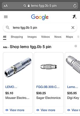

                          I have this Lemo connector saved from when I was going to mess with Raceguns, but can’t remember if that’s the one.
                          • Poppets 4 Life
                            • 107
                            So if you want an official lemo connector. They usually cost 40-60. Which obviously makes making cables to expensive. Luckily our good buddies over in China " πŸ™„". Decided to clone it like they do with everything.
                            The size used in race guns are 0B FGG EGG 304. You can pick them up as cheap as $15 or so shipped on eBay. But shipping times can be brutal.
                            https://www.ebay.com/itm/17198871963...mis&media=COPY
